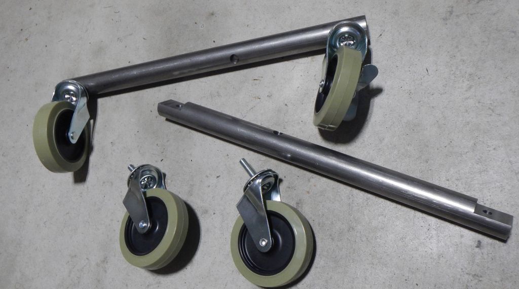

Here's the ones my brother bought for his 7 iron deck. I might do the same for an old 455 deck that I need to store for the winter.
This is the best idea yet because the wheels swivel so you could steer it. Yeh, cool, I like!

Yeh, gotta make sure they're rated for the weight. I would do lockable ones like this. How much that 60" deck weigh, anyways?

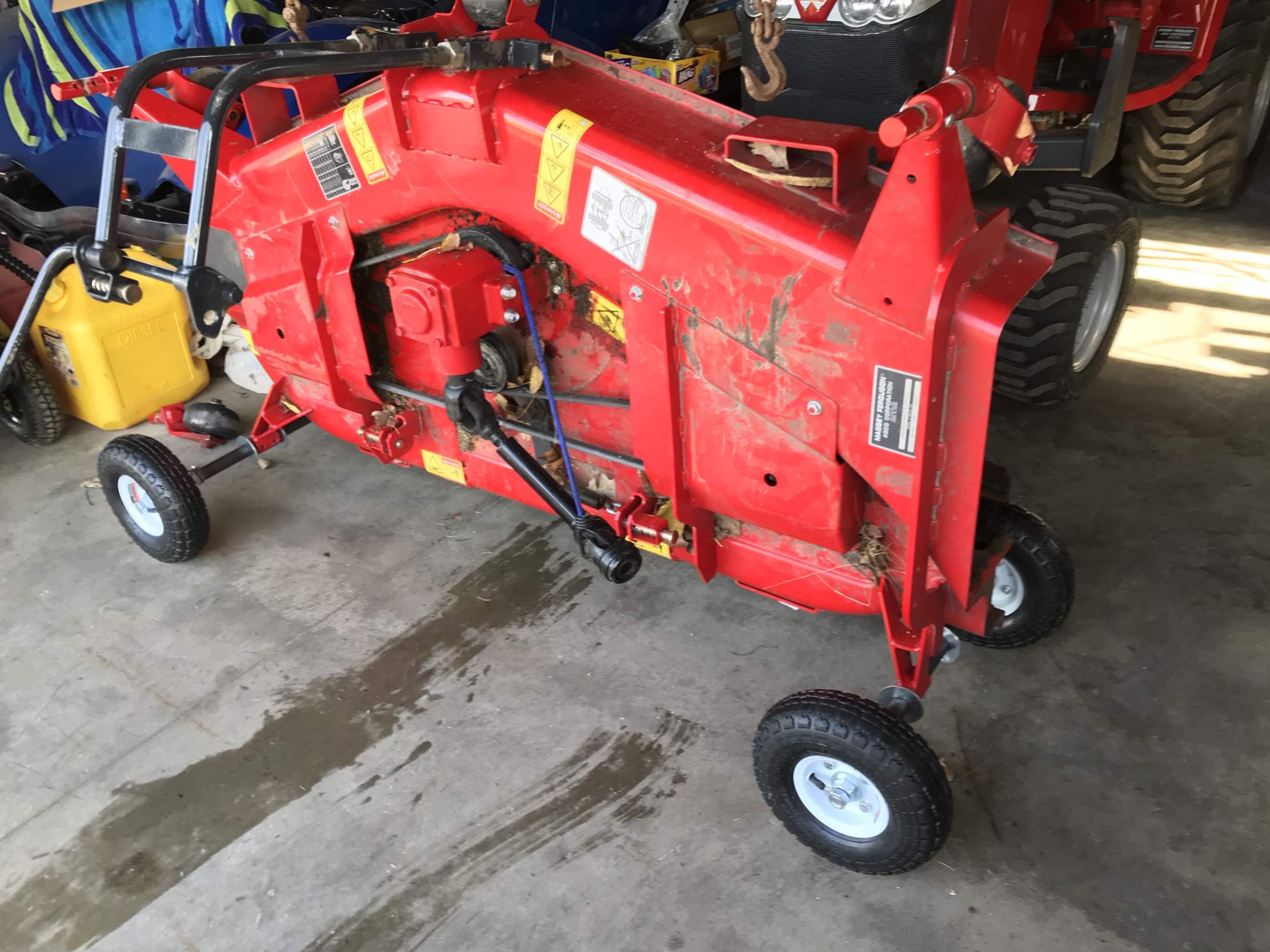

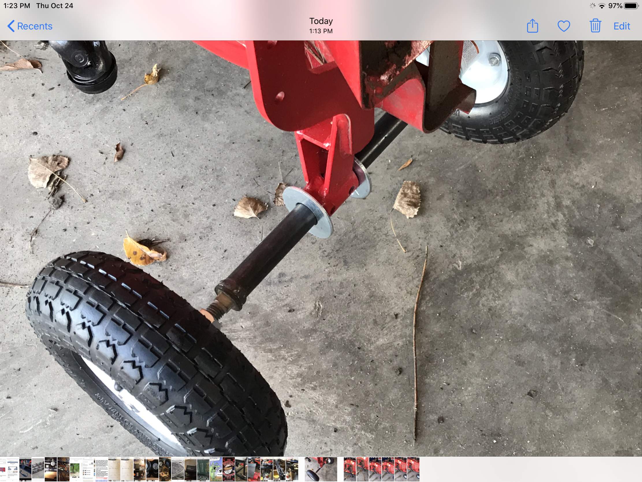

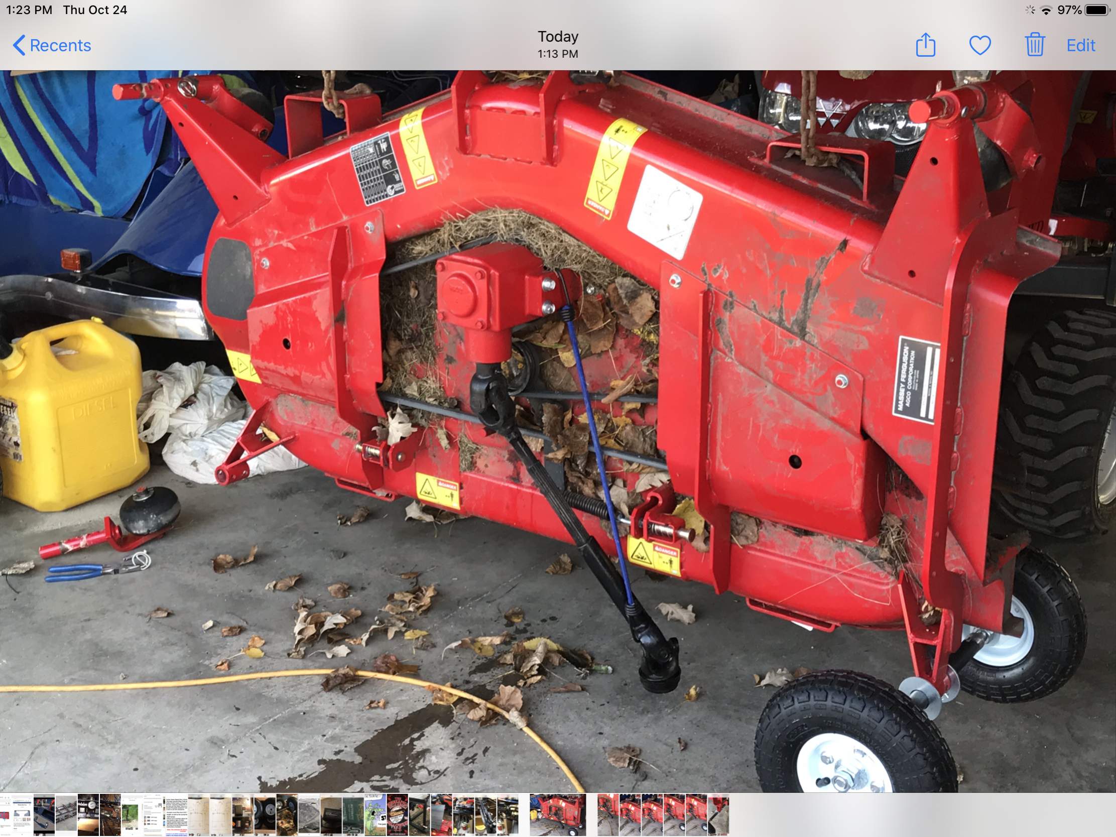

All done, it rolls easy and slides nice to tuck it up to a wall or whatever with those tires. Would of been ok with 9 inch long axles rather then 12 inch, it balances real nice no mater where it is on the axels that’s why I never drilled the axel and put the pins in on each side of those big washers.
And on to next project.

Cool, looks good.
It doesn't show up in the picture very well but they are lockable. See the wheel in the upper right it shows part of the brake.

How do you determine the placement of the horizontal hole for the clevis pin that goes through the guide wheel mount so that the mower deck is balanced? I was going to use 18" steel rods with holes 1" from each end for 3" casters. Need to figure out where to drill the hole in the bar for the clevis pin. My deck is the RCK54-23BX.
Now I'm not sure if an 18" bar is long enough for general stability.
Any suggestions?
Thanks.
   / mower deck dolly
#40
Any suggestions?
Thanks.
I'm not familiar with your deck, so I'd say just put the deck up on the dolly wheels, and see how it balances. Find the sweet spot, mark it, then drill the holes for the clevis pins.
