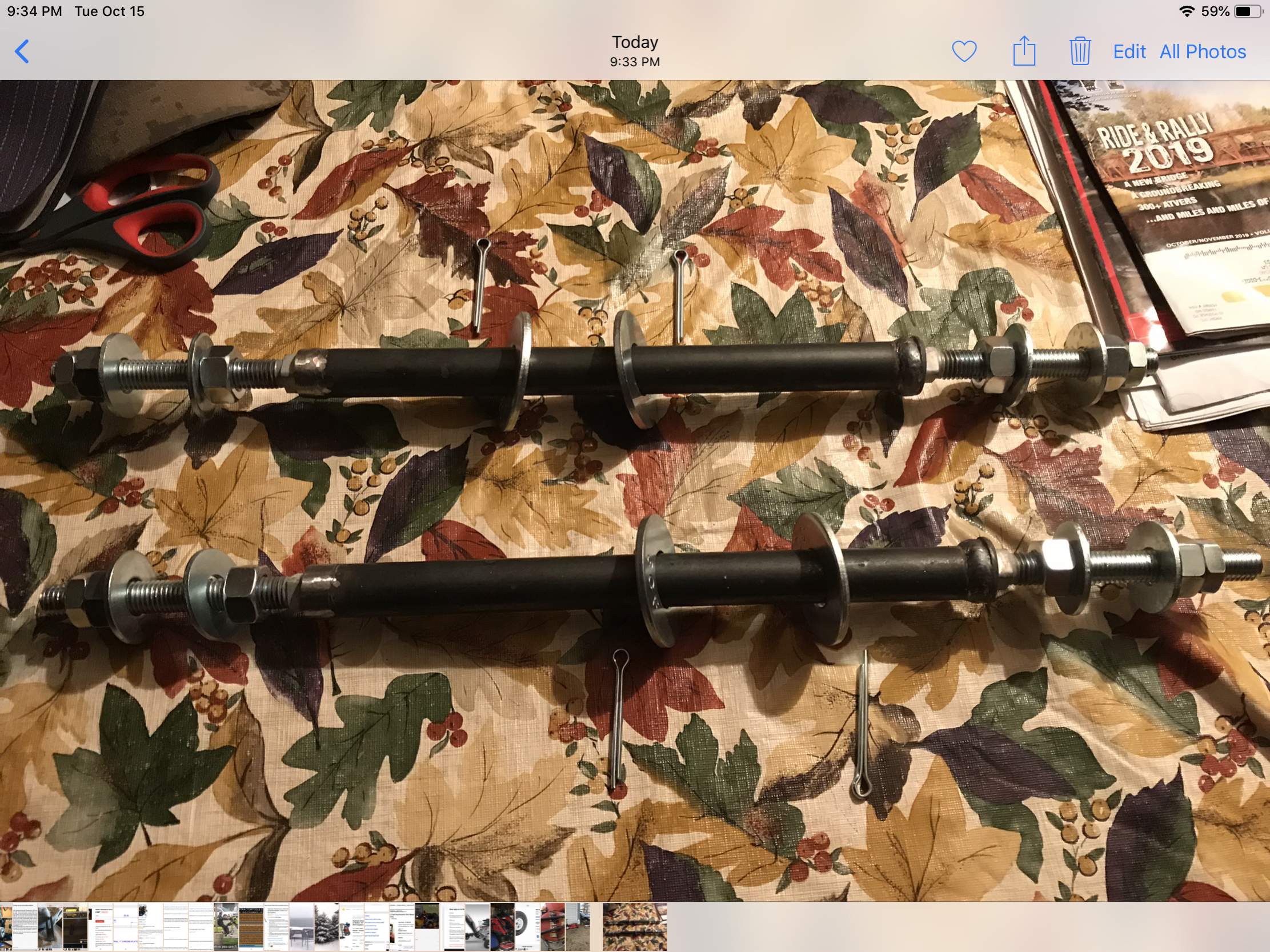

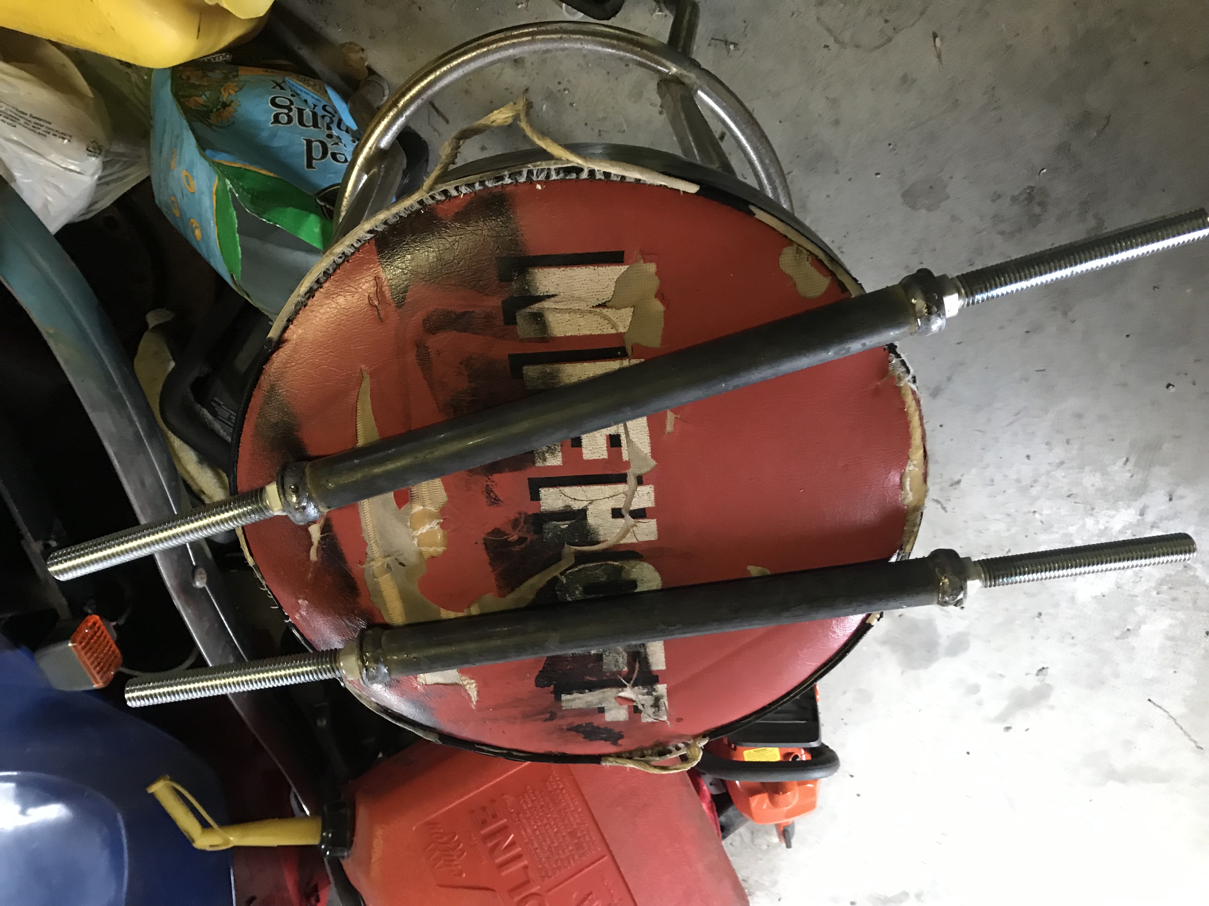

Ground off two of the welds and now I am just waiting for tires then I can balance it and drill the four cotter pin holes for the pins and it will be done, thanks for the ideas from those who have built their own dollies.
Looking legit.

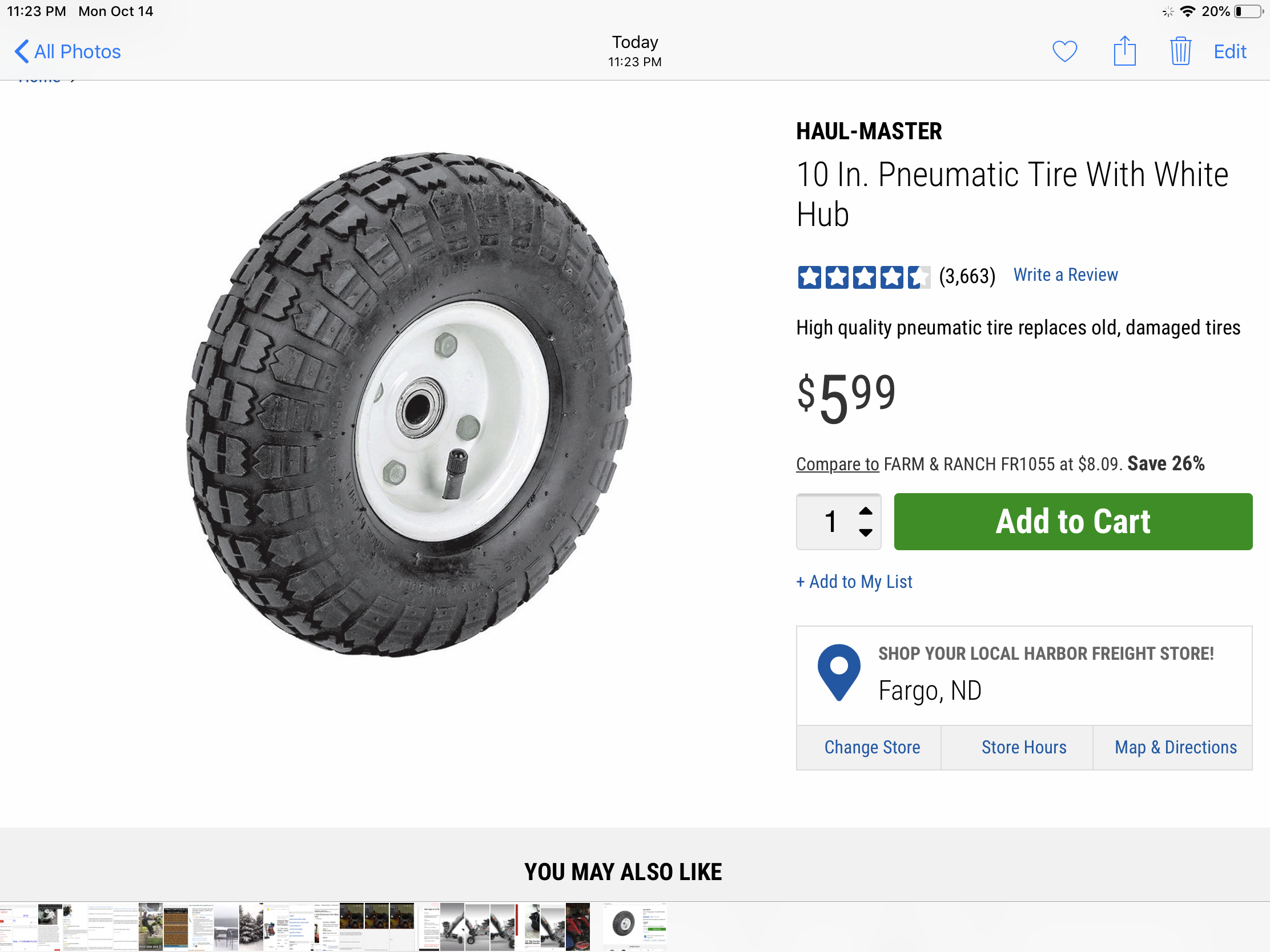

Well my wheels showed up today so if the rain stops I will go out and fit them so I can drill the holes in the axles to keep them from moving when assembled on the mower deck.
/ mower deck dolly #26
The wheels fit perfectly but they do need air added.

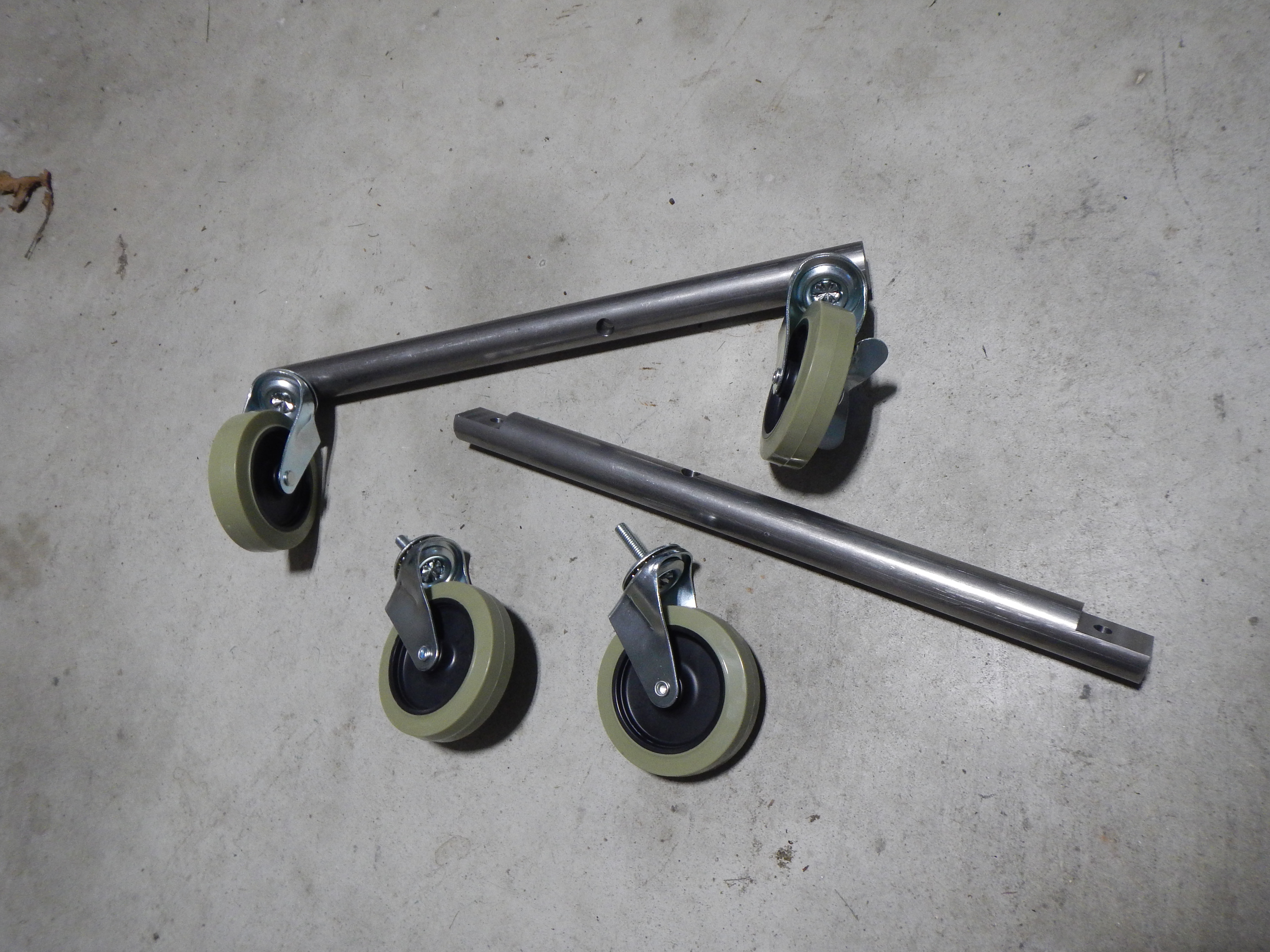

Here's the ones my brother bought for his 7 iron deck. I might do the same for an old 455 deck that I need to store for the winter.

Cool, looking good. What are the 2 loose washers on the rod for?
When I put the axles on I will balance the deck and move the washers to each side of the tabs and drill a hole and put a pin in to keep the deck from moving on the axles so it stays balanced, but first I will get the axles put on and maybe just the weight of the deck will keep it from moving on the axles. I guess I could just use some (4) cheap vice grips to accomplish the same thing.
This is the best idea yet because the wheels swivel so you could steer it. Yeh, cool, I like!
/ mower deck dolly #32
The ball bearings and cups must be pretty stout to handle the weight, swivel would be nice.
/ mower deck dolly
#33
Yeh, gotta make sure they're rated for the weight. I would do lockable ones like this. How much that 60" deck weigh, anyways?

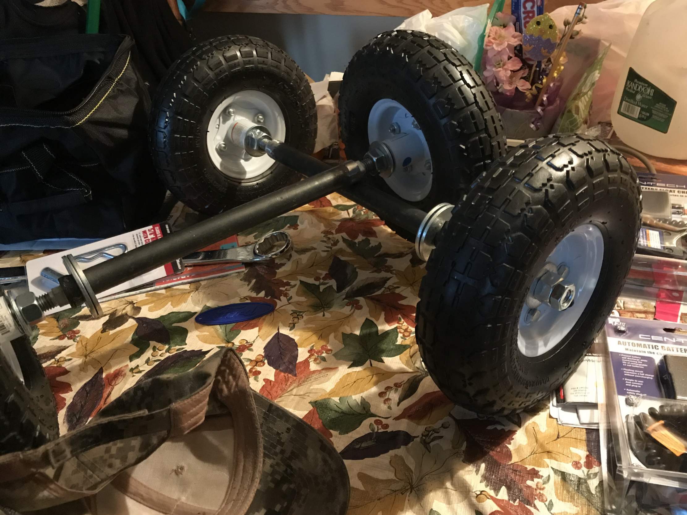

All done, it rolls easy and slides nice to tuck it up to a wall or whatever with those tires. Would of been ok with 9 inch long axles rather then 12 inch, it balances real nice no mater where it is on the axels that’s why I never drilled the axel and put the pins in on each side of those big washers.
And on to next project.

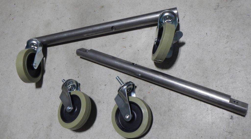

It doesn't show up in the picture very well but they are lockable. See the wheel in the upper right it shows part of the brake.
