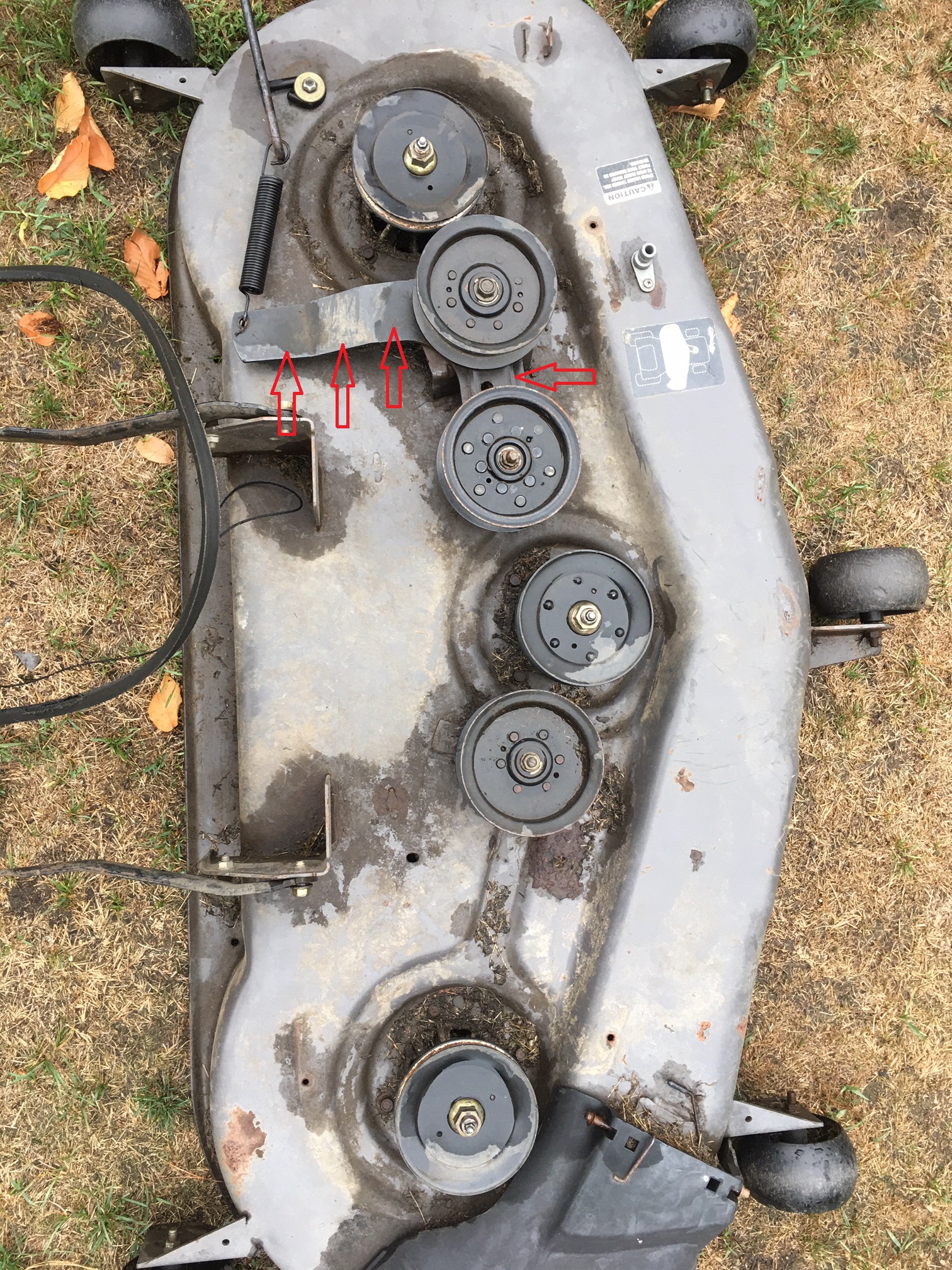

Hi folks,
I have a 2011 Husqvarna LGT 24K54 rider and love it ...when it's not giving me fits. And I realize that machines don't give fits, owners who aren't clever enough to keep em' running proper are the issue :).
I had a lengthy post at the end of last season where the mower deck belt kept jumping. Lots of good inputs/questions around pulleys, tensioner, etc. and while I got all new spindles, a new tensioner, certainly new belt(s), I think the issue ended up being that the "pitch" of the deck was not correct. I know the front needs to be 1/8" to 1/2" lower than the rear and ...after addressing that, it seemed to work well. For a while.
Now it's doing it again. I bought a new belt (not OEM) and thinking that was a mistake; either too wide or a bit too long. I checked all bearings/spindles and all seem fine - no slop, same height, etc.
I guess my big question is this: If I start all over with getting on a flat surface, measure height of blades - front to back - off the ground, as well as side to side to make sure she's level, I wonder about where "top dead center" is, or where Husqvarna expects me to start ...ground zero? If I put the deck adjustment at the bottom, what height should things be off the ground? Where is the starting point for that front "arm" that attaches to, and 'lifts' the front of the deck, where should I start with that? I"m wondering if I'm starting TOO HIGH or TOO LOW with that front arm, or the 2 rear arms, to then start measuring the height of the blades, etc.
It's crazy but, I put a new belt on, can see that the front is nicely lower than the rear, (almost a 1/2"), and I can go Maybe 50' before the belt jumps. I do have more success if I mow with the deck high off the ground, but, ...I like a nice flow, low cut, of the grass.

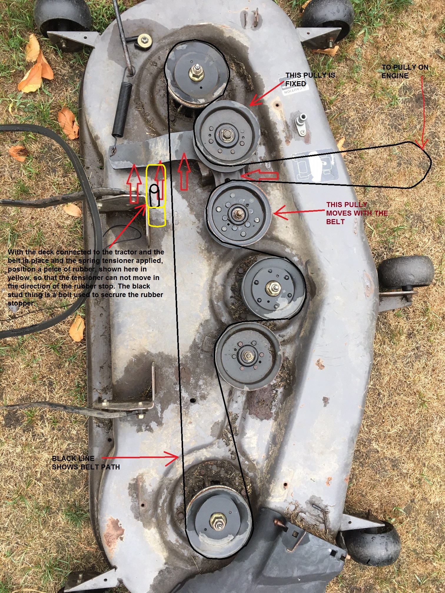

Thanks VERY MUCH Richard. Great inputs/ideas.
Not sure where - how - you got some impression I'm averse or "balking" at getting a new spring. I'll buy a new spring tonight. That makes a lot of sense. (I actually bought a brand new spring at the end of last season... Just remembered that when I went out to take a picture of the deck).
I'm pretty sure I bought a new idler arm "setup", the pivot-arm and the pulley that moves in and out. i have a new spring and 'retaining arm' coming soon.
Very interesting comment about keeping the belt loose - I would have thought the exact opposite, keep belt taught/tight so that it doesn't jump, but, you make a great point about when the blades engage thick grass, belt tightens, blades then spin free and belt loosens ...
Almost seems like I should try and have that pulley that adjusts forward, pivoting on the tensioner arm, to stay "back" ...so that the belt stays loose, right? Just don't know how to do that. Where were you thinking I'd bolt the piece of rubber (see attached photo). Why not just use a ...softer spring? Just scared about this because, if I throw my BRAND NEW belt, it will stretch and become closer to junk. I've bought probably 3 or 4 belts in the last few months... :-(

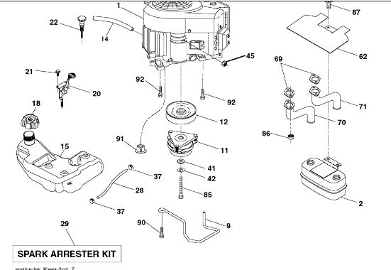

Below is my marked up drawing of your JPG. I noticed that in your photo, the belt guide that would normally be installed on the tensioner pulley is not in place. I assume that you put that in after installing belt on the deck.
Do you have this item, number 9 in the photo below, attached to your engine?
The belt that is used on your mower is long. Power pulses from the engine and load variations from the mower blades can cause the belt to stretch and then relax. This will cause the belt tensioner to move around a lot. It only takes one loose moment for the belt to jump off one of the pulleys.
Richard
Richard
Great notes/graphics overlayed on my JPG. Yes, I have part #9. Yes, I have my belt guide on the tensioner - just not in the picture. And Now I understand how to setup the additional guide with the rubber stopper - I'll get right on that. Thank you.

Richard. I mowed yesterday with NO JUMPING. Not really sure why, but, I did take the tensioner arm off, clean everything, actually removed the old washer and put a rubber one in it's place (don't ask - I thought it would take the tiny bit of slop out of the arm) and then I did bend the arm up, with the pulley that you noted "moves with the belt", just a little so that it was ...reaching up toward the engine/drive pulley. I also did not lower the deck below 4.
I'm going to setup that rubber so that the tensioner arm can't ...over extend itself. Thanks so much!
