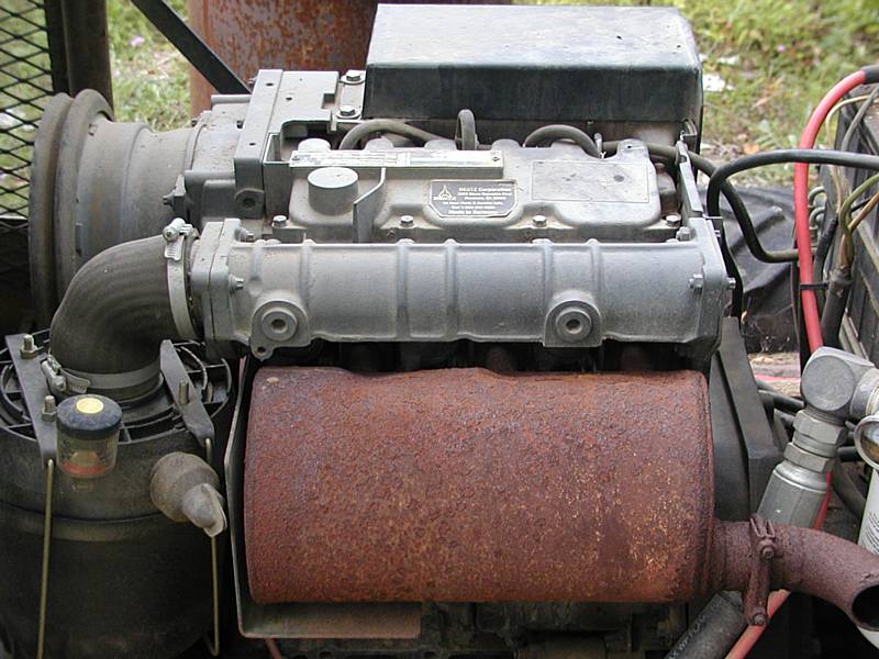

I would like opinions on moving the air intake on my Deutz PT from the rear, where it sucks all the dirt the tractor can throw up, toward the front, by the oil filtering system.
It looks to me like you just swap but I wanted to make sure it would not effect fuel/air flow and that sort of stuff.
And do you think it would help? My poor filter is pretty mucked up just from driving on my dusty dirt road for a day.

Carl,
Are you talking about combustion air--which is taken in via the filter, or cooling air for the oil cooler which is pulled in via the fan mounted to the alternator shaft?
I have not personally had any problem with combustion air and the filter clogging. I do have to pay attention to the oil cooler because it tends to clog over time.
The one issue I would be concerned about would be heat--and want to ensure that the temperture of the air was not increased.
In either case it is unclear to me what can be "swapped".

Sorry... Lemme see if I can find a picture....
Hmm. I can't None that shows the intake manifold. Maybe you got one Ken an understand what I am asking? I want to move the intake air filter for the fuel injection to the front of the manifold port. On the Deutz, the manifold is a long tube with what appear to me to be identical ends, one covered, one with the air filter attached....

Will this suffice? It's of my 1845 but I dare say the layout of the intake manifold is similar and most likely it's a simple swap ends. Simple for you maybe, but my 1845 presents problems with stuff in the way of a forward mounted air filter.

Ok, now I understand.
The air filter housing is plastic. Swapping it to the opposite end of the intake manifold would put it pretty close to the exhaust--I would think that would be undesirable--because of the heat and because of the increased intake of exhaust fumes. On the 1845 I don't think there is enought space to swap--even if the filter were turned up. Perhaps the space is different in the 1850.

I also intend to re-rout the exhaust, continue the pipe back to the rear and then out. In hopes of reducing the noise this beast makes... It is too loud to not have headphones, but then it is too quiet to hear your brush hog bog down...

Deutz makes several variants on the muffler, one of which would point straight back; originally, I had hoped I could just flip the existing one 180 degrees, but I think that it would interfere with the intake housing.
Having thought about this for my machine, I think that one might need to relocate the hydraulic filter a little, but maybe not.

The air intake where it enters the turbo on my JD2555 is pointed to the rear. A simple boot makes it elbow across the motor, and a 4' long pipe hooks into the air filter casing in front of the radiator. As long as you allow for sufficent volume, bringing air from a different source isn't a big deal. Remember the old days when "cowl induction" was the thing? Just a different way of getting the air from a different location.
I can see it now, mounted on the flat hood of a PT, you have added the condenser from an automobile plumbed to your hydraulic lines for added cooling, and a roll cage to protect it, made out of hollow tubing that brings in already filtered air from high up above the normal dust cloud that the turbo'ed engine needs to do the additional work you have found for it in the field of blackberry distruction.
If I had a PT and wanted to move the air filter or add hydraulic cooling capacity, I don't think it would be a really big problem, but alas, I don't own one, yet.
