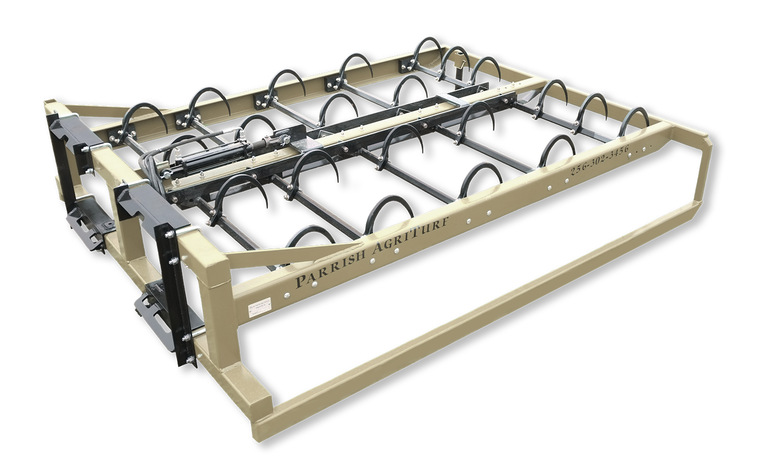

So to answer a few of the questions in this thread....
The tractor is listed in my profile.... NH Boomer 24. The bucket is NOT quick detach.
Stall barn is like 100 ft from the hay storage barn.
Currently the hay guy brings his skid steer to stack. He uses the kuhns 10 bale graple. String side is down. I am not sure my tractor could lift 10 bales and the grapple even if it were a quick detach bucket.
I don't know specifics about the capacity of your tractor's loader, but that NH model looks pretty similar to a 2-series JD (i.e. a 2320 or 2520 or 2025R). I have a 2520 which has a loader capacity of around 1100#. With a 300#+ set of pallet forks my tractor can move at least 15 small squares at a time on a pallet. So I don't think 10 at a time would be a problem for your tractor even with a grapple. I doubt a grapple would weigh THAT much more than my pallet forks.

One thing I might be tempted to try seeing as how you don't have a SSQA bucket is a pair or two of the inexpensive light duty clampon bucket forks,
with two pair (4) mounted to a bucket a person might be able to slid them under your bales and pick up about 3 at a time.
/ Moving small bales - bad back #28
We bale small square bales and use hay grapple for 10 bales at the time. Very common. First forget using the strings, if a string breaks the bale will spill on you and there is manual work. If bales are not tight and you are not careful lifting by the strings they still can spill apart.
You need to match the pattern his implement is so you are able to unstack what has stacked but you will be lifting a 700 pound implement and 800 pounds of hay and not sure your tractor will do that. Also no idea it has the reach to the top of your stack but that must be considered.
My quick thought is see if your hay guy is willing to come back and unstack them onto pallets you can move. You may need to build pallets to match the size of the 10 bales. Your tractor capacity will determine how many layers of bales you can stack on a pallet. You would need a lot of pallets.
With the size of operation you have is there no one who would help with this for some horse time?
To use a grapple remember you will need a third hyd capacity to operate the cylinder.

I looked at getting the same grapple he has. Since no detachable bucket no dice. Also the weight issue would have been marginal at best. Getting the same grapple was my first thought.
We do have help and likely the real long term answer is getting swmbo comfortable operating tractor. The help she has is during the week when I am at my day job. So I would not be around to operate the tractor.
She can operate tractor I think she is just more scared of it than anything.

Can you describe the bale configuration with the grapple he uses? Does he cross stack? The use of pallets is a great suggestion. I store my hay on pallets (free at most wheelhouses, etc) You could have him stack on pallets and figure out how much you can lift with some bolt on pallet forks. You would insert pallets as needed so you could take a block out at a time. Just thinking here.
/ Moving small bales - bad back #32
Why can't the help do this and you could use bucket forks to move pallets after work and/or weekends?

He has a Kuhn痴 10 bale. It is 2 across the top long ways. Then two rows of 4 across going 90 degrees from the two long ways. He stacks them so the 2 across change where they are north, south, east, west so each layer of the stack is different.
So one layer looks like
They are in stacks 7 high because of how tall/short the barn is.
But yes easy solution is the young strong teen age help pulls them off the stack and puts them on pallets. I can then use forks or carry all to move pallets after work.

Geez, you have pallet forks. You have young teen help once a week.
Have the kid Stack 9 on std pallet 3x3. (Maybe more, Its been a while since I worked with square bales). Start with 4 or 5 pallets worth. Or two weeks supply. 45 bales, what? Maybe an hour if he is lazy..... then every week stack either 2 or 3 pallets to replenish. Again, maybe 30 min tops per week. You can pay him 3 to 10 years for what the implement costs you..... move at your convenience to horses.
/ Moving small bales - bad back #37
I think you're on the right track. Most pallets aren't quite the right size for bales, what I would consider is a wooden rack sized to bales that sits on top of a pallet.
The other consideration is what to do with the bales at the other end. Ideally you'd want something where you can get them into the feeder without ever lifting them. Or maybe I'm overthinking it. OP said 21 bales a week, that's 3 a day, or one and a half at each feeding. It might be easiest just to cut the string and carry as many flakes as you can to the feeder.
