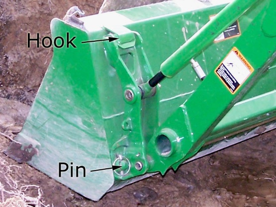

i have john deere 4410 compact utility with front bucket. i am hoping to use this tractor to move round bales to unload off trailer and to put in storage building. would the spears that attaches to the front bucket using a bracketwork well or is it best to remove the front bucket and attach a a bracket where the bucket is. I want the best product and I am looking for practical advice. thanks in advance.
You will want a bale spear with its own frame that attaches to the loader carrier after you remove your bucket, rather than something that attaches to the bucket. Your loader should have the JD100-400 QA that Deere still uses on its compact loaders, so it would not be difficult to get a bale spear to fit your loader.

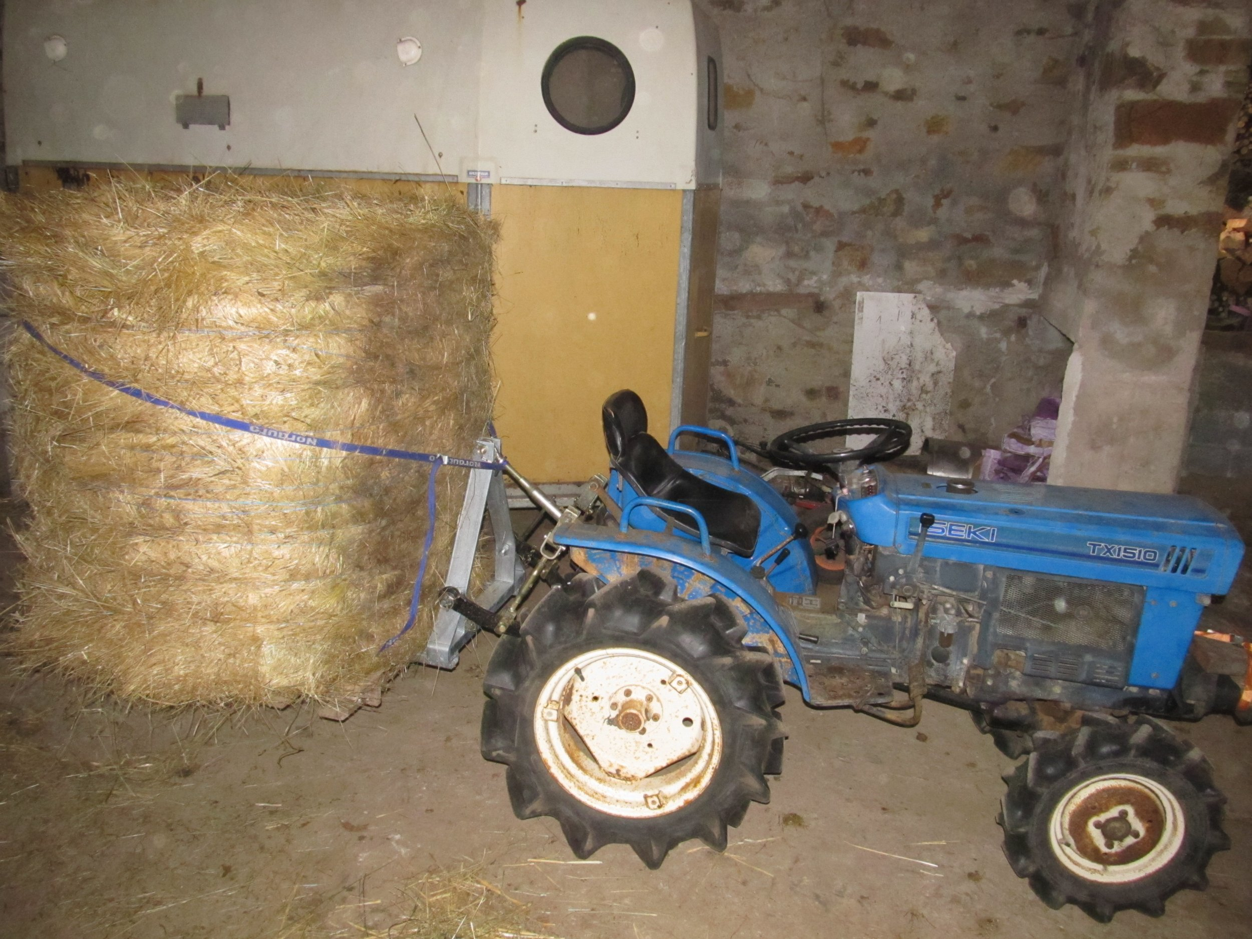

I also have a 3 point spear for my smaller 37 hp tractor without a loader. I use it when the other tractors are broke down and I'm desperate to get a bale out. I can pick up the bale and bring it into the pasture, but I can't get it into the cradle, so I just unwrap it and leave it on the ground. It goes twice as fast without being in the hay cradle.

I wouldn't put a bale out in front of a bucket. Has too much leverage out away from tractor. You need it as close to the tractor as possible. Especially if you are dealing with all those liars.
