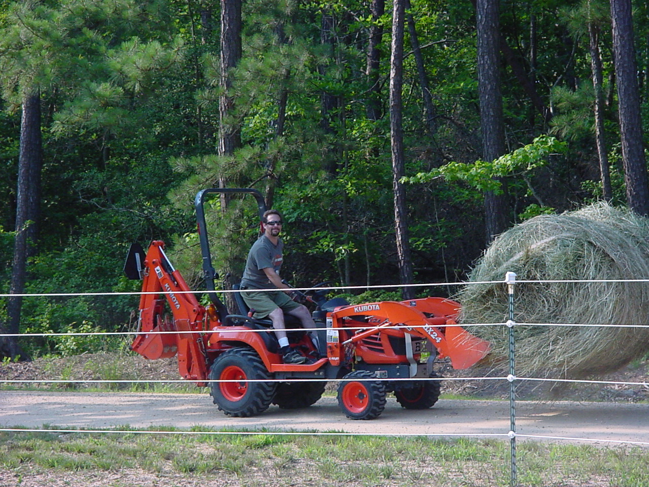

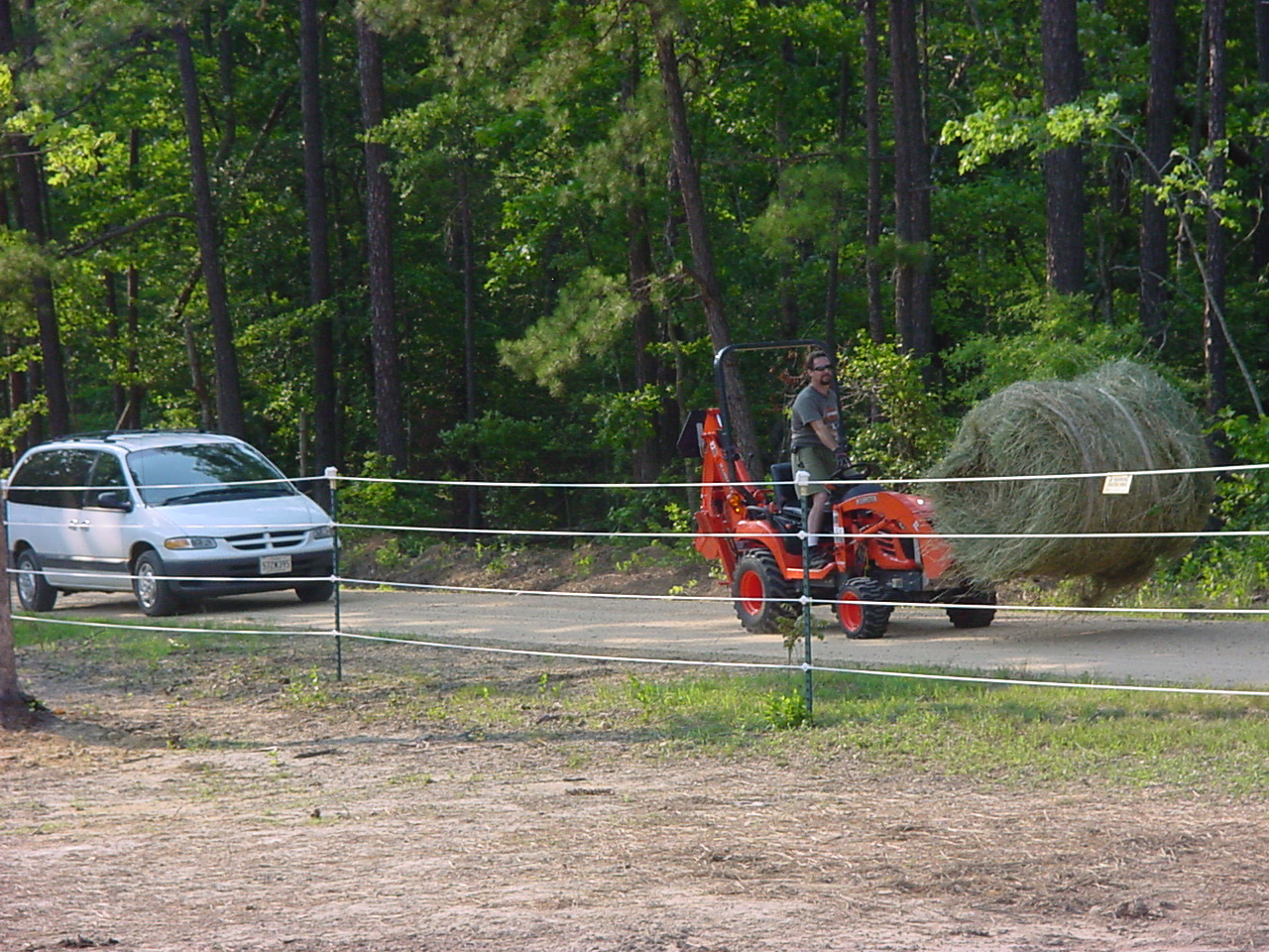

This is yet another thread about what NOT to do. I'd drag it on a car hood with a BX but this is just asking for trouble and should come with a disclaimer.

I am not sure how this is what is NOT to do. The BX was able to pick up the load and I carried the load low kept it level ground. Granted its not something I would do ever day or multiple times a day with a BX but in a pinch...

   / Moving Round Bales with a BX #18
The lesser and healthier of the two evils is
the car hood as the term "over center load overloading"
is what this is in reference to.
The load is physically beyond the foot print
of the tractor and is creating a very large
unbalanced load that WILL roll the tractor
over on its side if enough swaying movement occurs
from a dip or sudden turn resulting in rolling over
opposite the direction of the turn if made to sharply.
