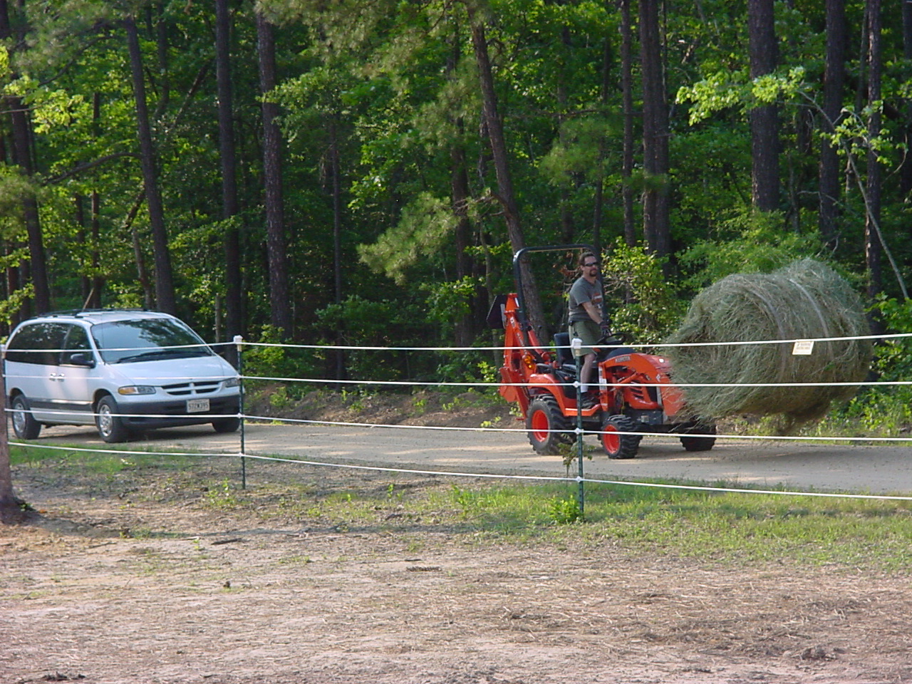

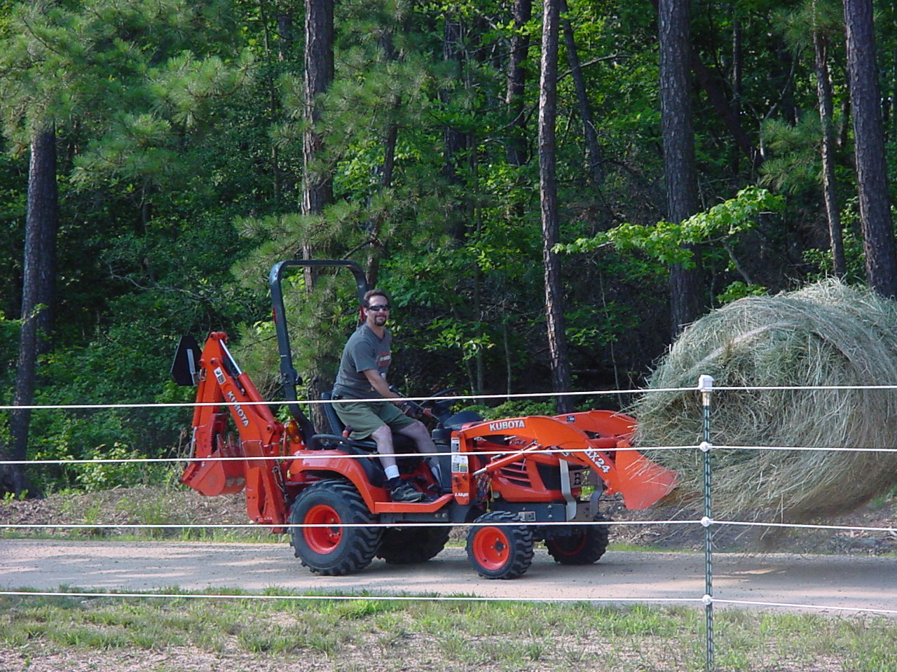

I generally use a hay spike on the 3pt hitch to do move these bales, but it turns out the FEL can handle the bale in a pinch.

I am always surprised at how much this small tractor can do with a bit of patience. I figure with a set of forks vs the bucket forks the weight would be easier to handle because the weight would move back about a foot.
I generally only move round bales with the FEL in the winter when the backhoe is on for a counter weight to my snow plow.

<i'm not a hay guy>
i know how much a square bale of hay or straw weighs, give or take.
but how much does a round hay bale (like you show) typically weigh, dry/damp/wet?
wrooster
/ Moving Round Bales with a BX
#9
Wrooster,
That is a 4ft by 4ft diameter round bale, wet I would say around 500-650lbs depending on the bale and as they dry out they get considerably lighter 400lbs or so.
I have to push them off my landscape trailer and into a carport for storage in the summer when the bales are fresh its much harder work than in the winter when they are dried out.
The round bales are probably going to be the reason I upgrade my tractor at some point.

Either those aren't 4x5 bales or they were rolled really loose. We make 4x4 bales with a JD446 baler and they are 700-800lbs dry.
I move 4x4 round bales front and rear with my B3200 and it's about the smallest tractor I would use. Any kind of hill and I have to be pretty careful.

This is yet another thread about what NOT to do. I'd drag it on a car hood with a BX but this is just asking for trouble and should come with a disclaimer.

I am not sure how this is what is NOT to do. The BX was able to pick up the load and I carried the load low kept it level ground. Granted its not something I would do ever day or multiple times a day with a BX but in a pinch...
Sorry, Typo they are 4x4 round bales
and for weight I was looking at the chart on this page
Using and Feeding Round Bales to Horses
/ Moving Round Bales with a BX #14
4x4 bales weigh 600lbs or less.

The lesser and healthier of the two evils is
the car hood as the term "over center load overloading"
is what this is in reference to.
The load is physically beyond the foot print
of the tractor and is creating a very large
unbalanced load that WILL roll the tractor
over on its side if enough swaying movement occurs
from a dip or sudden turn resulting in rolling over
opposite the direction of the turn if made to sharply.

All I can say is, I would be getting another hay guy. Does he roll my hand? I have never seen a roll that loose and hold together. That doesn't even look like it has a center.
