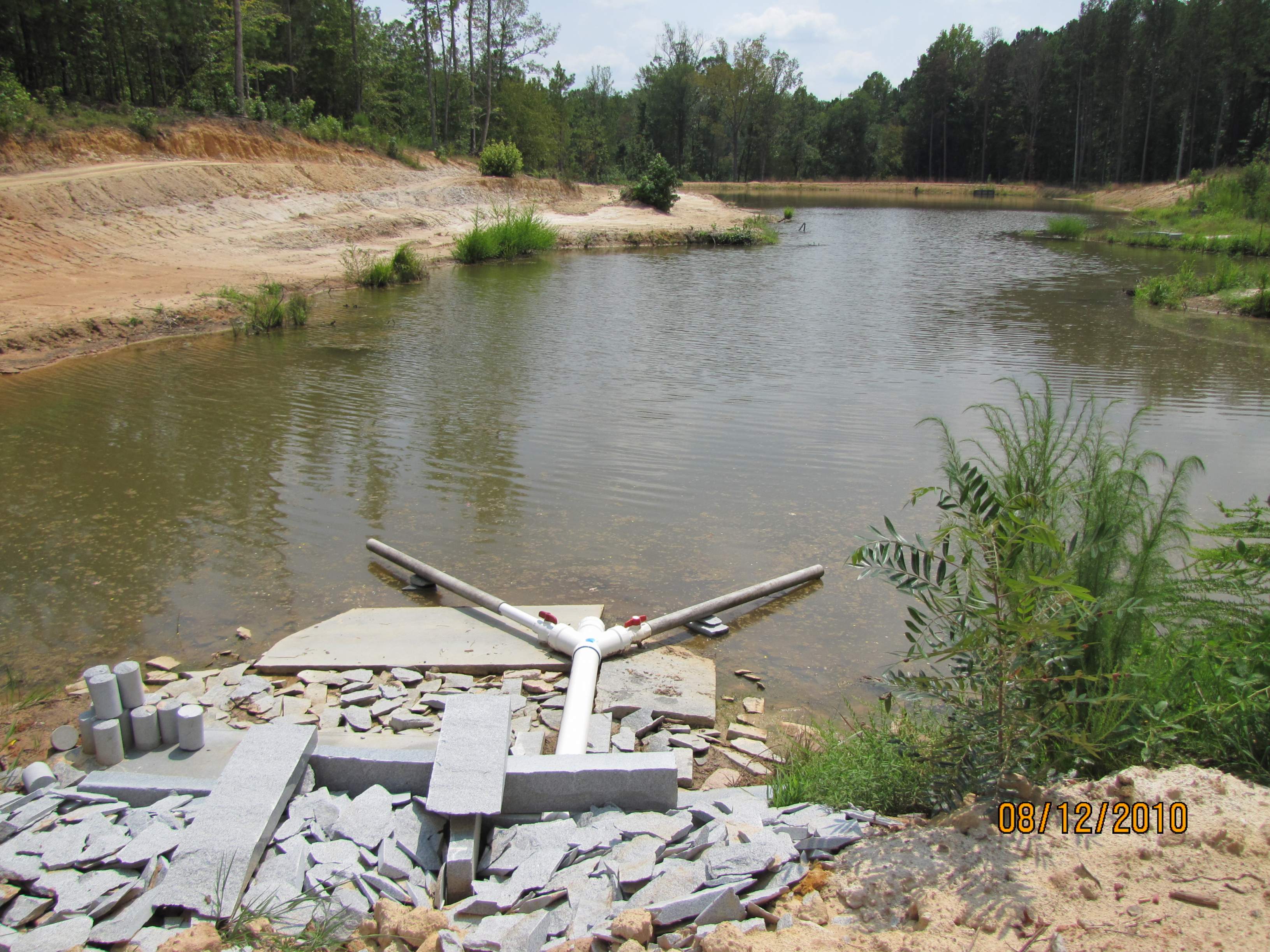

The trick is to not go fast,just steady. I cut a 8ft bank that was next to me pond an filled a large hole making a rec area for the boyscout camp I am building. It just takes time..

That's a nice looking swimming hole! How much fill did you move, and what did you use to do it? How many hours do you figure you've got in it?

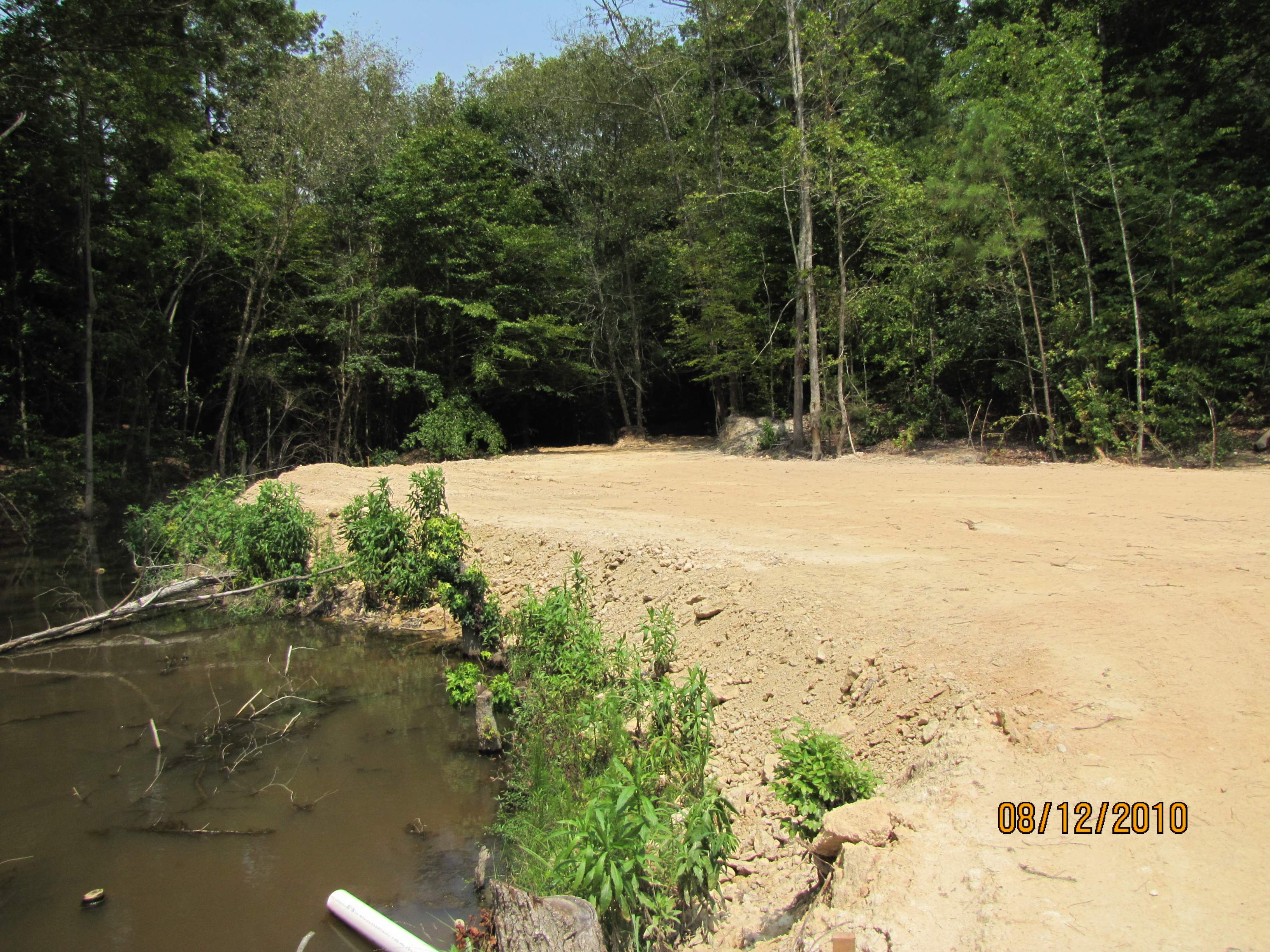

Here is a picture (I hope) of the road to the building pad.

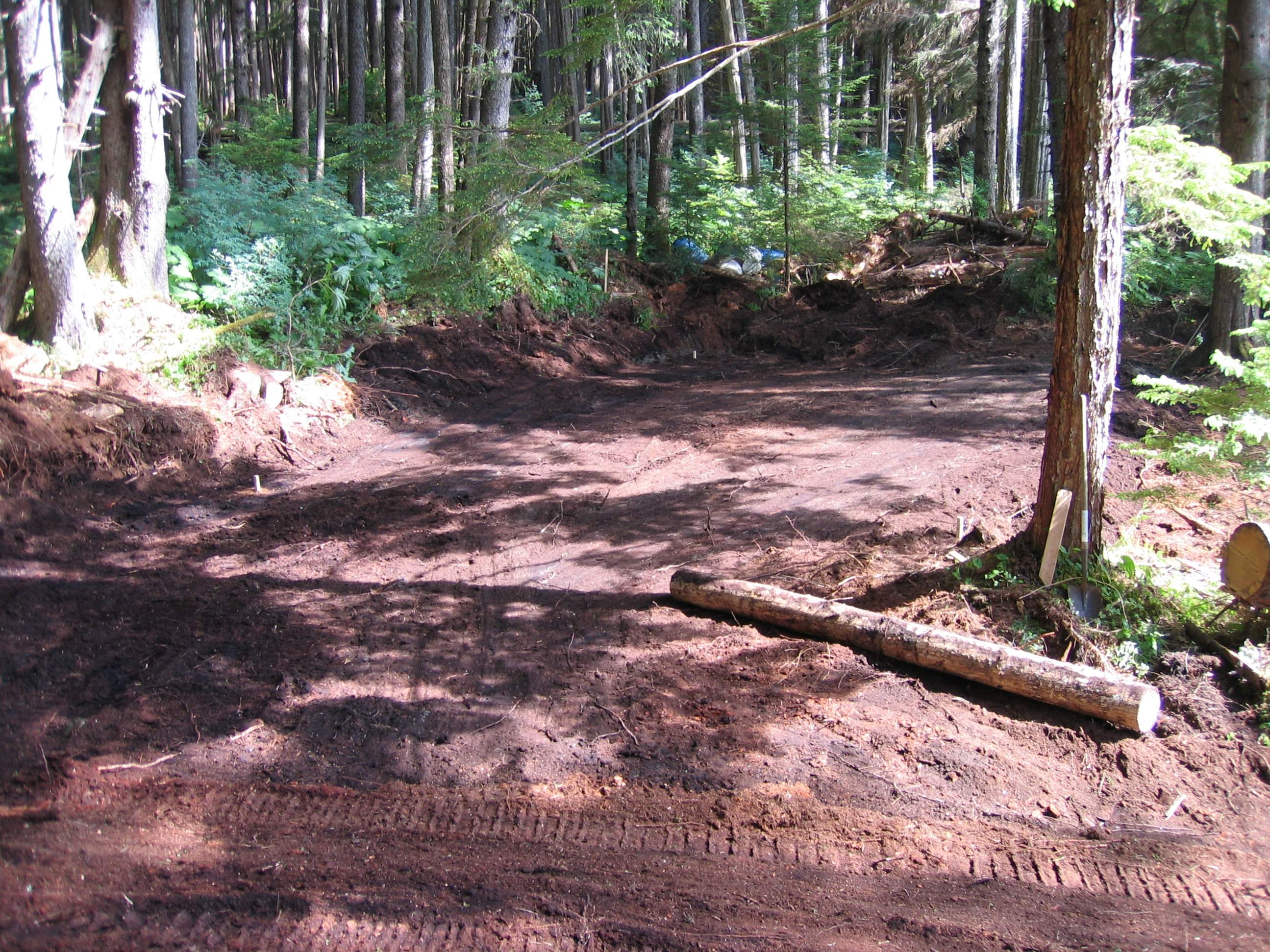

Here is the building pad.

I think you have a part of the answer already. Use that little flatbed converted Samurai (assuming it's yours) to pull a dump utility trailer like what Carey posted. Use the tractor to load the trailer, pull the trailer with the Sami, dump, and go back for another load.
It's hard to tell from the photo how much gravel you're wanting. Is that about a 20x40 foot pad? How deep do you need it to be? 4 inches thick and you're looking at about 10 cubic yards of material. That's doable, but it's going to take a lot of trips no matter what you do.
A reasonably good trailer will drive across that beach just fine, it's just going to bump around some. The ride will be smoother in the sprung 4x4 Suzuki than with a loaded tractor across those rocks. Neither will be fun. You can do it, though.
