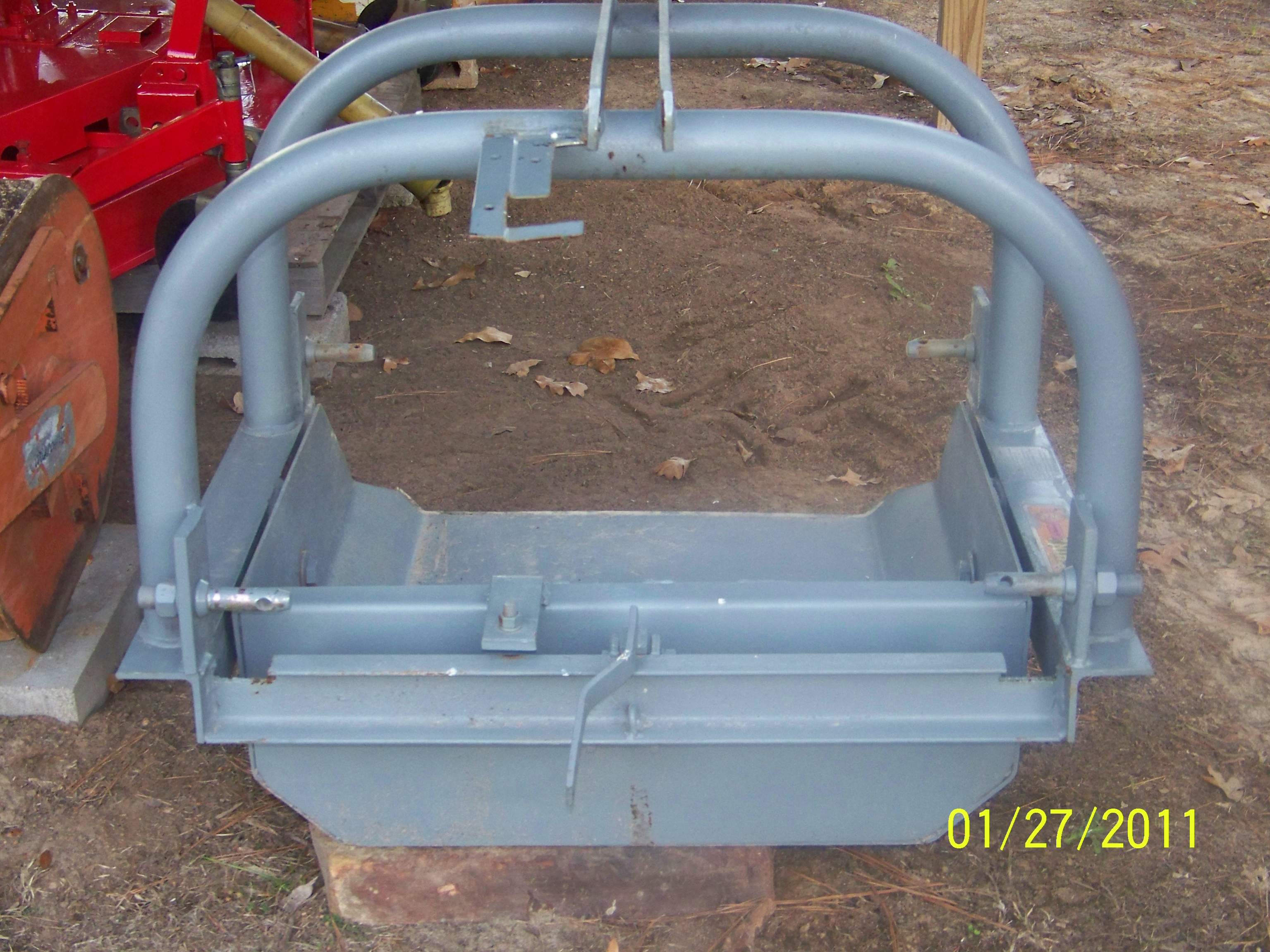

I have a rear scoop I use with my loader and with it full and loader full I believe that is all the weight I should carry. I have a ym2002d. I actually moved 40+ yards with it about 400'. Many trips.

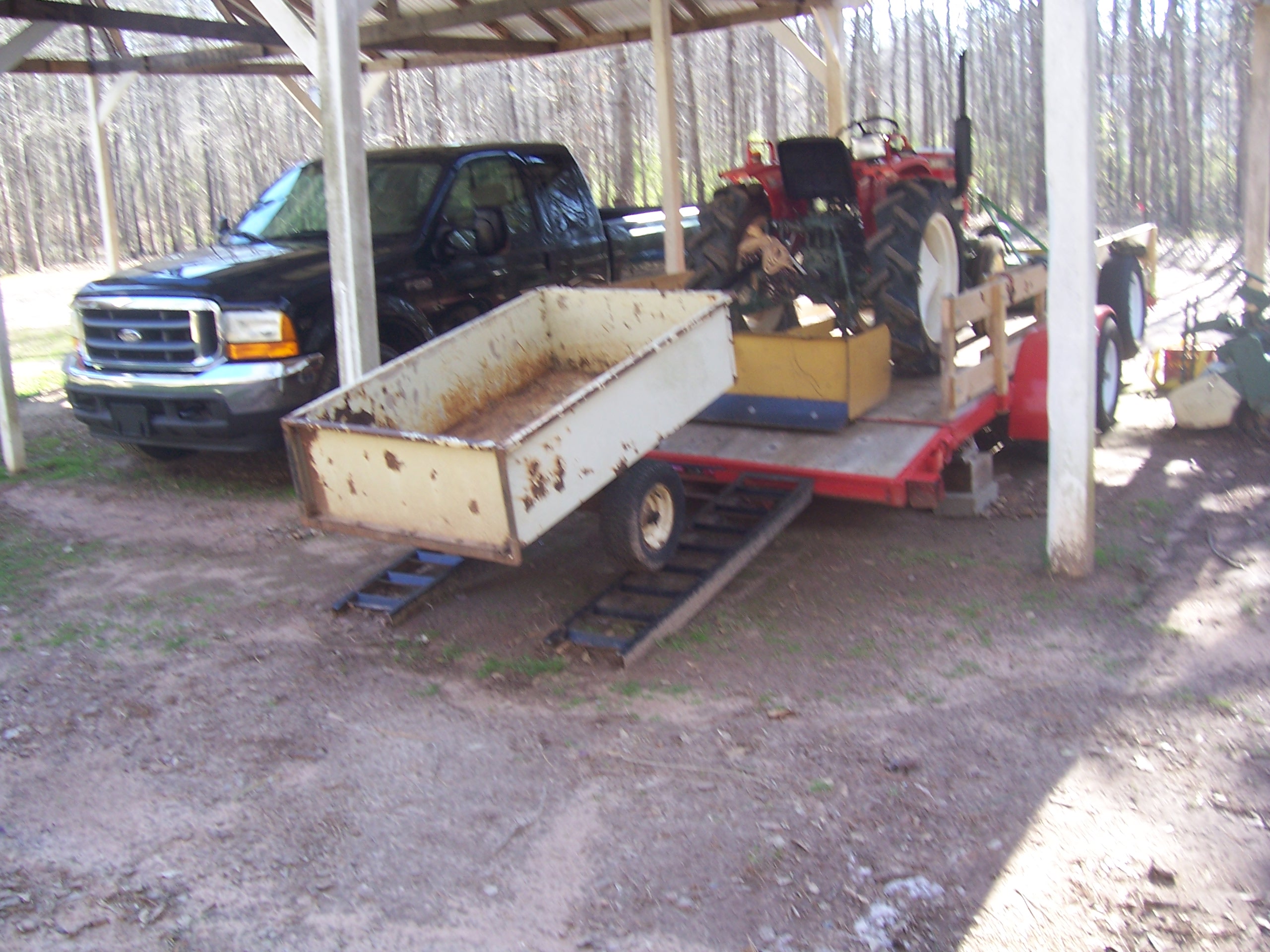

What I use around the house. Just about stays on this time of Yr. It's older and well made from Sears I believe I seen on it that I've had forever. I used it for moving Crush and Run. Esp. when I was building the House and Dr. the Tilt bed comes in real handy for dumping the gravel.
Carey
