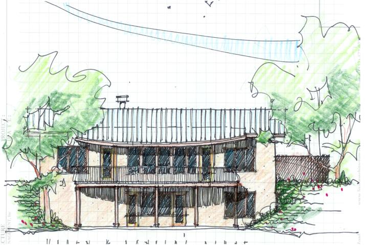

Thanks Beenthere, I'll check out the purchase and rental price. Dave our house on the hill will also have a walkout basement, see attachment. The style is Tuscany Farmhouse.
