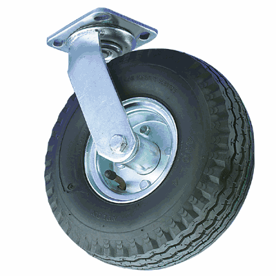

Bird,
Good point. I guess that's why my Woods mower is supposed to be stored on blocks instead of on its solid rubber casters too.
How about what's in the attached photo? At $20 apiece /w3tcompact/icons/shocked.gif it may be a little pricey. I think I'll just end up with some heavier-duty casters or at least something that is sealed a little better and looks like it won't bind.

Rob, the one in that picture is pretty anyway. Of course, I don't know what kind of weight it would handle./w3tcompact/icons/laugh.gif

Bird,
It has a capacity of 500 lb. I found it on the Northern Tool web site after reading some of the other guys' comments. And it isn't $20, but actually on sale for $18.99 (in case you want to pick up a couple dozen or so/w3tcompact/icons/smile.gif).
