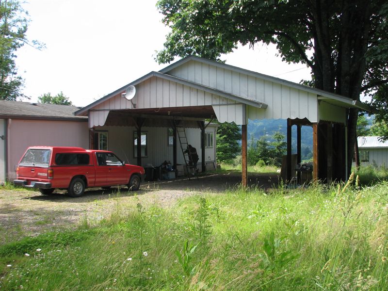

So I am asking about shop expansion.. The wife rightly turns to me and asks why not move a carport / pole barn we have. It is a 32x35 or so. It is pole barn constructed with no sides. It was used by the previous owner to house his fifth wheel (and his girlfriend cause his wife did not want her living in the house - yes, true)
So is there any value in doing this. The roof is shot, so not worried about that. I guess the only thing of value is the actual framing. But I have to (hire?) labor to tear it apart correctly then reassemble then side.... Just buy a new one? Or tear this one down. Hate to waste materials but not sure about savings.

They move big ones frequently around here. Disassemble and reassemble and the interest generated at auctions means it must be worth it.

How far are you wanting to move it? Sounds like a fun project. I'd do it if the frame was good. You could do anything from pick it up with a crane to jack it up and put it on machine rollers or a trailer. Lots of ways to do it.

One of the disadvantages of poles barns is the post that get direct buried in the ground. Expose one of the inner posts to determine the condition. If they are good I could see the value in moving it. The same folks who build them should be able to move it as it is a science with some special equipment.
The other way to know for sure is to get your shop contractor to come out and give you prices for both-move and close in or start over.

So the pole barn is next to the doublewide we currently live in. If I were to close it in it would block all of the windows in the house.

How far do you want to move it?
How high are the openings?
If not very far, high enough, get someone with a semi trailer to back into it, jack it up from roof of semi with wood bracing, and move to new location.
Set it down and take water hose and jet poles back down to wanted height.
   / Moving a pole barn anyone? #8
years ago I moved a 24x24 garage in 1 piece backed a scissor lift truck inside unbolted it from slab lifted by the trusses moved it a 1/2 mile down the road onto ne slab
