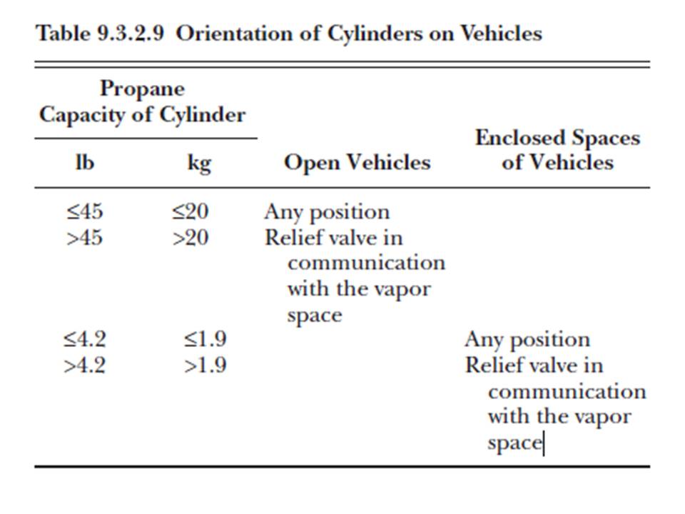

NFPA 58 ( 2011 Edition ) page 65 section 9.3.2.9 " relief valve in communication with the vapor space" also section 7.2.2.5* valves must be sealed and protected.
Your correct, less then 45 lb can be in any position an greater then 45 lb must be in vapor space. From 2014 edition
Guess its one of those some fill stations will let you lay them down and others say no. Since trucks normally require at least 100 gallons to be delivered, I'll still have mine filled and haul back laying down in back of the pickup

There is no requirement to keep a propane 100 lb. bottle upright. Just don't let it role around while transporting it.

I have taken a 100 pound cylinder in to be refilled several times. Never had it upright, always laid down. No problem what so ever carrying in the FEL bucket while laid down.
