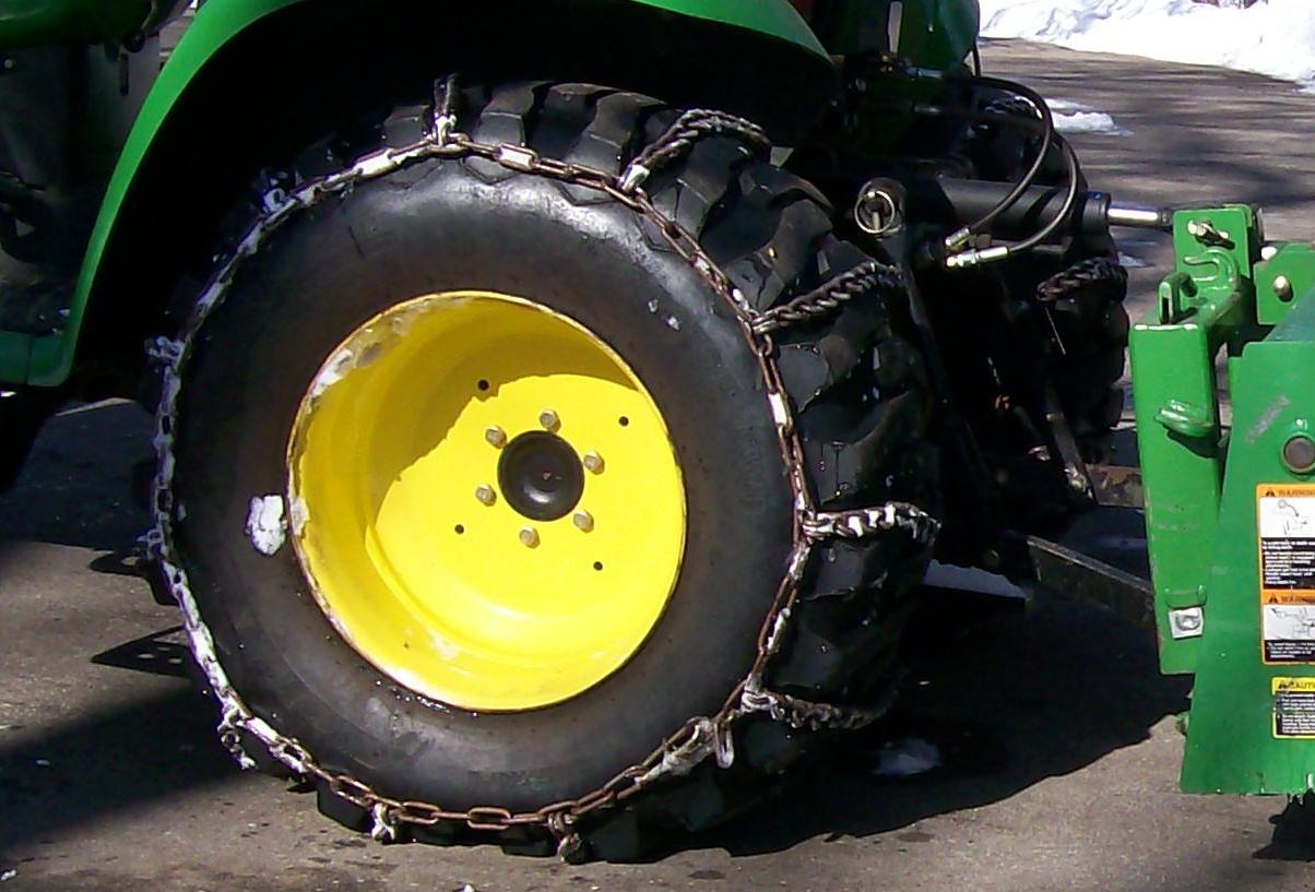

I've run chains for 10 years with the tires turned out.
Now, take into consideration I made up my own chains to fit the tire better than any commercial chains I could find. Longer side chains and shorter cross ladder chains to keep the side chains in the R-4 dip. They work great. Not sure letting the side chains down along the side would have enough room, but figure it was too close to try them. And yes, I did reverse the fronts. Looked a bit wierd at first, but quickly got used to them. :)
Here is a pic of chains.

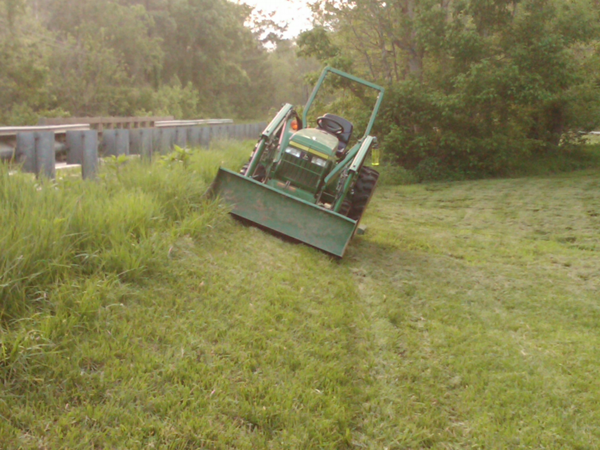

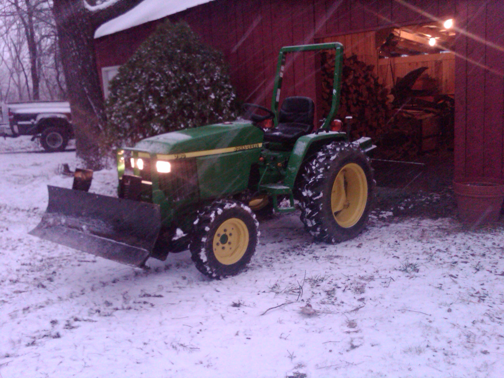

I flipped both fronts and rears. Made a huge difference in my mind.
I think swapping the fronts made a big difference, too. Not so much where the surface of the ground is relatively even.
In some cases, though, the front wheels are not on the same type of surface as the rears, or tilting at a different angle, or loaded differently, and having the fronts flipped makes a difference.
Flipping the tires will require some adjustments in your technique on some 3PH attachments, due to the extra width.
I've had no issues with plowing into turns, other than the normal 4WD feel.
