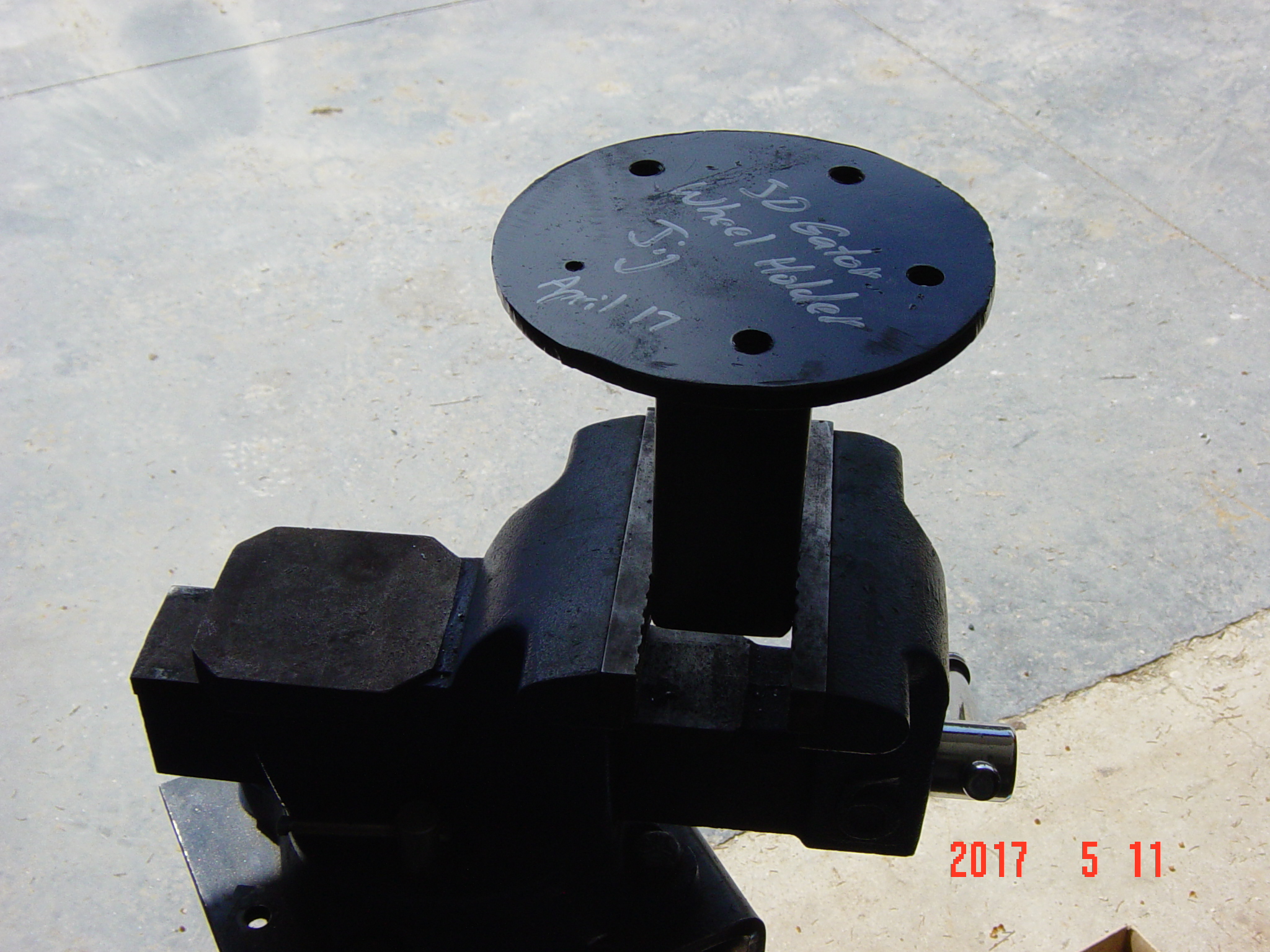

First I welded up a jig with a round plate and two inch tube that I could put in the vice. Tapped the plate 1/2" NC and bolted on the hub. Now the thing wasn't going anywhere. It was just a little high to work on.

The jig to hold the wheel.
I put a plywood washer in between to protect the rim and plastic washers on the bolts.

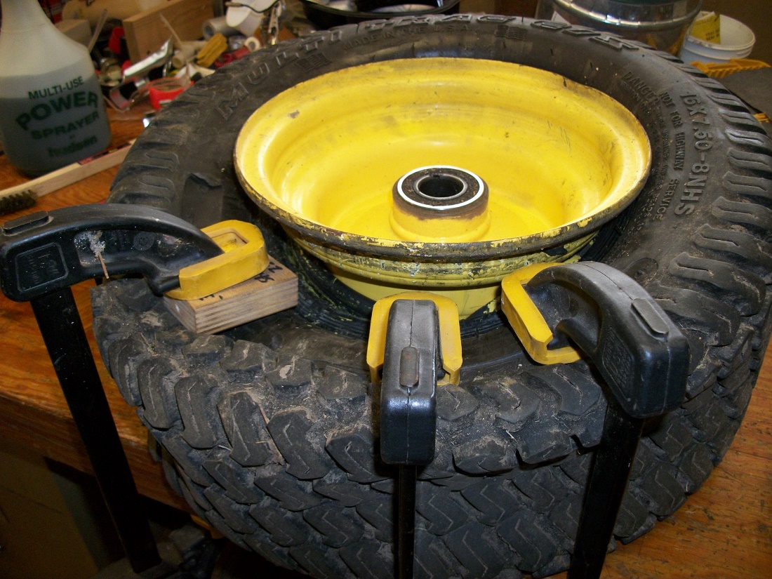

The tire iron I picked up for under $3 was very handy.. good leverage and spoon on the end, as well as smooth chrome-like finish really worked well putting the tires back on the wheels.
Removing the tires was a sweaty ordeal.. but expect that the mini changer will speed that up quite a bit with the bead breaker and long tool.
Pic of breaking the bead with three wood clamps.. not the best.

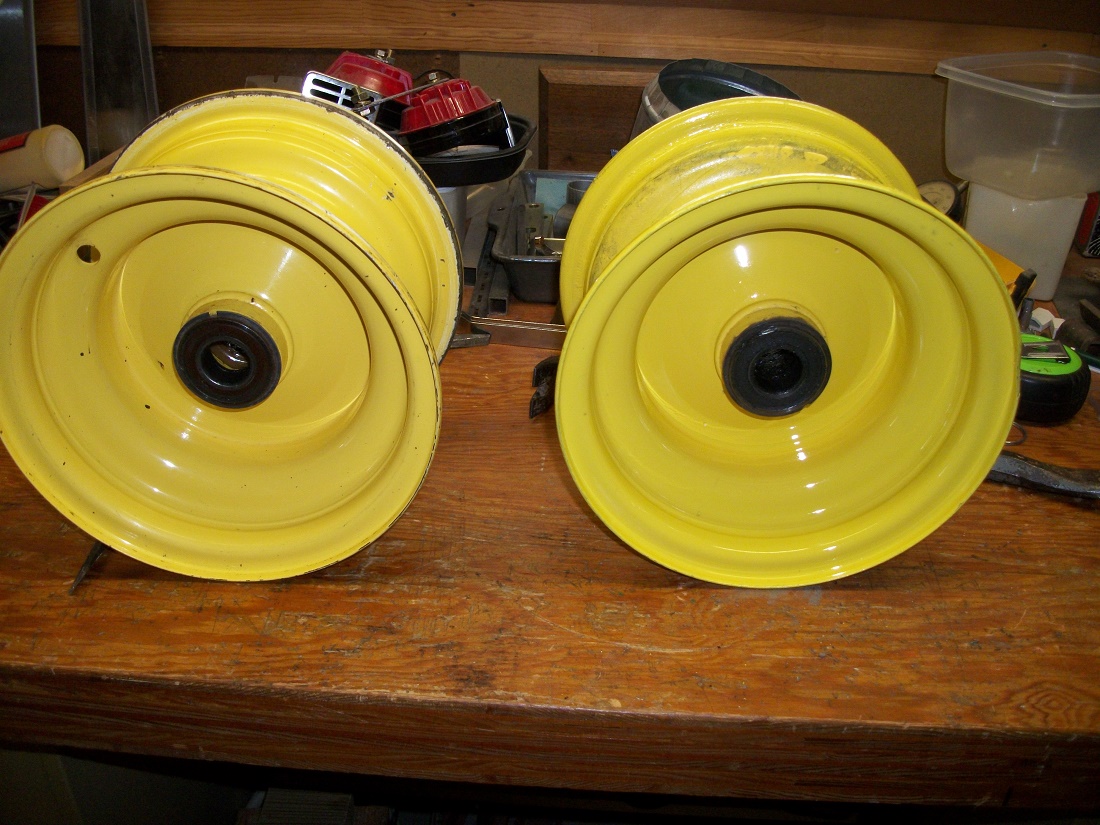

Another of the two wheels after some Deere yellow spray paint and the parts of the changer on the bench. Clamped a part in the vise rather than bolting it to the bench.
