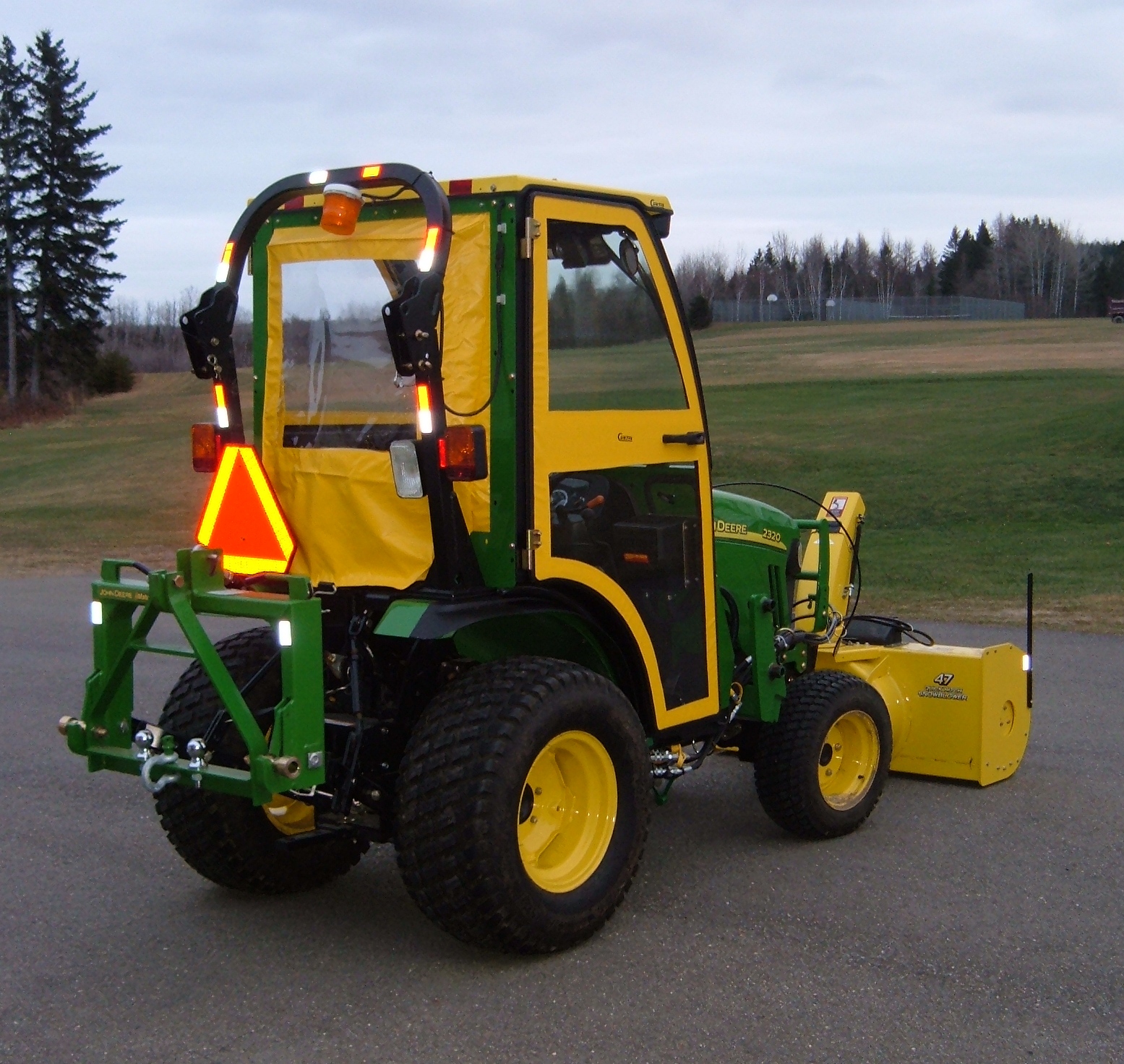

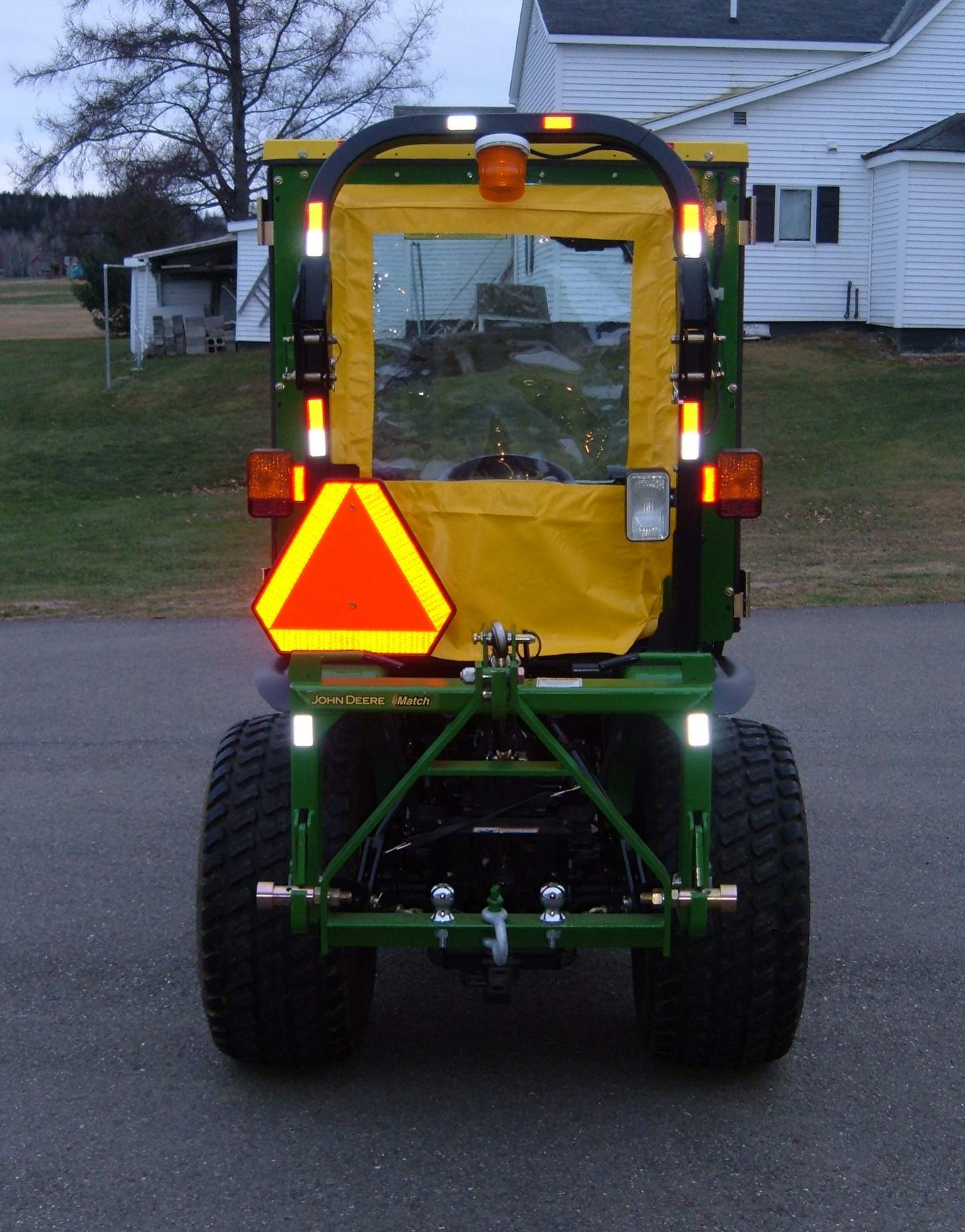

I mounted my strobe on my ROPS with magnets you can purchase at Harbor Freight and Salvage, they are really stong and inexpensive and you can remove them if you wire them with some type of quick connector:)

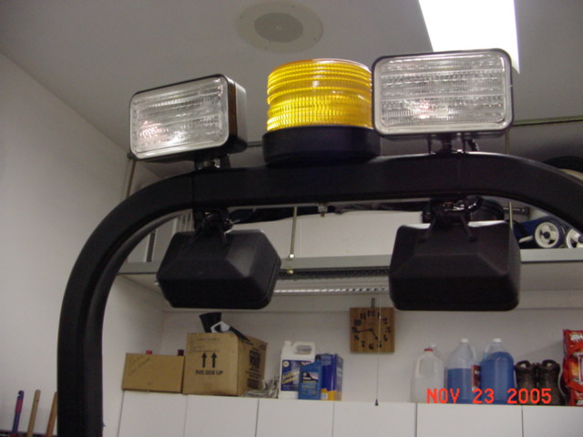

I mounted two to my ROPS with U bolts, the kind with the 90 corners, not the actual "U" shaped ones. I mounted a flat strip of 1/8 steel to the bottoms and that gave me a tab to mount the lights to. Used the JD front light kit and turned one to the front and one to the rear. Will probably add another one pointed forward just to fight the glare from the headlights hitting the bucket. I did have to extend the wires just a little bit and left a small amount of slack where the ROPS folds so it would not strain the wring when folded. Then I enclosed all the sires in that plastic protective tubing for automotive wiring.

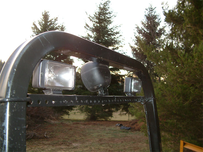

Most guys attach the lights above or below the ROPS as shown here.
I prefer attaching them to the rear of the ROPS
(The Space between where you have the lights)
on a swiveling light bar/Mount the lights to the bar so they can be rotated.
This way they are lower which helps keep them from getting hit by low branches while at the same they are not under the rops where you can bump your head into them as easy as you could if they were under the rops.
With this set up You only need 2 lights and you have lights that will cover a 360 degree area all the way around the tractor.
You can aim both lights forward or to the rear.
Or point one forward and the other one to the back.
You can also aim them in any other direction independant of each other.
I would put the yellow light on the light bar too.
I came up with this method so you could add lights with out having to up grade the low amp alternators.
If you have a high amp Alt.and want to go with 3 or 4 lights that will work too.
