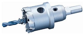

I am fabricating something and am going to add a hydraulic cylinder fro a moving piece.
Do I need to make the eyes that the cylinder will pin to myself or can weld on eyes be bought somewhere?
Making them does not seem that difficult but I don't have anyway to drill a 1" hole for the clevis pins and torching one would likely give some unwanted slop.
   / mounting eyes for hydraulic cylinderr
I did not know those worked well with thick metal?
I have used them a lot on sheet metal but never anything thick. Depending on the style of cylinder I get I will need the material to be 1/2" to 1" thick. Will those saws work on stuff that thick?
Once the pilot hole goes through, reverse the metal plate.
If you have a cutting torch, you can make an circle adapter and cut some descent holes.
You could make a template and cut the circle.
If you cut smaller than your desired cut, then use a reamer for the finish 1 in hole.
I also did some cad drawings and put them on a thumb drive and had a steel mill cut out the 20 tabs with holes.

So a 1" hole then. How thick does the material need to be?
   / mounting eyes for hydraulic cylinderr #8
Just use a good hole saw, run at a slow speed using oil. I would say around 200 rpm's and it well make a nice hole.
#9
1" thick.
I was googling the wrong thing. I was searching "mounting eye" and not having much luck. I searched "clevis mount" and found this. Bumper Clevis Mounts $22.95 for a pair of them.
