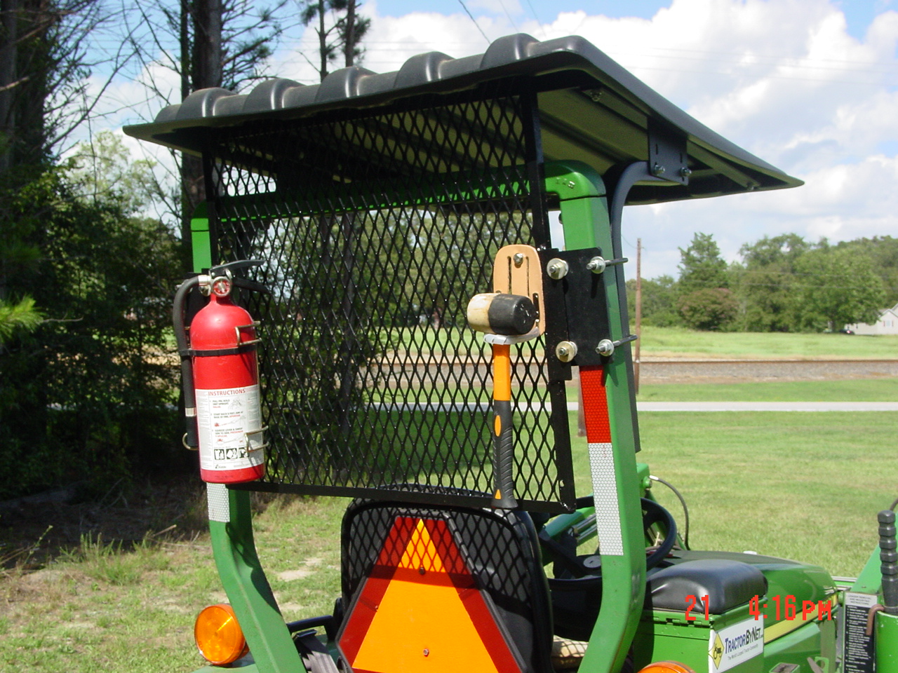

This is where I mounted mine at. The screen is home made, but I was able to bolt the bracket for the FE right onto the expanded metal. Works good, lasts long time!
/ Mounting a Fire Extinguisher #26
Looks like a nice setup Kebo.
ABC type fire extinguishers always handy to have since they pretty well cover most problems.
Get some kind of boot oil or preservative on that mallet holder and it should last a long longer. Leather will dry rot even parked in the shop and your going to get some vibrations and what not stressing that leather. No need to loose or run over a good tool.

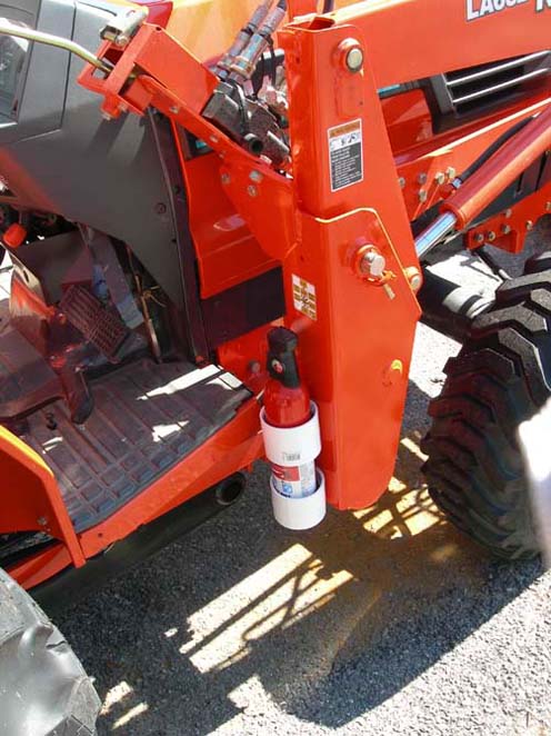

I have mine mounted inside one of those paperwork containers that Frontier gives us with every implement. The cut down container is bolted to the front of my right fender on the 2025R.
Ralph
