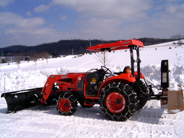

There. I like to think that this is my own innovation.
That is an Eight Foot "Frink" blade. Also a $150.00 auction find. It has a trip edge that I am having trouble with. The edge trips too easily and then the machine (Kubota R510 wheel loader) just slides sideways if there is ice under the snow. Most annoying. I have chnaged some of the springs but have more to do. A real PITA![

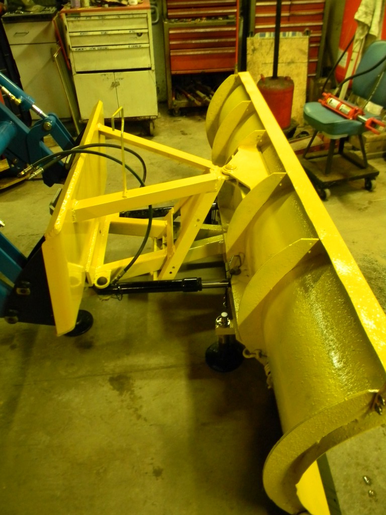

I have a truck plow mounted to a SSQA plate but with a difference. I built a frame to mount the cylinders as far back as possible rear of the plate. I have never liked how far out most tractor mounted blades are. With the loader and snow blower, that is already a very long unit, and now a plow sticking way out the front.
I tried uploading a picture of what I am talking about, but it simply would not work.
If I am picturing you setup correctly, the A frame actually goes under the quick attach?

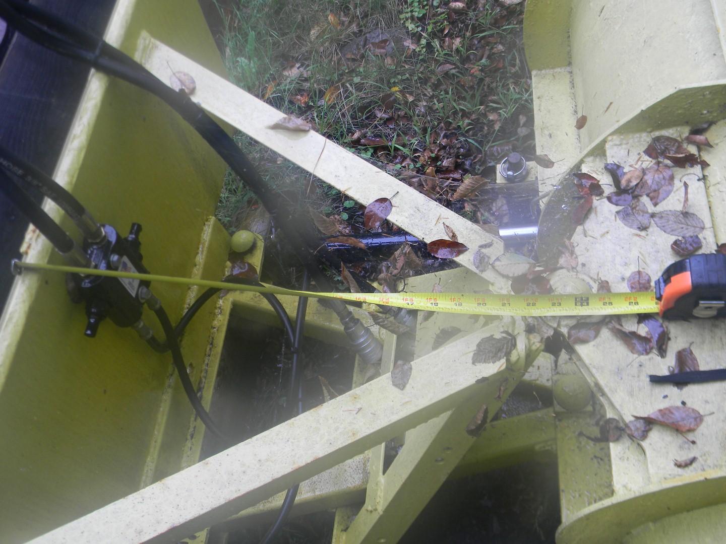

I was concerned about a plow sticking way out too. Mine is only 24" from the back of the QA plate to the pivot pin. Full PA left or right gives me about 4-5" between the blade and QA plate. Any further back and it would come close to hitting.

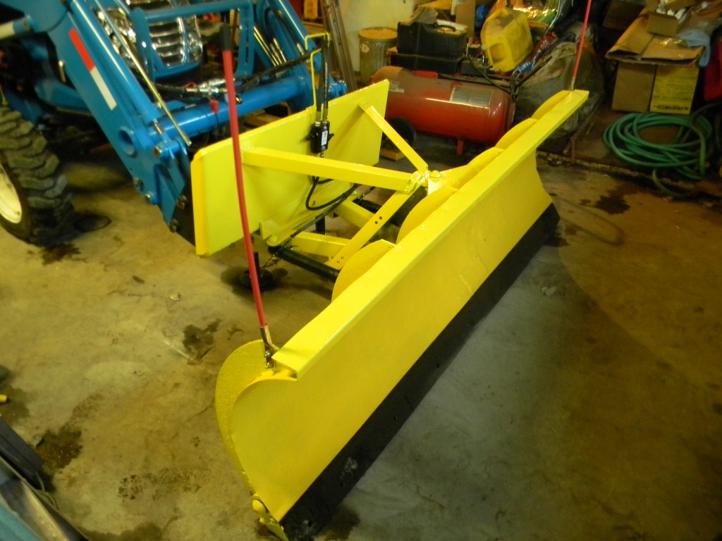

Bradbilt, my plow was an old Diamond brand plow. Here's a link to my build.
http://www.tractorbynet.com/forums/build-yourself/323978-snow-plow-build.html?highlight=

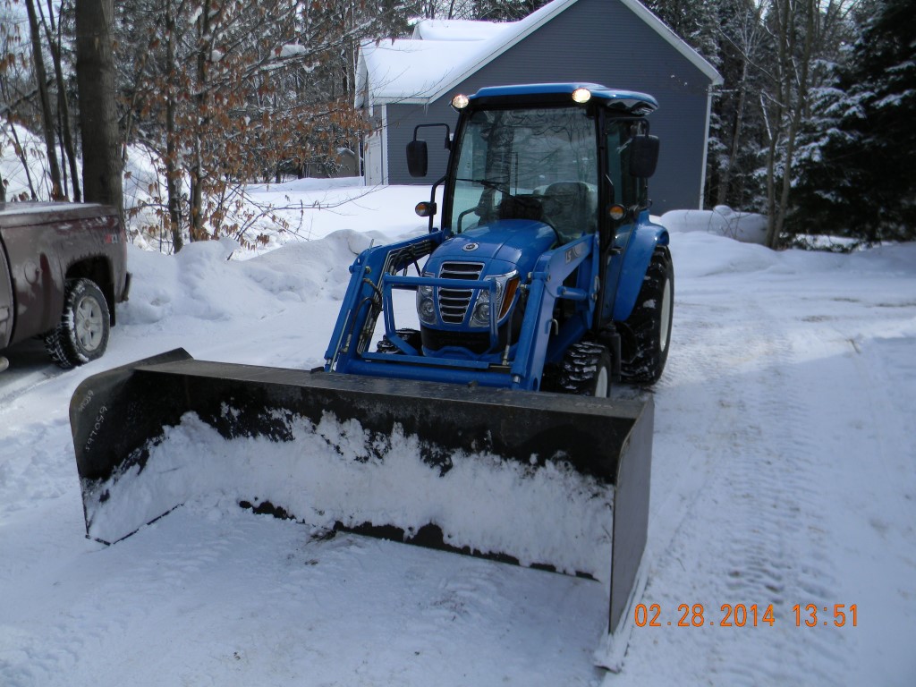

I know you said you can't use one but I just added a pic of my snow pusher.

Thanks George. I didn't even think about shortening the A-frame. That would make it even easier

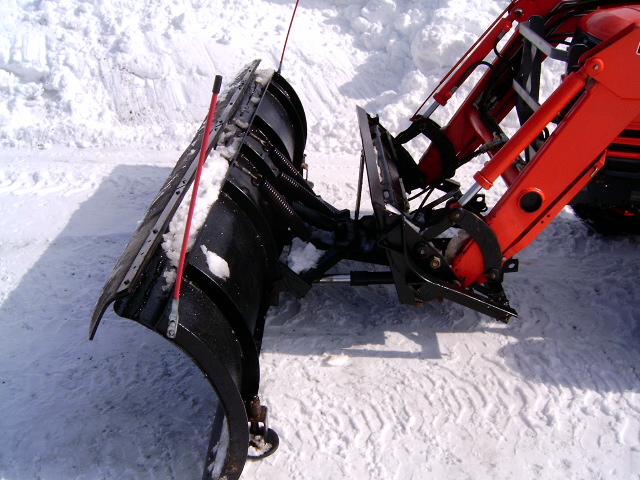

Here is my setup.
9' Western snow plow using a 5/16" QA plate.
Solid mounted, no chain (works fine for me, I never float the FEL, I simply set the loader down till it touch's the ground and go)
The A frames goes under the loader arms to keep the blade closer to the loader
