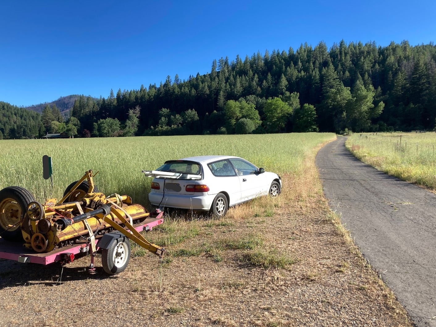

Some of you may enjoy the photo below: my wife took the truck for a long weekend and I needed to get it to the field where the tractor was

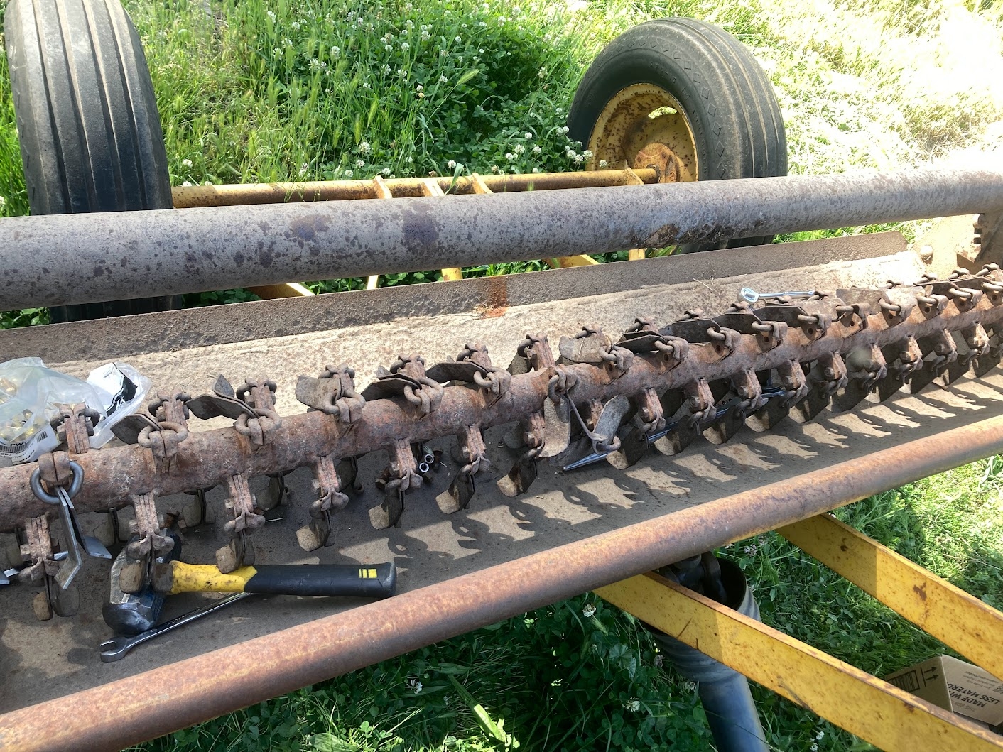

Can you post a picture of the rotor where the knives attach?
What little bit of it shown makes the spacing of the knives look like the non fine cut version.

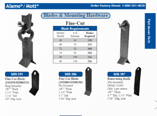

Here it is while I was switching it over to new flails. Based on the Flail-Master catalog, I spec'd it as fine cut: 92 stations, 184 blades. Mott PN 101993 for the flails, which I bought from R&R products (PN# R400515) because they were a better price than flailmaster. Every flail was replaced, as well as some missing D-rings, so everything should be well balanced. I'm going to run out there today and check again for play in the bearings, but everything was well lubed and smooth while I was servicing it (flipped upside down).
If I can get it running, it will be perfect for managing cover crops and chopping the chaff from my small wheat operation, but I can't have sparks like that in August when I'm running it over the windrows of dry chaff. Thanks for any help folks can share

Whoever owned this Mott flail mower abused it and made a mess of it as
the knife mounting stations are all screwed up!!!!!!!!!!!!!!

The rotor is unbalanced and the tire and wheel assembly on the left in the
picture is damaged/bent.

Thanks for the reply, will you please elaborate? How are the knife stations screwed up? That photo was in the middle of me replacing the flails. Now they are all new, so they should be balanced, right? And by tire and wheel assembly, do you mean the belt drive? everything is well lubricated, moves smoothly, and the height adjuster cranks well. The drive shaft from the pto spins freely and well when the belt is disconnected. But yeah it was an old machine that lived down in a canyon for the last 50+ years

Thanks for the quick response - The drive pulley from the pto as well as the rotor pulley all appear to be in good condition, and in-line with the idler, if that's what you mean. But I will double check that today and take some photos. That would be something if the D-rings are incorrect. I was going off of the original (which I doubt had been replaced), as well as this photo from flailmaster for the fine-cut setup. Can you describe what it should be like?

In your original photo please look at the right side of the photo.
The 7 or 8 knife mounting stations on the right side are different
and would cause it to be unbalanced.
Please upload more closeup pictures of the flail mower rotor.
I am also worried that the left rear wheel is bent on the cross shaft.
