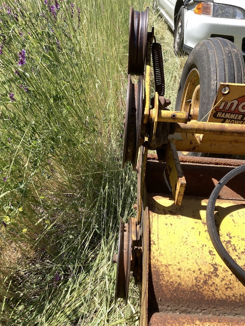

Just got back from the field and it appears to be a bent cutter shaft. I checked with a magnet indicator and it was out at least 1/4" in the center. so I pulled the cutter shaft and I'm going to try and straighten it in the shop. Any tips are appreciated.
The bearings had no slop before I pulled the shaft and inspection after pulling the bearings shows no damage or play. I might get some replacements because it seems an easy swap but I need to get up and running quick as possible to get this field mowed...
If by rear wheel shaft cross shaft you mean the shaft between the pto gearbox and the first drive pulley, that does not appear to be bent. The pulleys appear aligned (idler pulled up out of the way in the photo)

If your rotor is out of round by a 1/4" or more you have found your problem.

It would be much simpler to take the flail mower rotor to a drive line shop as they will have a high speed balancer and the press to correct the out of round condition which is what you need.
