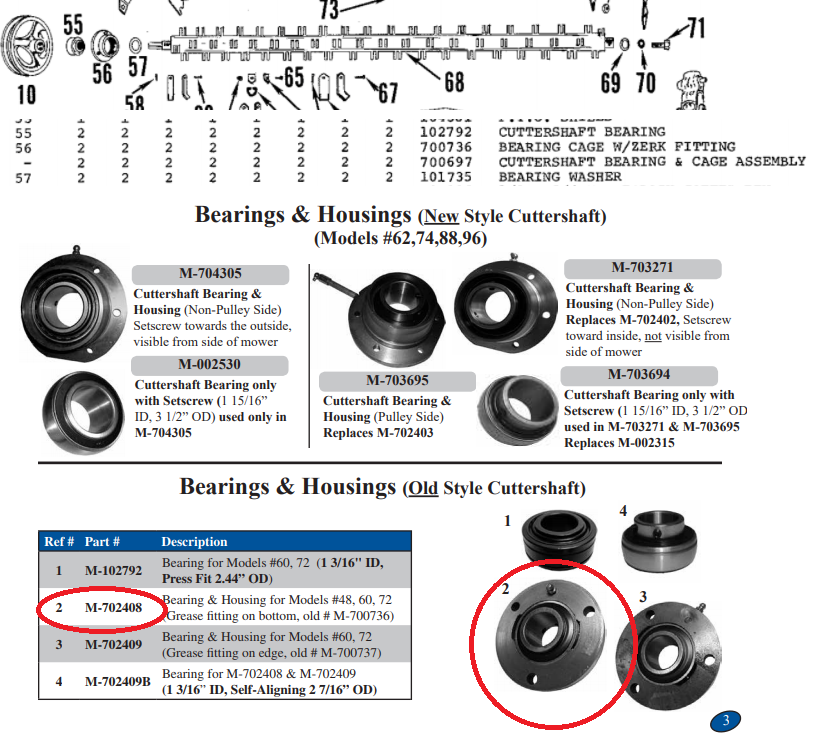

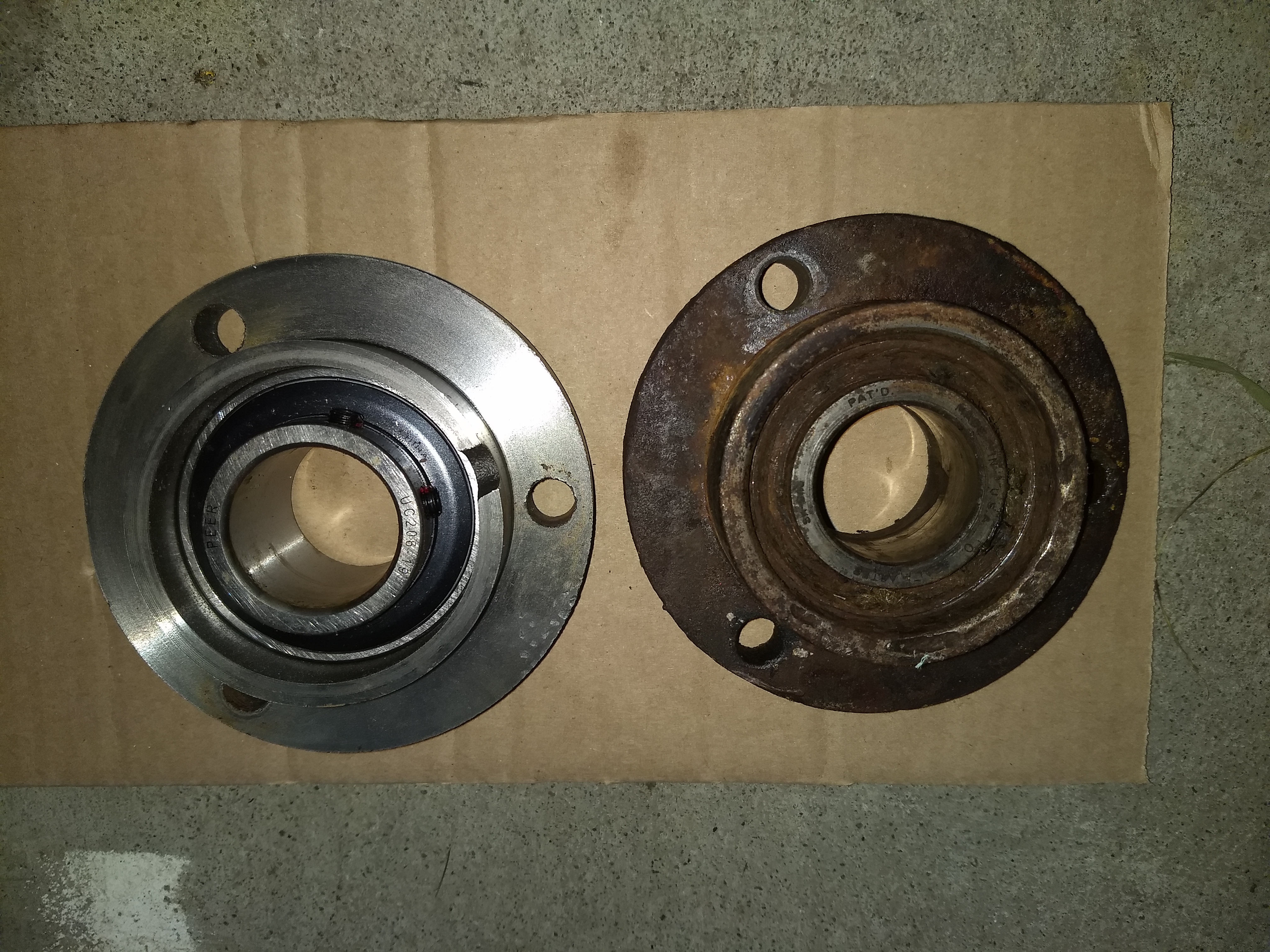

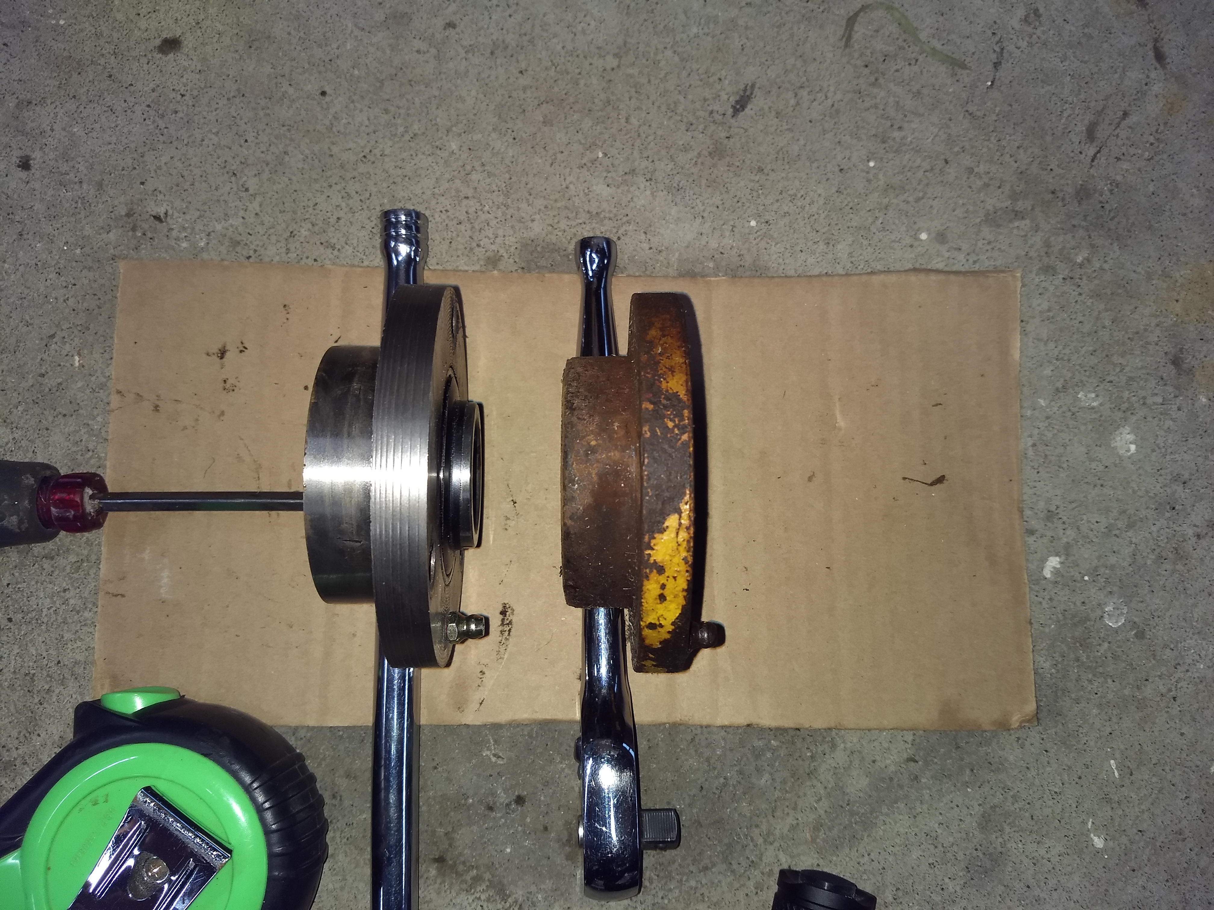

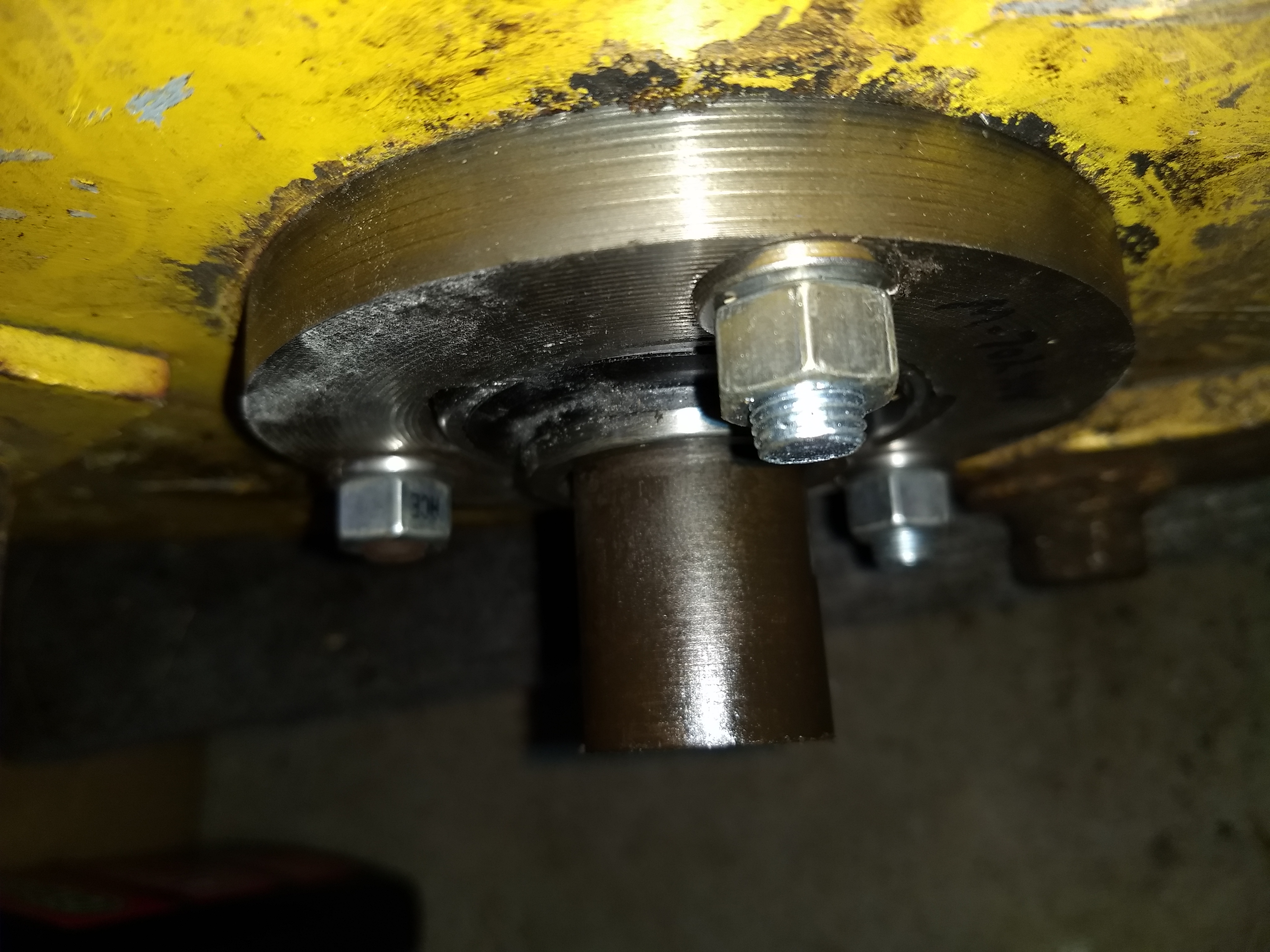

Good Evening. I have an old Mott 72 flail which needed to have the cutter shaft bearings replaced. I ordered a pair of the M-702408 bearing + housing combos from Flailmaster. Housing itself looks the very similar to the old one, with three bolt holes that line up great and grease zerks on the housing face. However, the face that mates with the pulley sits proud compared to the old bearing.
This first picture shows the original bearing & housing:
And the new one mounted to the flail on the drive pulley side.

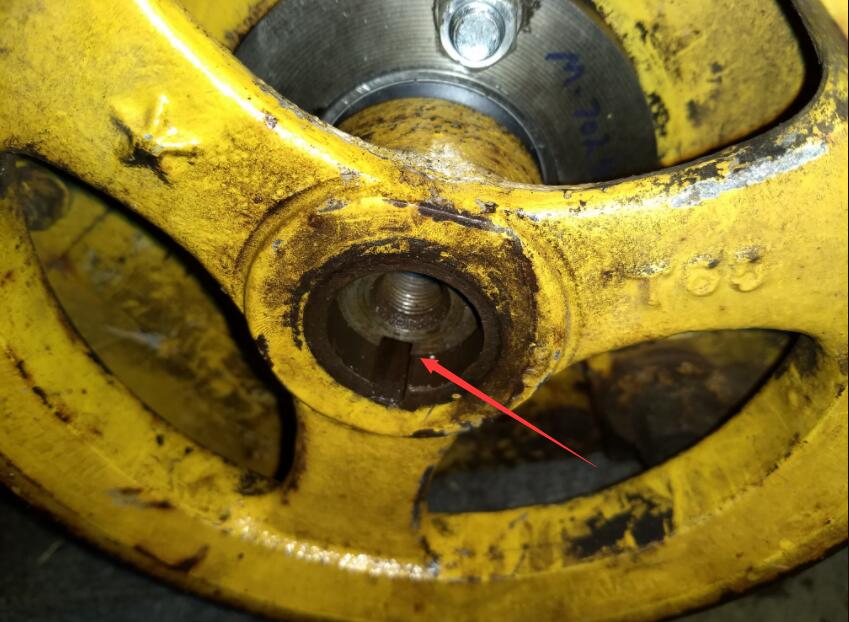

And the step of the process where I realized I had a problem. The shaft itself no longer goes all the way through the pulley:
I'm sure it's something I've done. Before I took it apart the shaft was pretty much dead flush with the outer edge of the pulley.
The cutter shaft doesn't seem to be shifted left to right. The first set of knives on each side are spaced evenly from the mower sides.
The bearings are supposed to come fully pressed in, but I suppose I don't know if its actually bottomed out against something in the housing.
Really wrenching down the bolt that holds the pulley might gain me smidge, but I don't imagine it'll be enough for the shaft to go fully through the pulley.
Any advice is much appreciated!

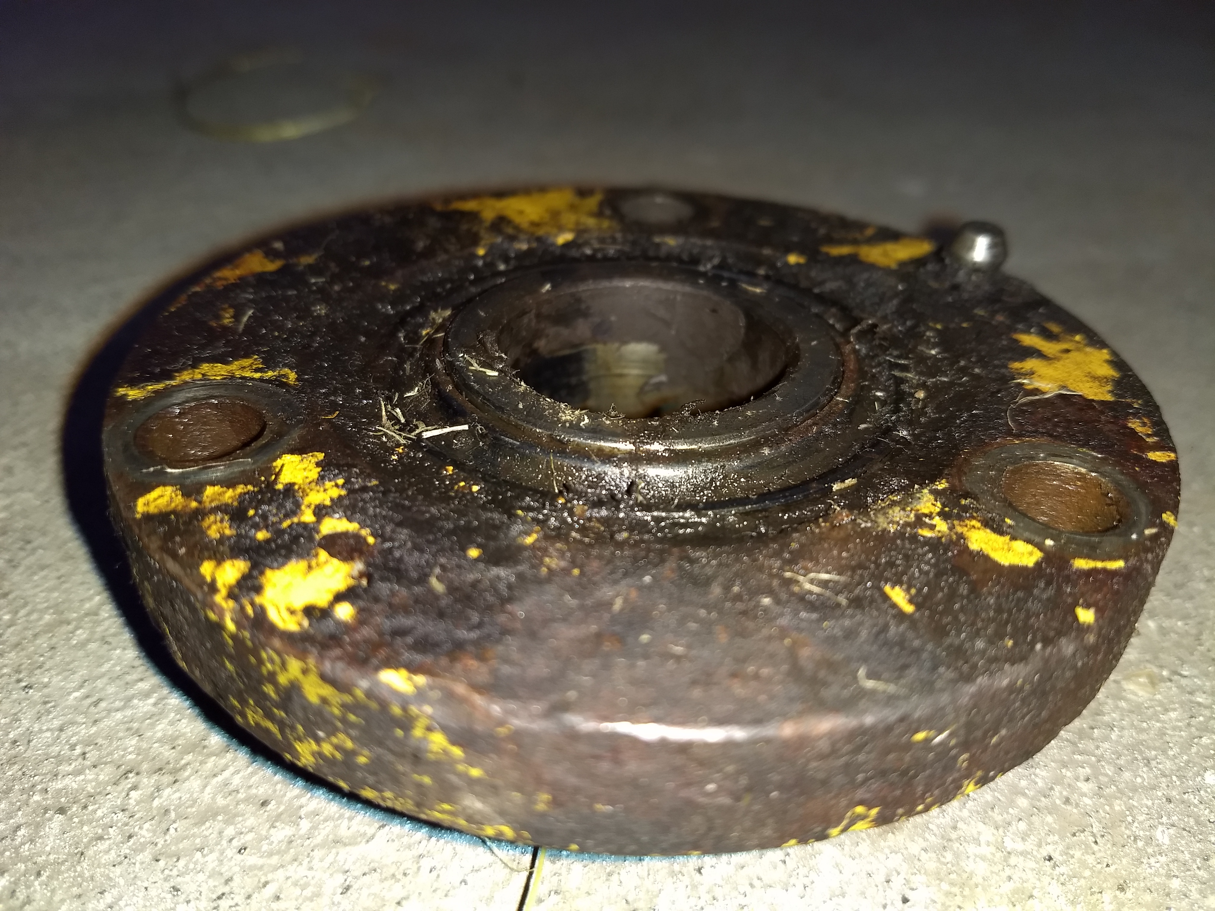

According to the third photo, this mower shaft end use key to mount the pulley. So after some years working, this area shape should have been changed. It is metal fatigue, quite usual. I suggest you use ruller to check if it is still perfect round, I guess its outer diameter has been changed, so you cannot insert this old shaft into a new pulley. QQ截图20180422071814.jpgQQ截图20180422072142.jpg
If it is not round, then cut somewhere if necessary.
I suggest you to get help from Mott engineer, manufacturer engineer should know what wrong it is.

I'm putting the same pulley back onto the old shaft. Only change is the bearing and housing behind the pulley. Without the new assembly, the pulley sits flush with the end of the shaft and the let for fine. The new bearing assembly stops the pulley from going far enough on to sit properly.

I'm going to go out on a limb BUT have you mic'd the old bearing housing?

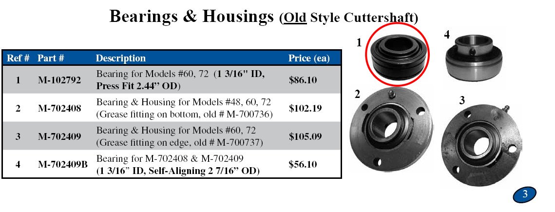

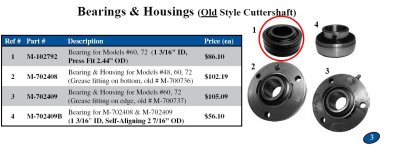

#1 in the drawing below looks more like the bearing I have on my Mott 72.
   / Mott 72" Flail Mower bearing replacement & drive pulley spacing #25
Check the bearing PN in the parts manual and you will see that it is 102792. I think they put the wrong bearing in the right housing. You could get by with the grease fitting on top.

The longer hub that is in the bearing set that was sent to Zumdahl for his Mott Flail Mower is the incorrect open bearing and bearing flange mounting for his flail mower and that is why the gap occurs on his driven pulley.
Added to that the resulting gap will prevent the V belt drive from running true/linearly as the "True" center line of the drive and driven pulleys "X" axis will no longer exist.
They sent Zumdahl the wrong bearings in the wrong housings. The open bearing sets are a slip fit bearing that are restrained by the end bolt on each stub of the flail mower rotor in combination with the bearing washer that compresses against the inner race of the open flange bearing that are bolted to the side weldments of the flail mower.
The stepped hubs of the flail mower rotor act in concert with the inner races of the open bearings nesting together to hold everything in place once the bolts are torqued into tension and held with Blue Loctite.

They need to exchange them with him at no charge.
