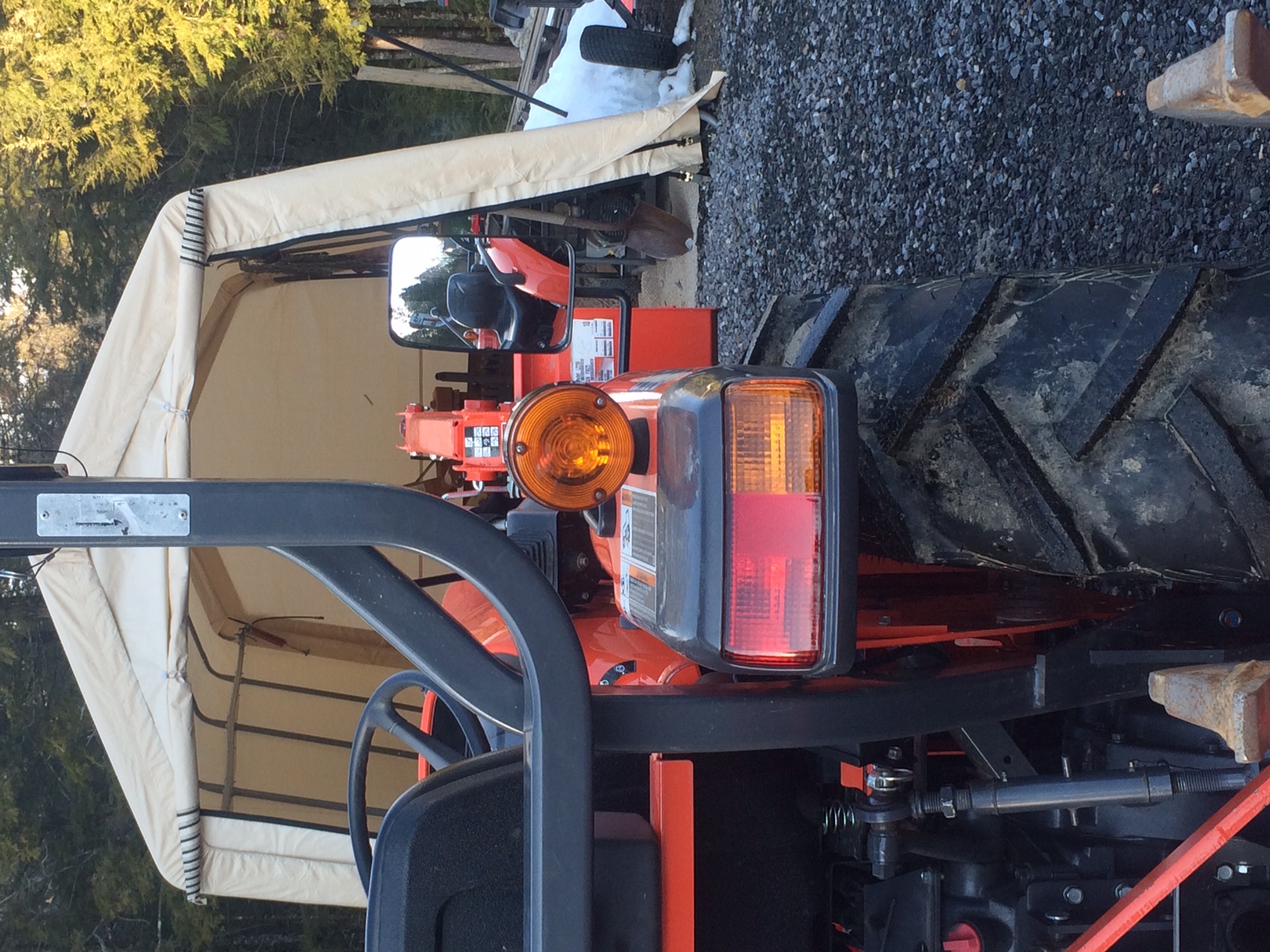

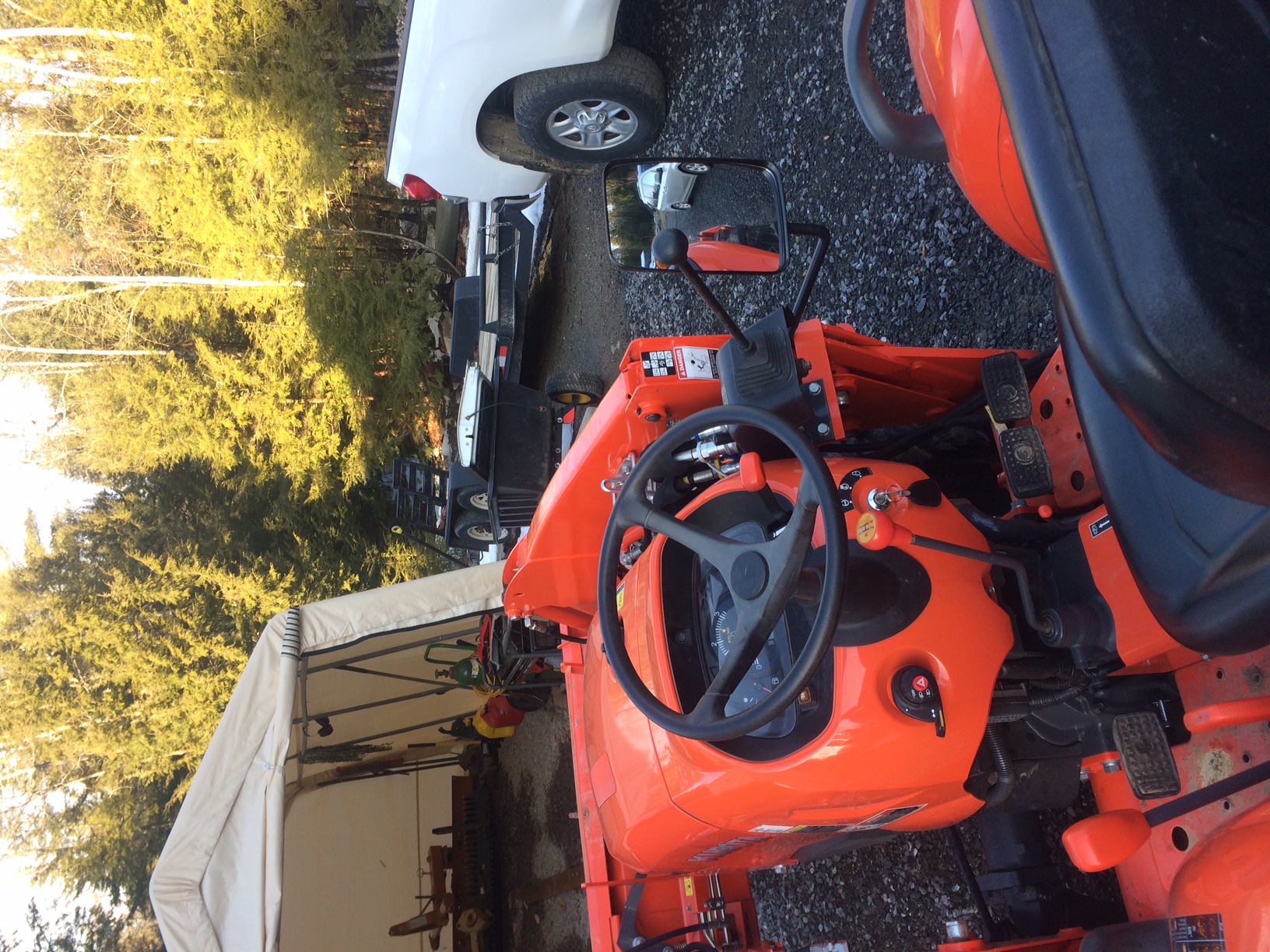

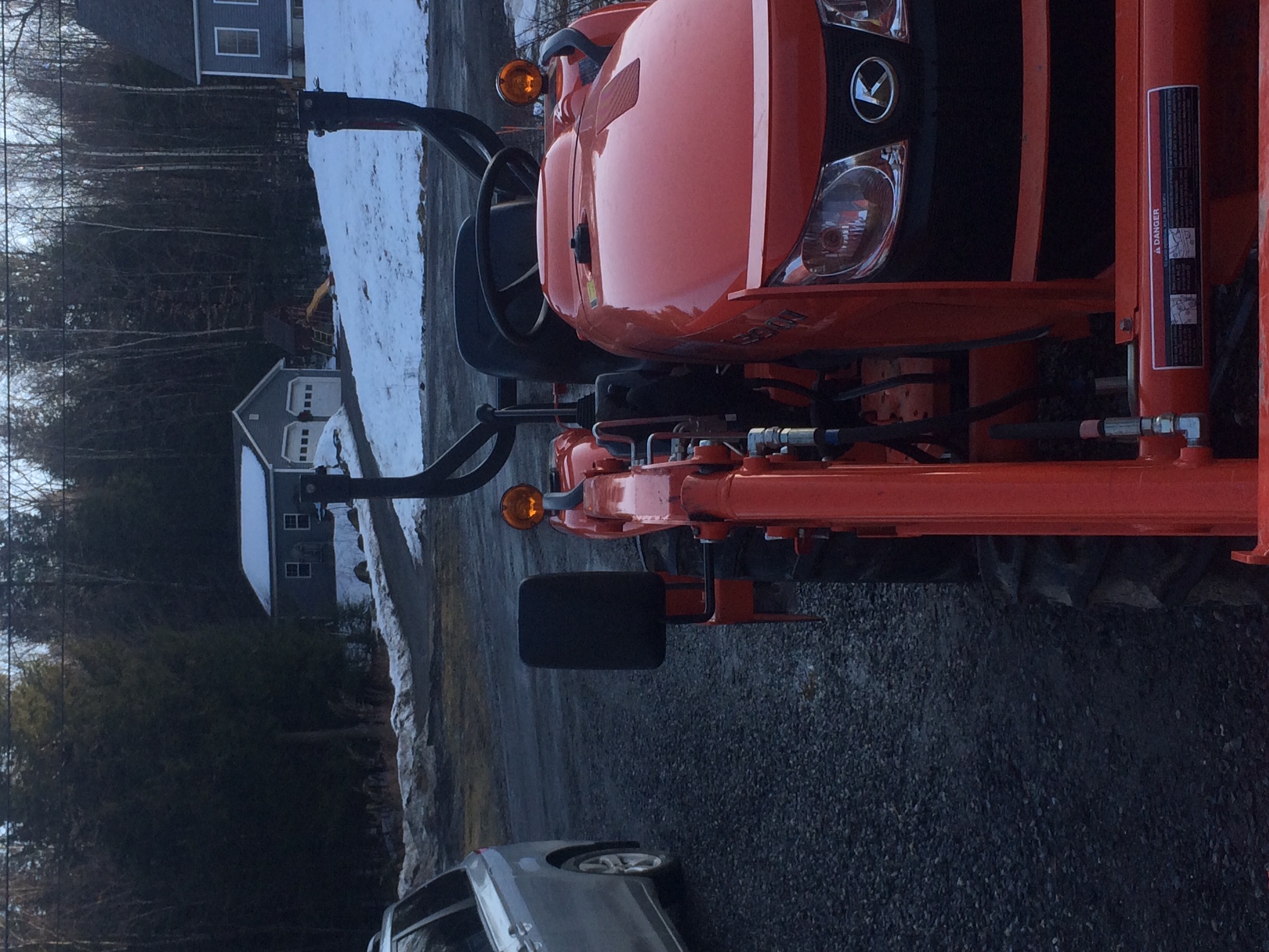

How do those attach?
Would you be able to show details there?
I'm wondering if we could use those on our baby tractor.
Thanks,
Thomas

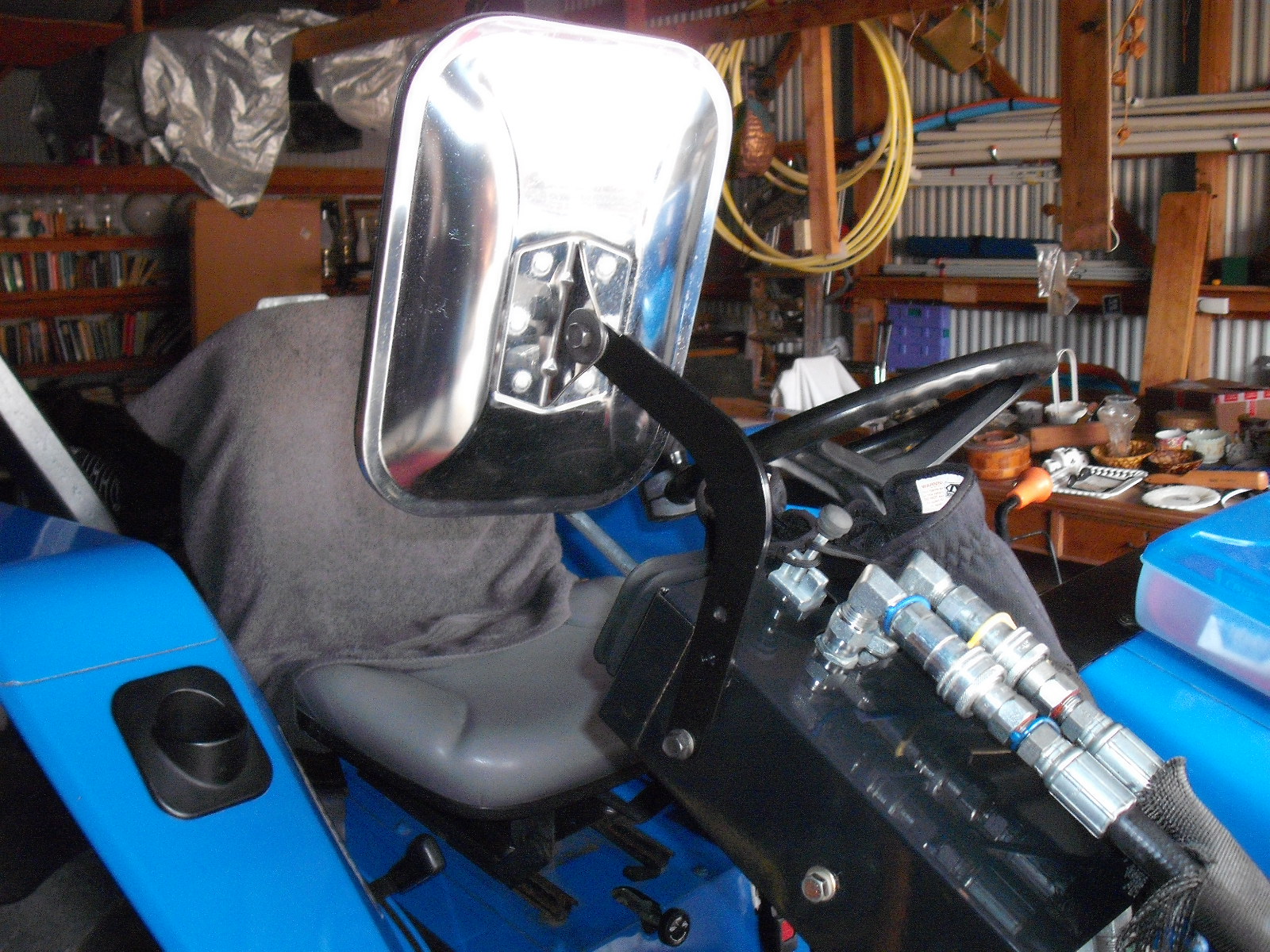

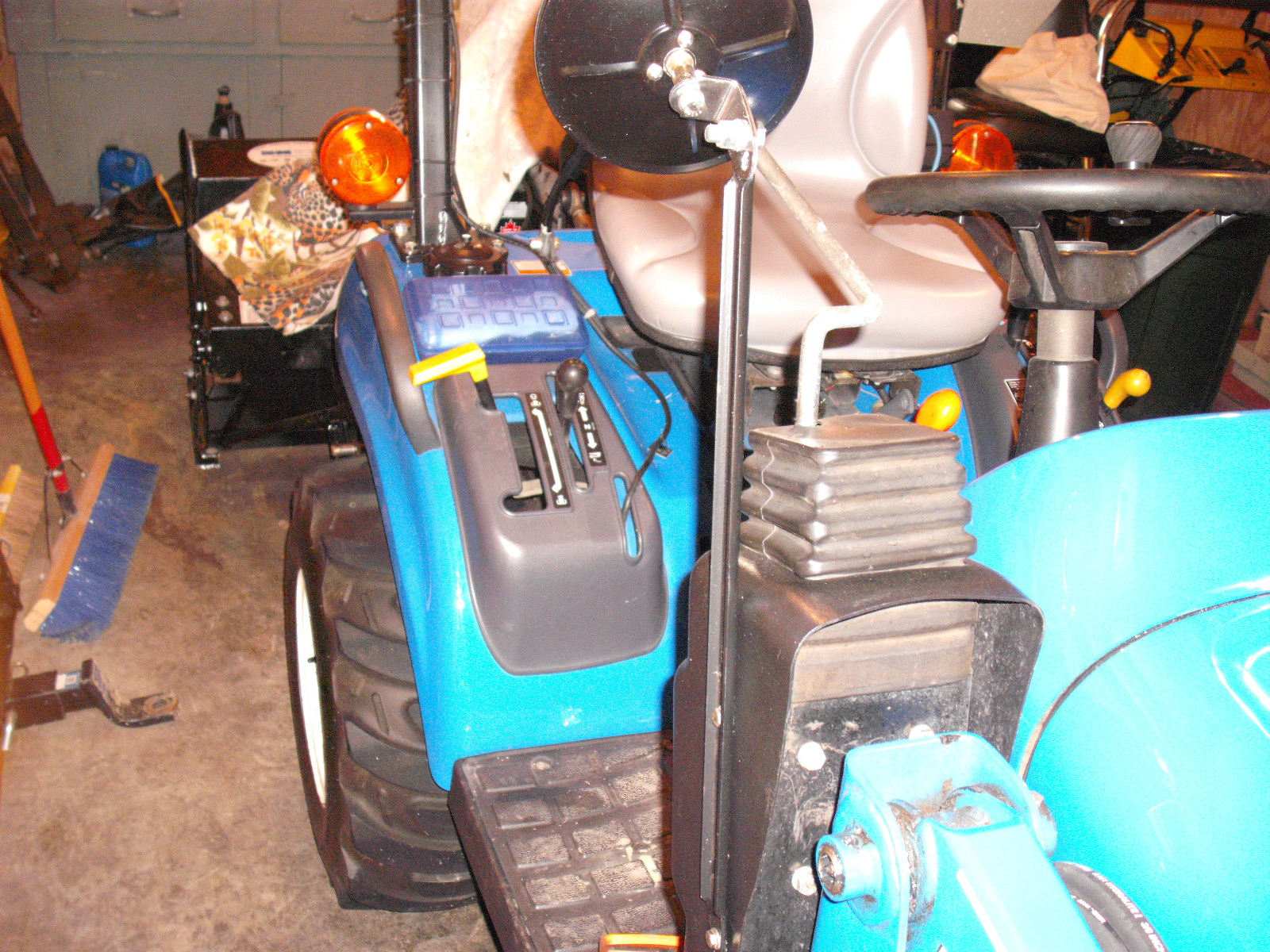

To be honest, they aren't attached yet, just mocked up. I bought all the mounting hardware for them and just need to build the tube mounts to weld to the loader mounts. I've been wanting mirrors since day one but didn't like the cheap mirrors that everyone uses. I prefer to keep everything kubota as much as possible. I'll have a build thread on my tractor at some point with more details. Im hung up on the left side mirror though.

Is it OEM, or an add-on?
I am wondering if I could add them to our loader for the same reason, and whether it would work on it...
They are OEM.
If adding them, I think you might need to move the upper cylinder mount point up or use a shorter cylinder to account for the changes in geometry.

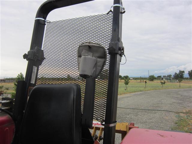

Add a safety screen to your ROPS to protect your backside when mowing. It's easy and inexpensive. A piece of expanded metal screen and four hose clamps. Also a handy place to hang a magnetic cup holder.

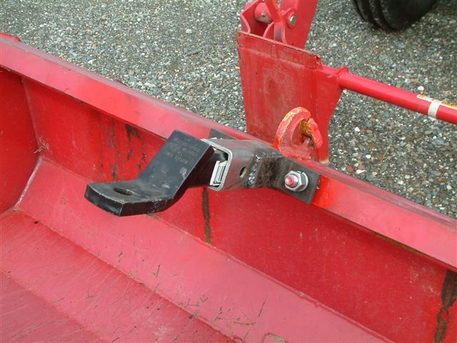

Also, add a 2-inch receiver hitch to your FEL bucket. Just weld two 5/8" bolts to the bucket and weld a plate with two matching holes to the receiver. Makes it easy to attach things like my 10-ft wide weed wiper.

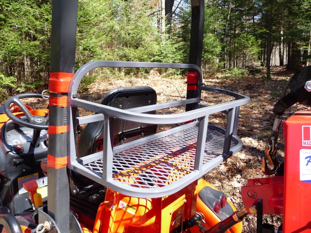

A rear steel basket (chainsaw ready!)
