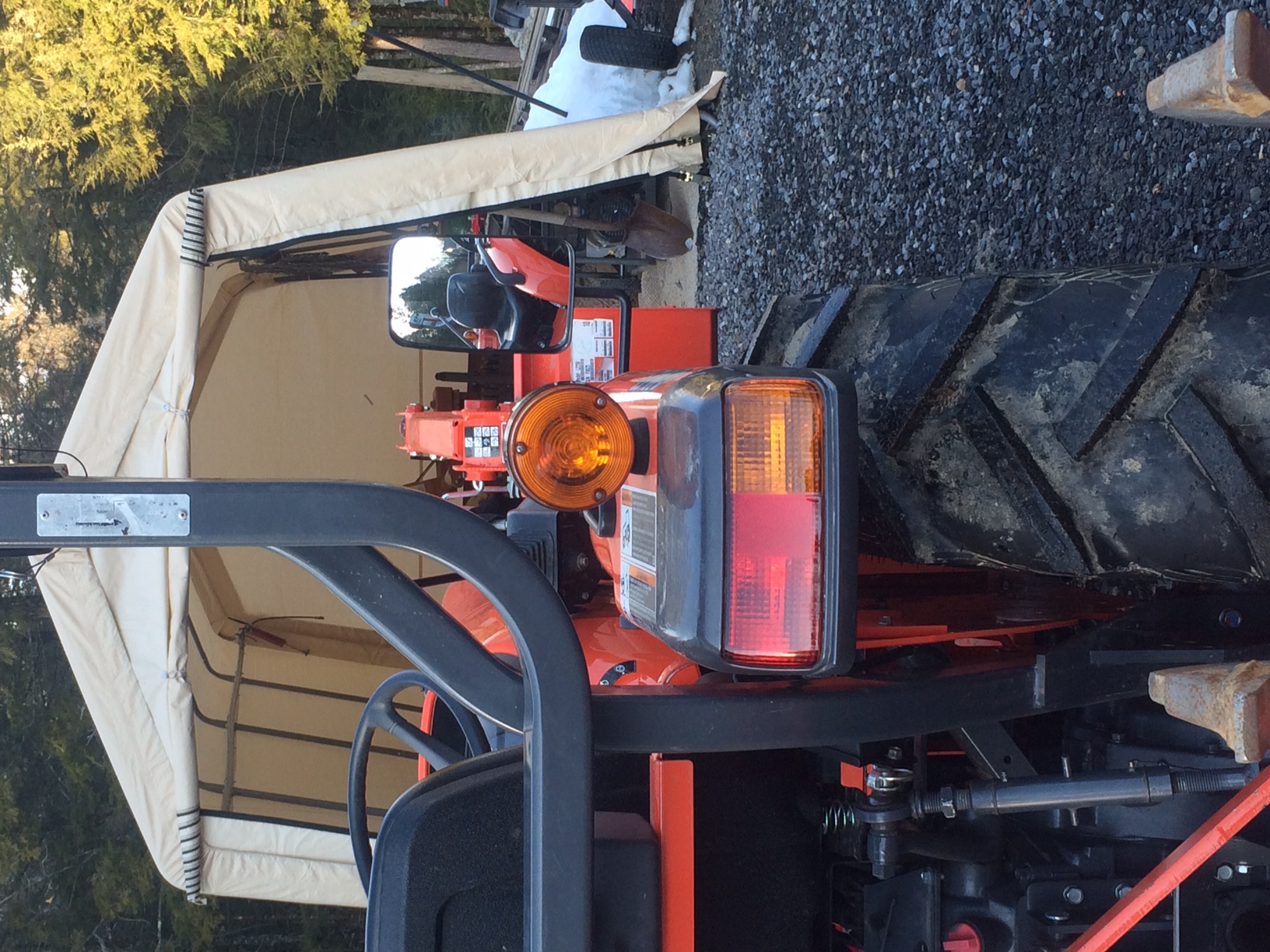

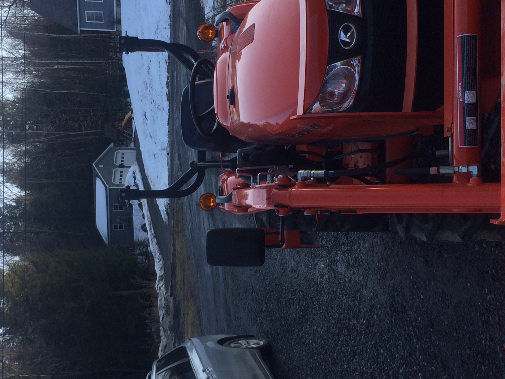

Here's one of my most useful mods I'm working on. Kubota Grand L cab mirrors on a kubota l3901. Will help a lot with not having cars sneak up on me while box blading my road.
