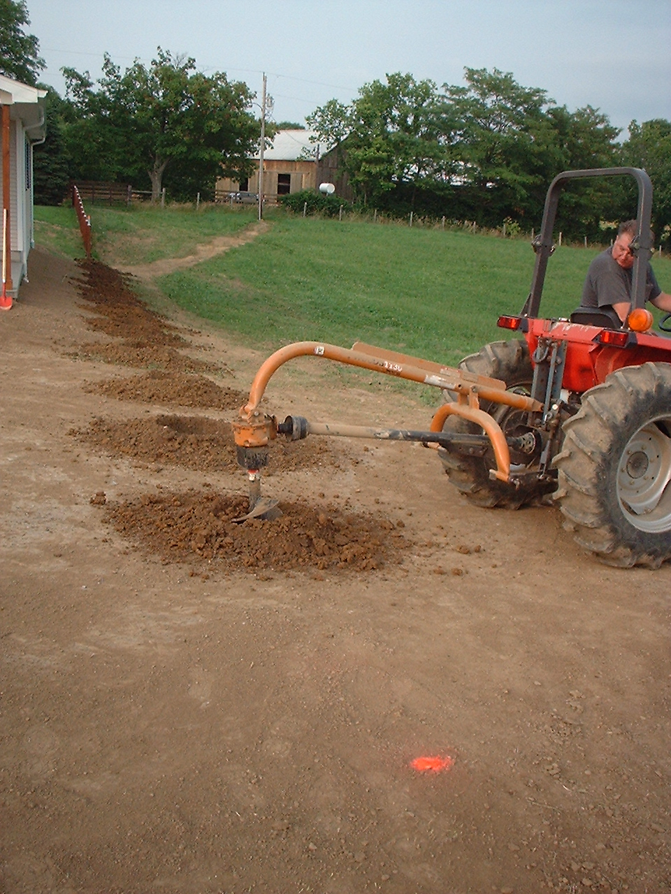

The 3ph post hole digger helped a lot, now if I can figure out a better way to tamp around the posts...
Just pick up some gravel or crushed rock. Dump some around the post and wiggle it a bit. The rock/gravel is self tightening. The more you wiggle the post the tighter it gets. I learned this from the power companies in our area. They only set power posts with crushed rock.

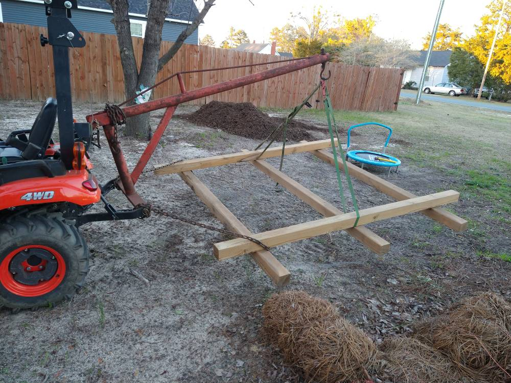

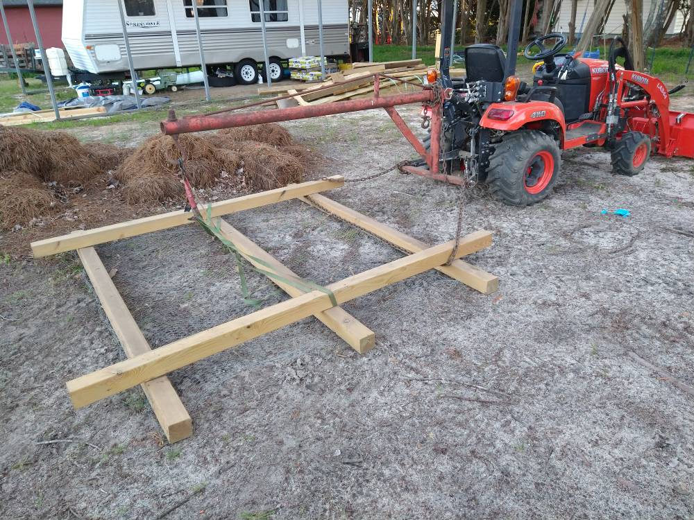

Two thumbs way up for the boom pole in conjunction with the drag. Now I can use it in forward and reverse, and at the end of a run if I lift it it would sweep back and up and feather any material piled under it nicely.
