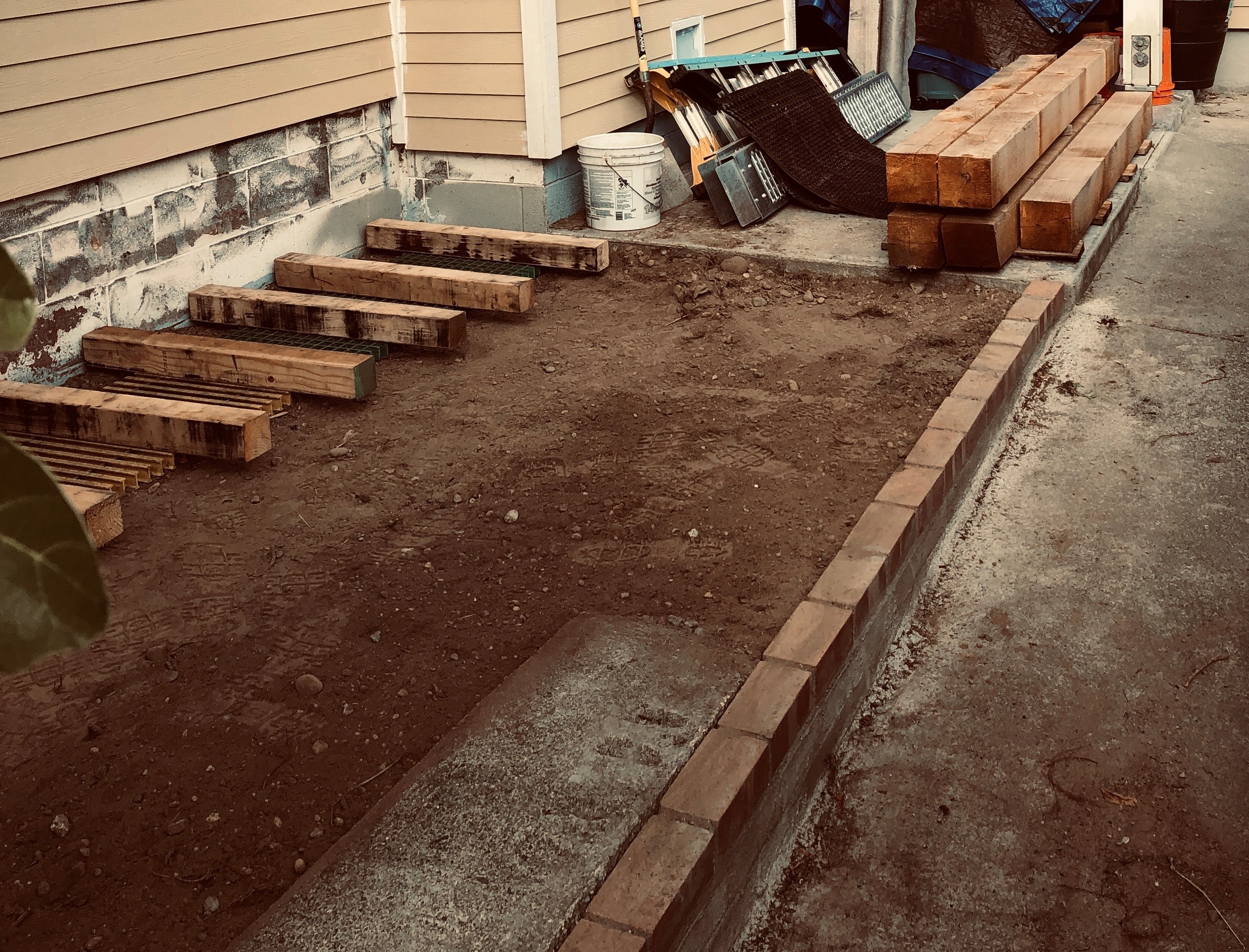

All: I buy concrete bags cause here in the city if I had a pile of sand sitting there the cats and maybe other critters would love me that I gave them their own private crapper. here's a small maybe 4 level of bricks I installed with just Portland and Sand and if it's not straight or perfect it's more operator error than the mud. it's solid and seems to work ok and best of all my bride is happy with it cause it's holding up her new garden area that used to have treated 6x6's i installed 25 years ago. I need to use her new garden area for cutting and staining the new cedar fence this spring so maybe she'll have our veggies growing there in 2021.
