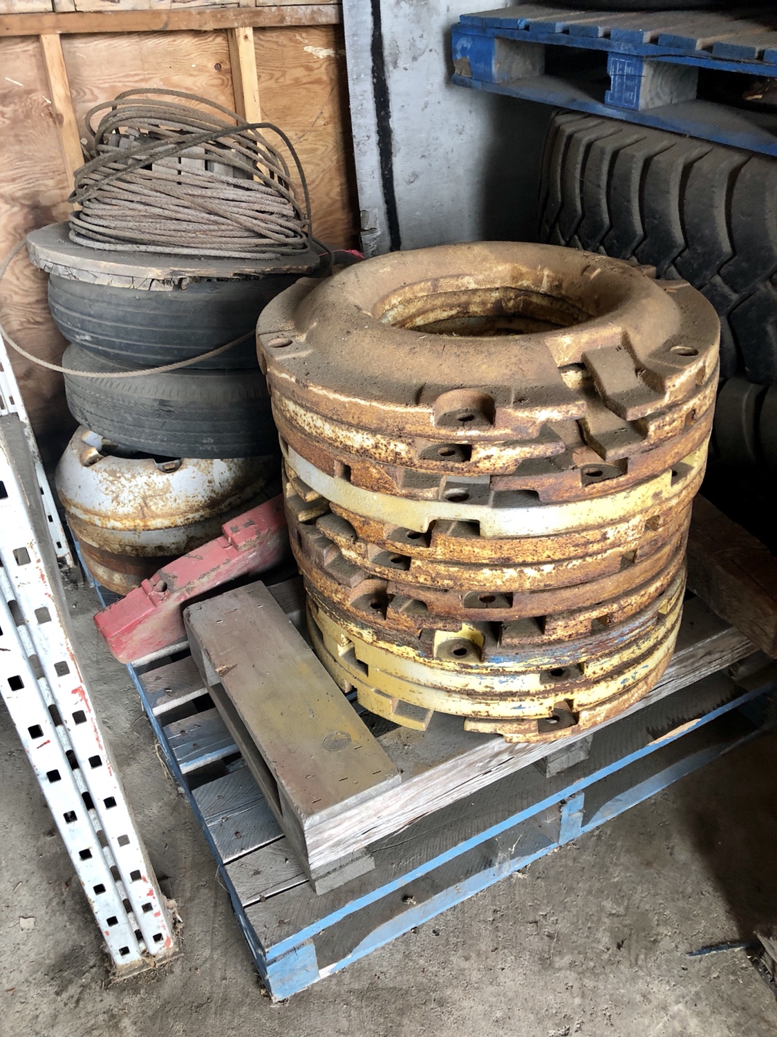

My suggestion would be to search Craigslist (or?) for used cast iron tractor wheel weights.
That way you can add or deduct whatever weight is necessary to achieve implement penetration.
Most modern implements aren’t designed for extra weight. No point in fatiguing your disc unnecessarily as well as consuming more fuel.
I have a pile of them. There’s most likely some in your area.

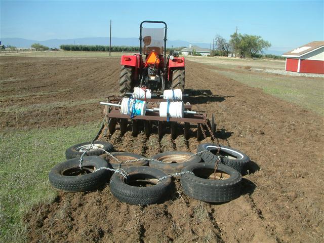

I strap four 5 gallon plastic buckets filled with concrete to my offset disk. About 110 lb per bucket.
Good luck

oosik, I've a disk very similar to yours. I looked at the pictures numerous times and I just can't visualize how you get that blob to sit on the disk?
It seems that the center angle iron that attaches rear of disk to the top link would interfere? If I could figure out how you set that blob on the disk, I'd copy your idea in a heartbeat!
The next time you have the blob planted on the disk, would you "please" take a picture? Thanks much if you can do so. Greg
