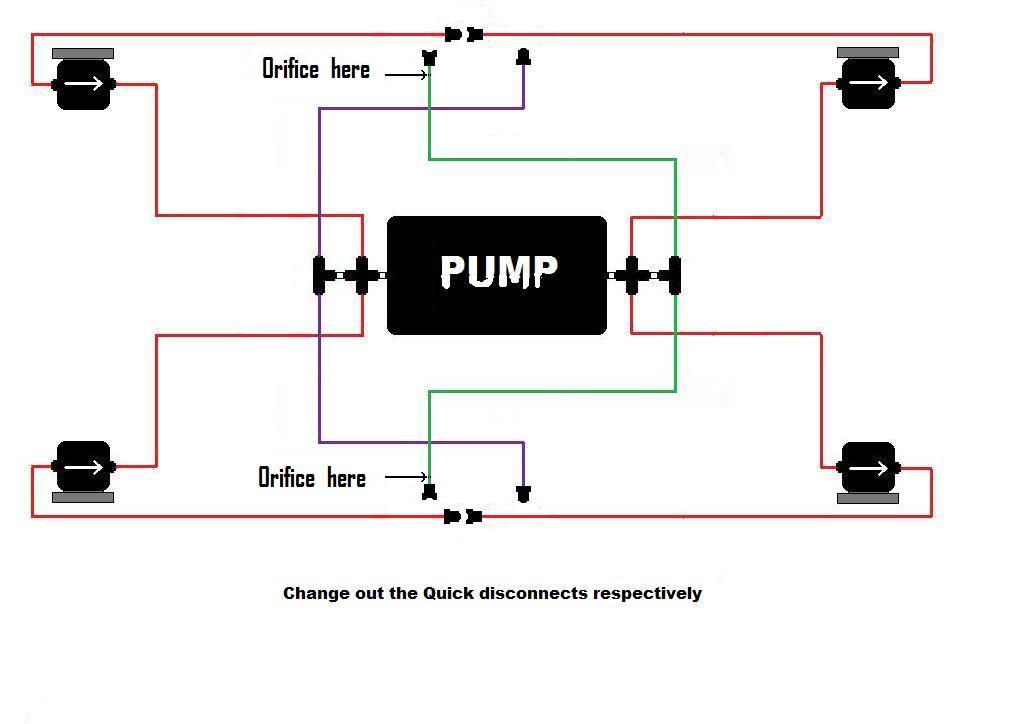

While pushing a load. Say with the bucket against a dirt pile with the back wheels off the ground or any time you are giving the Pt all it can do in forward movement with the back wheels in the air would the full pressure be in force to the front wheels? Pretty much as in this low speed higher torque set up. Now I did break that wheel motor (shaft broke into) with the wheels were reversed. But never have I blown a wheel motor.
I believe I would really like your set up. It is just in my case I do not want to give up the speed. I travel long distances most times I use the PT. Any where form a mile to a couple hundred yards. Then two I believe the motors will handle the occasional use of this set up. I have been wrong before but I am willing to try it and take the chance. Like I said I bought one wheel motor as a consequence of seeing just how much they could take. Now I know.
I would also like for you to look at this drawing and see if I have the valve drawn right. Maybe someone knows where a valve like it can be purchased.

I would like you to think and comment on this.
I don't think so, because the rear wheels would still spin while up in the air, functioning somewhat like a pressure relief valve... the pressure might spike at the front wheelmotor, rising beyond the normal operating pressure, but I don't think it would be the same as if all four wheel motors were plumbed independently...
Sorry, but I don't know the correct symbology for hydraulic circuits so I'm of no help here. I'd think that a custom mainfold and solenoid valves would allow you to make the circuits function any way you'd like.

Stray, I am one of the ones who permanantly traded speed-for-torque by changing out all four wheel motors....not cheap, but did work as intended. I can understand what you are trying to do also.
Torque is a result of pressure acting on surface area and being unable to leak past due to warn motor componants or low oil viscosity. System pressure is limited by pump design (and wear), relief valve setting, by motor displacement & surface area, and bypass leakage by motor wear and oil type/temperature.
Speed is the result of the flow of oil, which is limited by the same parameters. A retrictive orifice will reduce the flow in a part of the circuit, but pressure will remain the same. For a given input, the system provides equal pressure to all 4 motors at all time, but the flow can shift from 50/50 up to maximum rated flow to one side only. Thus the speed of the left versus right side motors can change due to variation in load (traction or turning).
The variable displacment pump can not put out maximum rated pressure and flow at the same time; in fact it is an inverse relationship. The foot pedal changes the pressure/flow ratio such that at minimal input the pump is putting out maximum pressure (assuming full engine output power/RPM) and minimal flow. As one increases the pedal input, that ratio changes until the pump is at max flow, but at significantly reduced pressure.
One important thing to note here is engine speed/output. It is quite possible for the throttle cable to not be pushing the engine governor to maximum. Engine must be putting out full max power in order to get full hydraulic output.
Your idea of placing a restrictive orifice in line with the rear motors would only reduce the flow to them, yet not increase the pressure to the front motors for no torque gain.
I would thourghly check that:
Engine running at full rated RPM & HP (compression & valves)
Foot pedal providing full range of travel to hydro-back lever on pump
Operating technique - back off foot pedal to achieve maximum torque
Hydraulic oil not too hot or thin - cooler working, may try a higher viscosity/synthetic
Pump output at rated specs for pressure & flow (at hyd shop)
All wheel motors at full specs ( ie not excessivly warn - internal leakage)
Your solution may be bringing all aspects of machine back up to original specs. Some of the above items are quick & cheap to fix. Even replacing the hyd oil may not be too bad if you can filter and use it in another engine (OEM is 10W30 motor oil). Testing and possibly rebuilding the engine, pump, or motor(s) would be a bigger expense, but could well be the source of your lack-of-torque.
Good Luck, Rip

If you put all motors in series, the motors will all run at the same speed w/ different torque - turning will be hard. If you put two motors in parallel, it will be like a differential - both motors will have the same torque, but different speeds. If you put the front two motors in parallel, and the back two as well, and then place both sets in series, you'll have the equiv. of a 4wd truck.
On my 1445. the front wheel motors are in parallel, and the back wheel motors are in parallel. All connected to one source.If one wheel is off the ground, then all the fluid will go to the wheel off the ground, which has the least resistance. If I raise both front wheels off the ground, engine not running, and turn the right front wheel, the left front will turn in reverse. Why, you say, because the one wheel motor is acting like a pump. If I raise the right front side, and the left rear side, I am betting that when I turn the right front wheel, the back left wheel will turn in reverse. Why again, because the turning front right motor is again acting like a pump and forcing fluid back to the left rear.
With engine running, if one could add a brake to the spinning wheel, the fluid would see the wheel motor as doing work and feed the rest of the wheel motors.
Does this sound logical to anybody else.

The 425's are plumbed differently, as SnowRidge so aptly described.
On the 400 series machines, each side has the front and rear wheel motors in series. The two series coupled sides are in parallel.
You can lift both front wheels off the ground using the bucket, and the tires will spin slowly, yet the rears will continue to push the tractor. Similarly, you can pucker the rear of the tractor, lifting both rear wheels off the ground, and the front wheels will continue to push the tractor.
You'd only lose propulsion completely if both the front an rear wheel on the same side were off the ground, and that circuit would get all the flow. Luckily, with the oscillation of the PT, that's almost impossible, unless you're in the unfortunate process of tipping the PT over on its side....

You can not forget about the relief circuits on the pump. When you exceed the torque limits of the wheel motors, you will maybe hear the relief circuits in the pump operating. When you hear the engine start to lose power, it is probably working at or near relief pressure. If the relief did not work, the engine would stall , or something would blow out, be it pump, hose, or wheel motors. If you want to climb hills or whatever, then you need larger wheel motors, or larger engine, or larger pump with a larger engine, and larger wheel motors. You have to simply overcome the energy available for the weight you are trying to get up the hill. Why are motorcycle fast, Hp to weight ratio. Look at the hydraulic winch. straight off the motor shaft, you have so much pull, but run that shaft through a gear box, and you increase torque.
You have to realize, that a larger PT might not be able to get up that slope, because even though it has a larger engine, it also weighs more.
Go into this web site and use the hydraulic calculators to work some figures. With the same engine, same pump, by doubling the cu in of the wheel motors, you will double the torque. but you will lose some speed, as has been stated before.

I think you may have a bad tram pump. Your description sounds similar to that of Central_PA_Chris when his brand new machine couldn't climb up onto his trailer. His was obviously worse than yours, but there are certainly similarities. PT finally fixed the problem under warranty.
There should be an implement (wheel motor) relief valve that screws into the pump body. It may be bad, partially bypassing some fluid. It is located on the bottom of the pump, directly opposite the trunnion shaft.
For what its worth, I can tow my 2,400# trailer around with my PT, even up a mild incline. I also towed a small trailer with 60 gallons of water and a bunch of tools (roughly 1,000#) up my hillsides when I was planting Xmas trees. What you are experiencing just doesn't seem right.

I don't think you have a leaking motor or pump by your description. I would have to say that you are close on your description below, but not quite totally on the money.
I would like to clarify one point, which has been extensively discussed elsewhere. The drive pump for power-tracs is a Variable Displacement Pump. (Check out the animation, I think it will help explain the action of the pump.) These are special pumps that can vary the amount of oil pump from 100% to 0% to -100%. (i.e. full forward to stop to full backward). This means that if the engine is going at full speed (Wide open throttle, WOT), all of the peak horsepower can be applied to pumping 0-100% of the flow. If you are creeping up a hill, with only a little bit of hydraulic flow, then the pump needs only to be pumping that limited volume plus whatever gets lost in the pump or drive motors. If you try to pump more oil that the required amount, then either the reliefs will open and dump oil, or the engine will start to slow down. With extra load on the engine, the engine speed slow more, you loose horsepower, and the engine slows more, until the vicious cycle stalls the engine, or you let up on the treadle.
So, the best strategy on hill climbing with a PT (or anything else with a similar drive) is to have the engine at peak horsepower, (WOT), and just enough pedal pressure to just barely slow the engine, keeping the engine running at peak horsepower.
