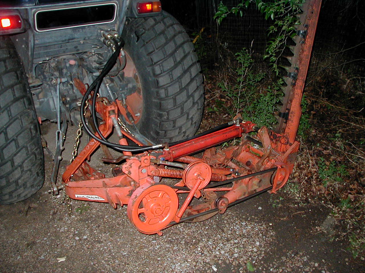

AC meaning Allis Chalmers? Can you tell me what model you have, will it cut vertical and does it have a hydraulic lift so I can operate easily from inside cab?
Thanks, Kenny.
   / More sickle bar mower questions #20
Thanks, Kenny.
Yes it is a Allis-Chalmers 80-R3, It will cut vertical on down to below grade.
I did have to mount a hydraulic cylinder to let me control the cut angle from inside my cab.
The factory 3pt cable lift did not allow the range I wanted so after removing that part I modified the attachment point slightly to allow a cylinder to control the Sickle bar. Works great.
I have seen this model sell for $200 to $2000... They are very heavy duty sickle mowers. If you have an ex A-C dealership in your area, you will have quite a few model 80 mowers around you as they were very popular. Available in 3pt and trailer mount pull type, and I don't think they could ever be worn out, very well built. KennyV.
