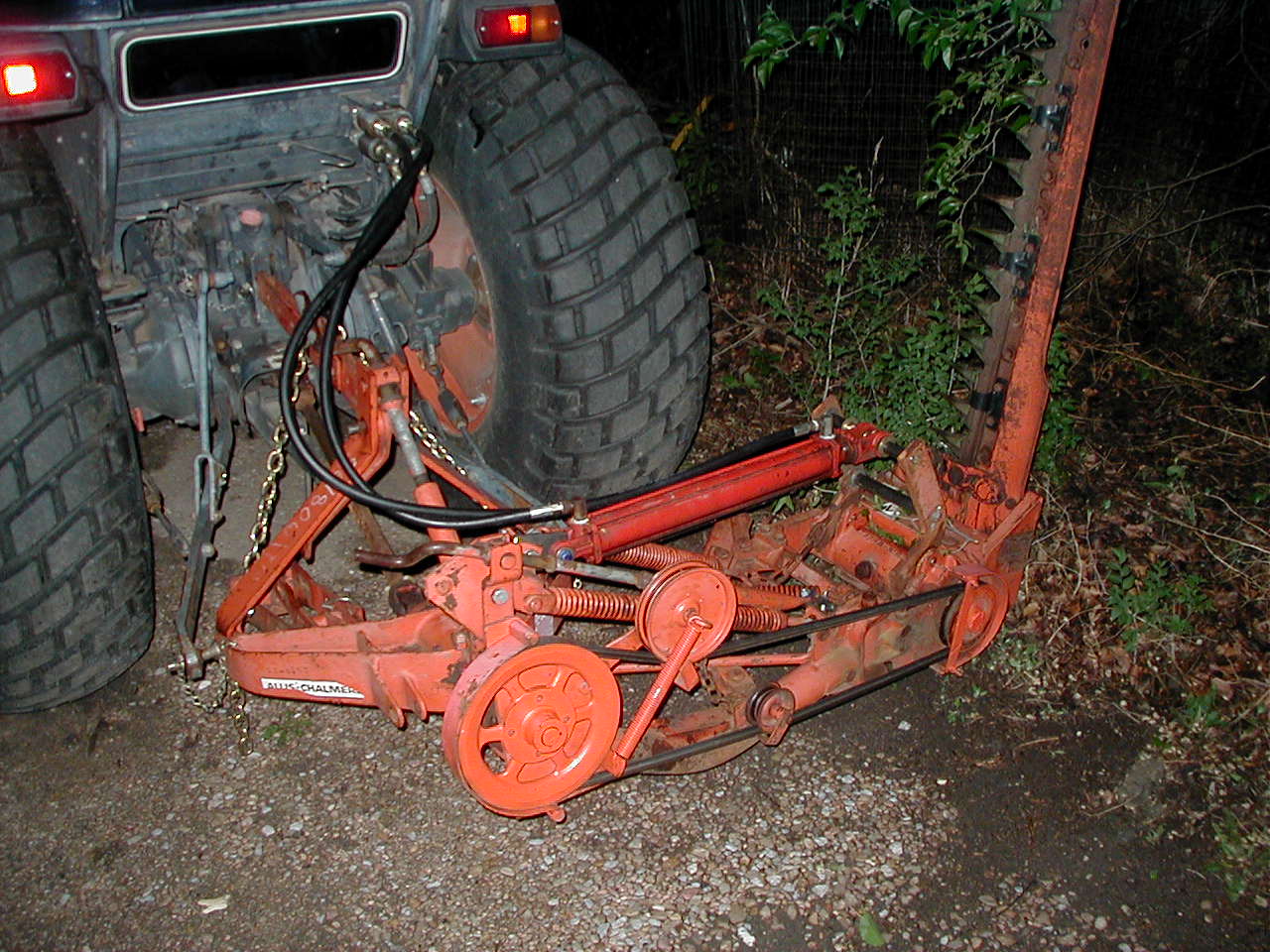

I have posted about my sickle 3pt AC on other threads but I have missed this one.
Get a good sickle it will definitely do what you are trying to get done. I jusst side trimmed my hedge row with mine yesterday. The only bad part is attaching it to my tractor. It is heavy and takes a little work... I'm trying to avoid all of that that I can, dose not seem to be working for me, somehow everything is more work than it use to be...
I can cut anything that will fit between the rock guards except steel T-posts.
Get a goos old sickle, you will love it and with very little care it will last forever.
A 3pt is handier to trim closely and maneuver around obstacles, a tow wheel mount is very easy to hook up... either one will cut grass or trim trees KennyV.

AC meaning Allis Chalmers? Can you tell me what model you have, will it cut vertical and does it have a hydraulic lift so I can operate easily from inside cab?
Thanks, Kenny.
/ More sickle bar mower questions #20
Thanks, Kenny.
Yes it is a Allis-Chalmers 80-R3, It will cut vertical on down to below grade.
I did have to mount a hydraulic cylinder to let me control the cut angle from inside my cab.
The factory 3pt cable lift did not allow the range I wanted so after removing that part I modified the attachment point slightly to allow a cylinder to control the Sickle bar. Works great.
I have seen this model sell for $200 to $2000... They are very heavy duty sickle mowers. If you have an ex A-C dealership in your area, you will have quite a few model 80 mowers around you as they were very popular. Available in 3pt and trailer mount pull type, and I don't think they could ever be worn out, very well built. KennyV.
