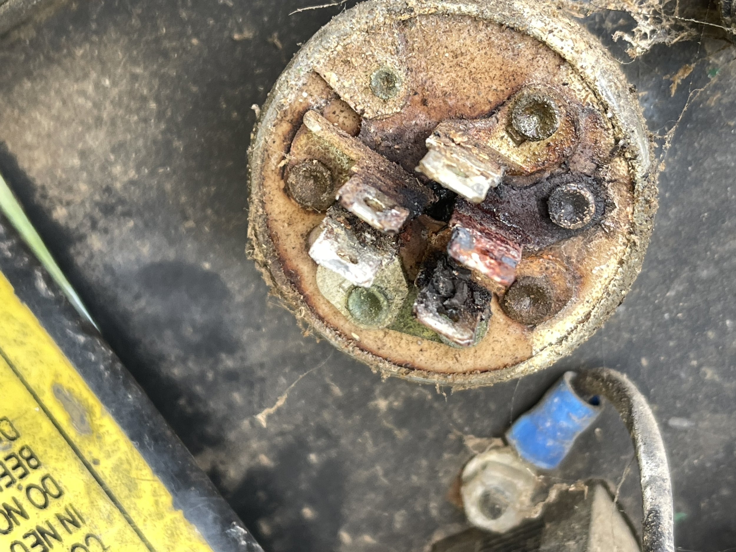

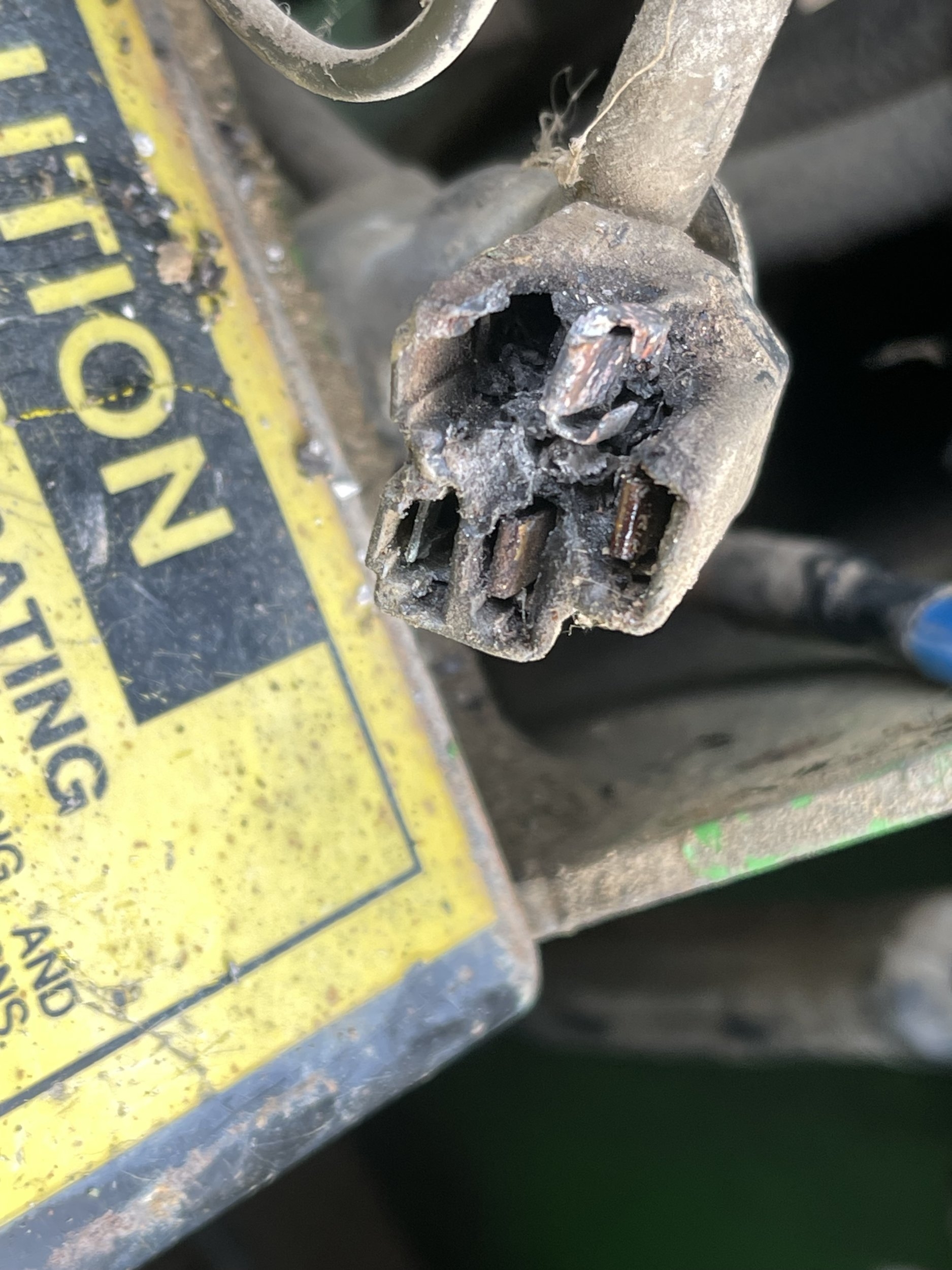

Well…how about this—it’s fixed! Today I went back and double checked everything, and then pulled the carb and went through it again. Back together and fired it up. Voila! Runs like a champ! So…
I put the bucket back on and head down the hill in the front yard to move dirt from a huge pile…worked it about 30 min. then got off to move my little towable backhoe. So I shut the engine off. Went back to it and all I got was a little “shorting sound” coming from around the rear/side/starter area. Redid all the connections. Nothing. The key switch seemed to have a lot of play in it so I pulled it.(after I disconnected the battery😜) I found a melted mess in the switch terminals and the harness plug….geez…tomorrow is another day LOL…

On the bright side, you don't seem to have a relatively expensive engine/compression problem and ignition switches and pigtails are relatively cheap in terms of money and labor.
On the down side of course you still don't have a functional machine.
I suggest that you solder and heat shrink or buy high quality weatherproof crimp connectors to connect your new pigtail so you are not trying to diagnose and replace this again in 6 months to a year

What do you suppose caused this connection to overheat like that?
   / More problems on the 425 Kohler CH25 #140
Vibration, loose connections, corrosion, dirt, water, low quality connectors, overloaded connectors, the list could be pretty long. Basically anything that could, or did, cause added resistance at either the switch-connector, or connector-wire points, or caused a conducting path between the wires.
@Modrob Congratulations on finding the issues! As @MTGreen wrote, I would use quality parts, preferably heat shrink with solder and adhesive built in, and I would coat the contacts with some dielectric grease, and perhaps tape the whole key switch / connector assembly. "Once burned, twice shy", and all that... I like the connectors from McMaster, West Marine, and DelCity. Not cheap, but high quality. I file them in the fix once and forget category.
