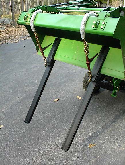

Apr 16, 2003 / More Bucket Forks #1 A Anonymous Poster Epic Contributor Joined Sep 27, 2005 Messages 29,678 I've been wanting to make these for a long time. Many features were taken from other TBNers fork designs. Attachments 256134-DSC00009.jpg 87 KB · Views: 1,173

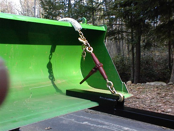

Apr 16, 2003 / More Bucket Forks Thread Starter #2 OP A Anonymous Poster Epic Contributor Joined Sep 27, 2005 Messages 29,678 A close up view. Attachments 256137-DSC00007.jpg 90 KB · Views: 903

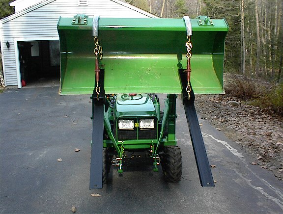

Apr 16, 2003 / More Bucket Forks Thread Starter #3 OP A Anonymous Poster Epic Contributor Joined Sep 27, 2005 Messages 29,678 Rear view. I found out (too late) the back edges would dig into pavement when backing up, and rounded them off after this photo was taken. Attachments 256139-DSC00010.jpg 72.2 KB · Views: 865

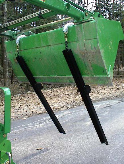

Apr 16, 2003 / More Bucket Forks Thread Starter #4 OP A Anonymous Poster Epic Contributor Joined Sep 27, 2005 Messages 29,678 One more. The holes on the fork ends are to hook a ratchet strap over to my bucket hooks when securing a load of brush. Attachments 256142-DSC00012.jpg 66.6 KB · Views: 781
Apr 16, 2003 / More Bucket Forks #5 Bird Rest in Peace Joined Mar 20, 2000 Messages 42,151 Location Corinth, Texas Pretty neat looking arrangement.
Apr 16, 2003 / More Bucket Forks #6 Mark_in_NH Veteran Member Joined Mar 4, 2002 Messages 1,555 Location Moultonborough, New Hampshire Tractor New Holland TC35D w/ 16LA FEL cbh30, Very nice work, I really like the added touch of the vinyl hose on the chain where it wraps around the bucket. What a great idea to help save the paint and aid in other damage prevention. Great Job !! /forums/images/graemlins/laugh.gif
Apr 17, 2003 / More Bucket Forks #7 T tdenny Platinum Member Joined Apr 12, 2002 Messages 581 Location Seattle area Tractor JD 855 4WD, HST Very nice. /forums/images/graemlins/cool.gif That's exactly what I'd prefer over my own current forks.
