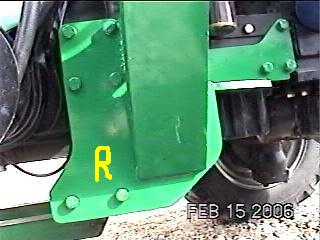

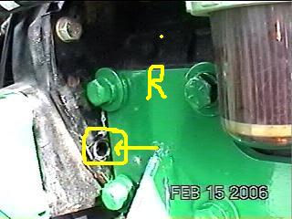

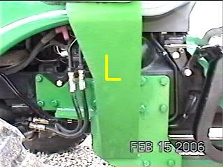

got the mounting brackets and they were messed up pretty bad had to sand them down and repaint going to wait a day or two so it can dry will put them on and will post when i get it done
Don /forums/images/graemlins/smile.gif
