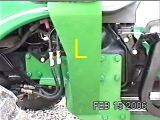

i have a montana 3440 hst and the mounting bolts in the front end loader keeps coming loose i love this tractor its the only fault i have found i was wondering if any one else is having this problem.

i have no peoblem with that i have plenty of power i heard there are new mounting brackets to fix this problem tractor is still under warranty i hope i can get these and fix it myself

i call montana tractors and talk to bob gontlz he told me there was new mounting brackets to fix the problem so im sitting up a appointment to get this fixed it may take a week or two to get this fixed but will post when it is done i really like this tractor and it seems like montana stands behind there tractor i like that thanks don

got the mounting brackets and they were messed up pretty bad had to sand them down and repaint going to wait a day or two so it can dry will put them on and will post when i get it done

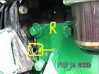

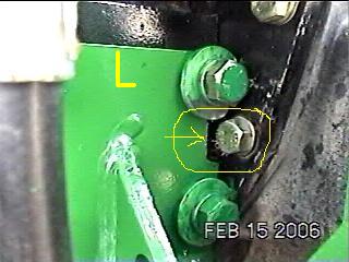

Sorry for the delay have been sick. Just now getting to where I can work on tractor. Got the mouonting brackets on and really like the way they fit. The extra bolt holes should secure the brackets so the bolts dont come loose again. I put the right side on first and one of the transmission bolts had to be removed to put the plate on then I couldnt put the bolt back in if I would have none it I could have notched the plate out but I didnt have enought paint to repaint so knowing that I notched the plate out on left side. That worked perfectly. They only sent 2 cans of Montana green paint it wasnt enough to paint all bolts and brackets the right side is correct color and left is John Deere green. It's not really noticeable just slight difference.
Don /forums/images/graemlins/cool.gif

/ Montana front end loader
#13
A picture of left side
#14
picture of right side
#15
