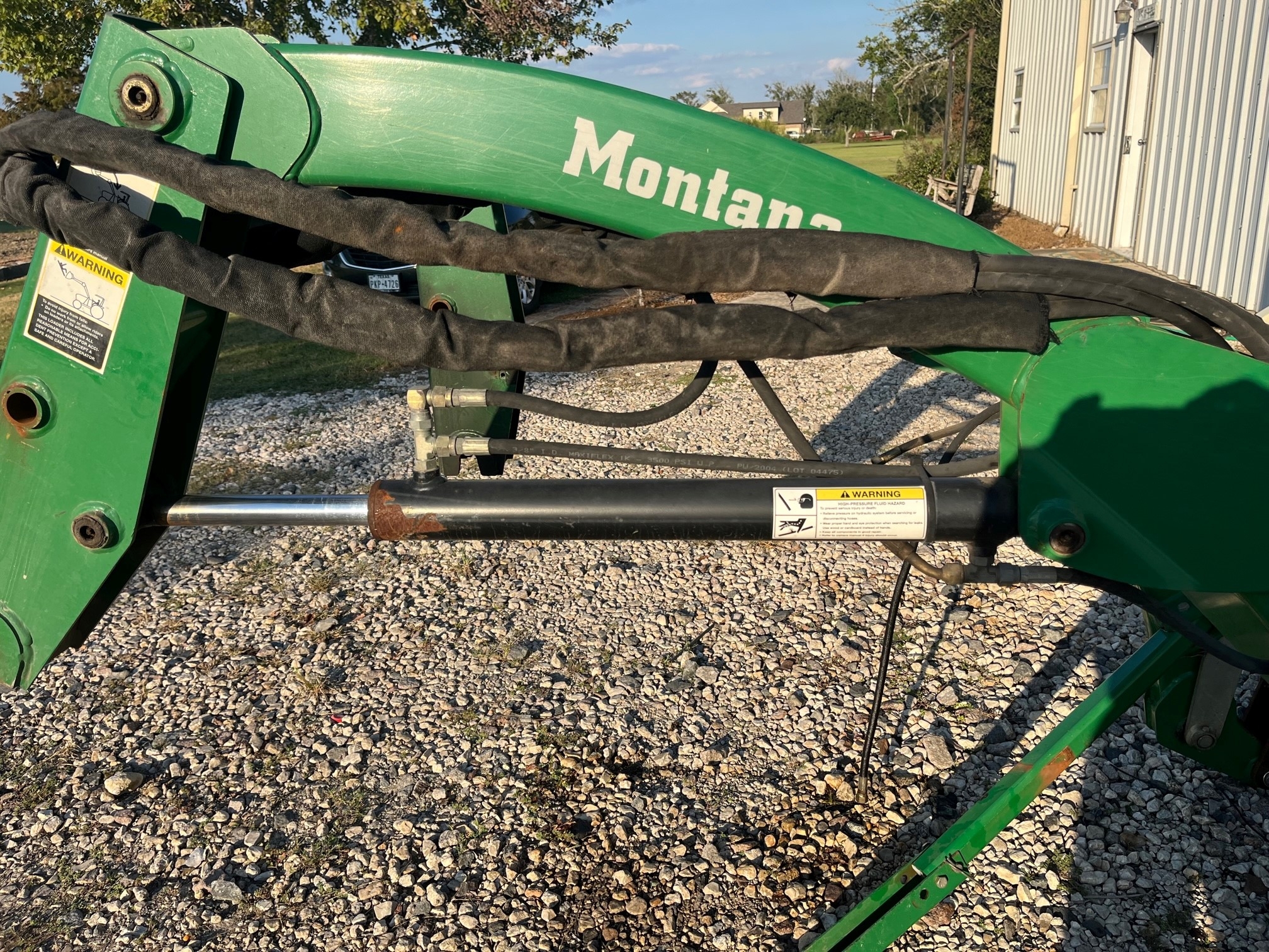

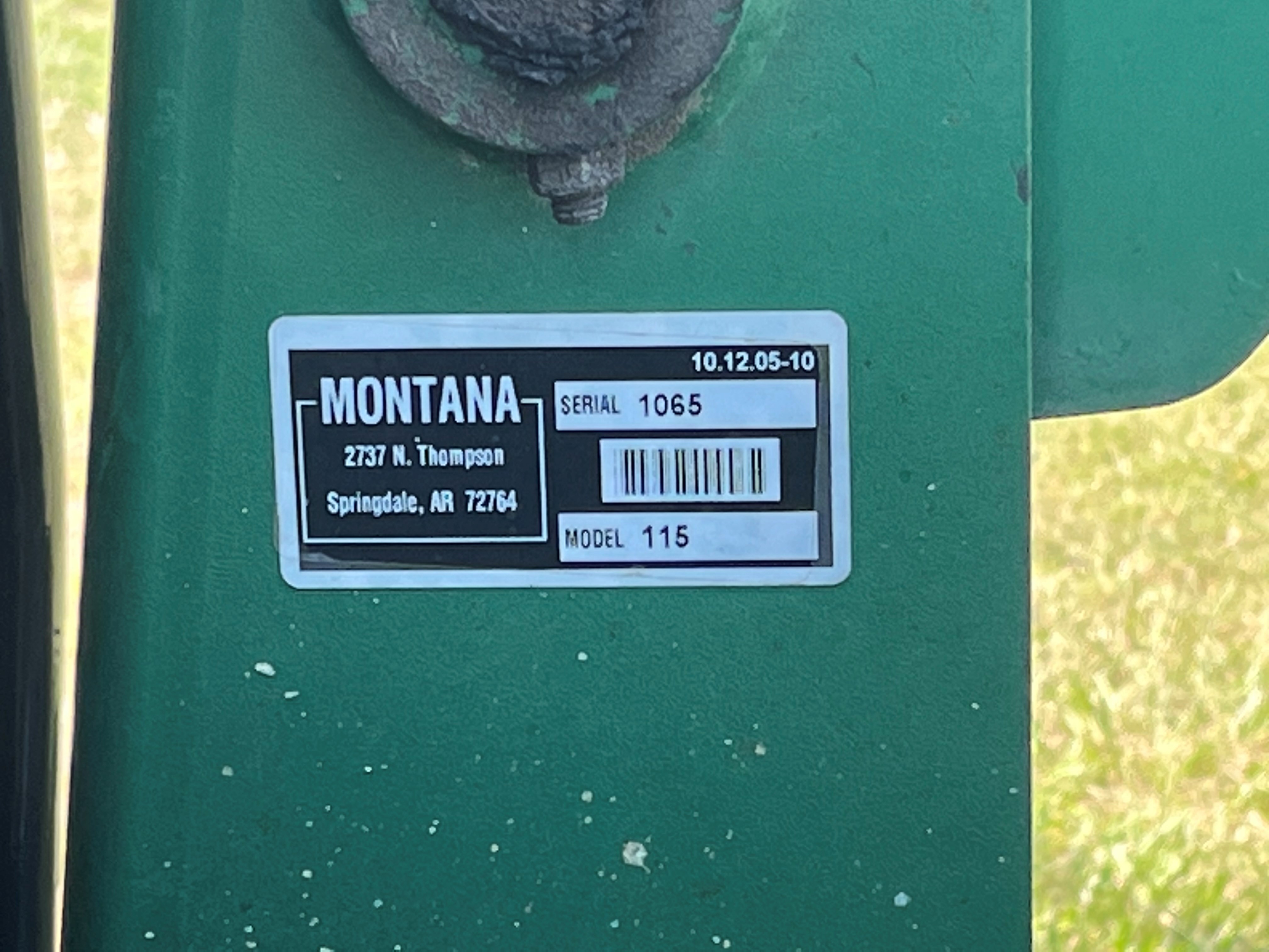

I'm looking for information on this loader. I have the arch boom style FEL that needs lift cylinder seal repair kits. I can't find any information on this loader or parts. I believe it built by AmerQuip??? Any information or parts contact would be very helpful.

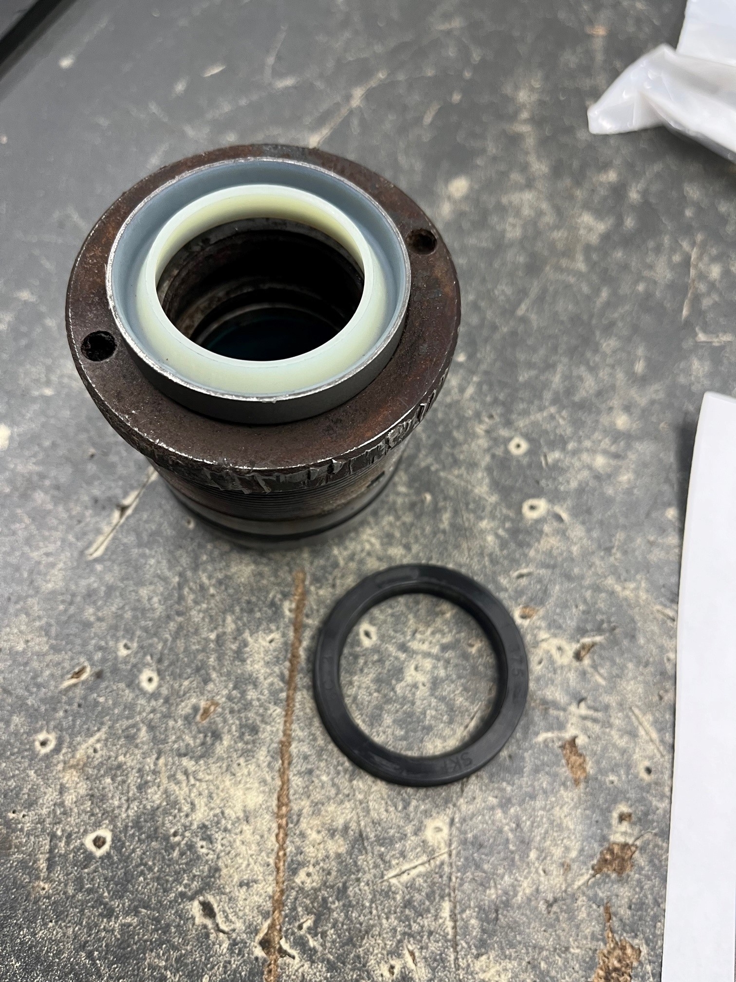

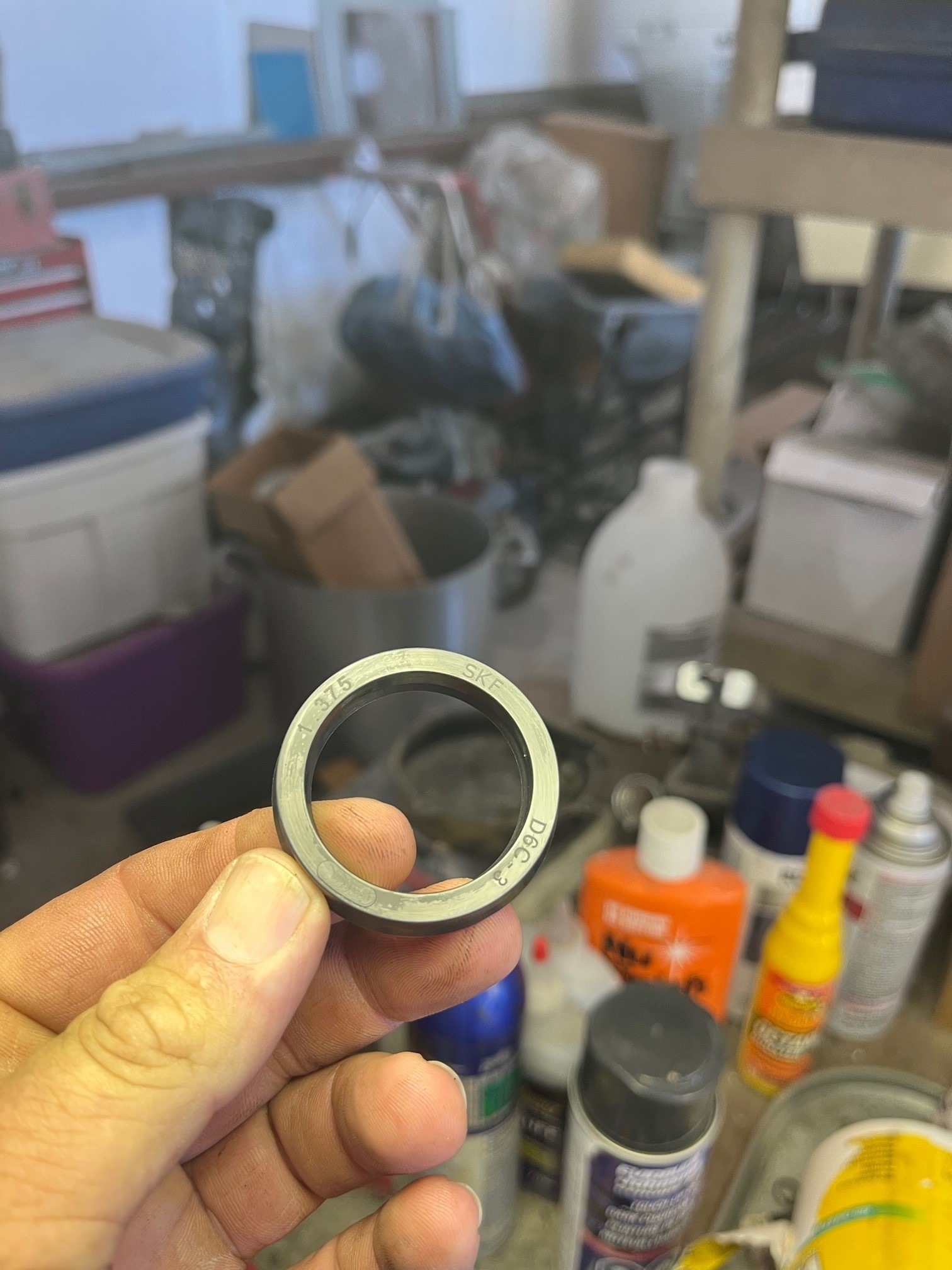

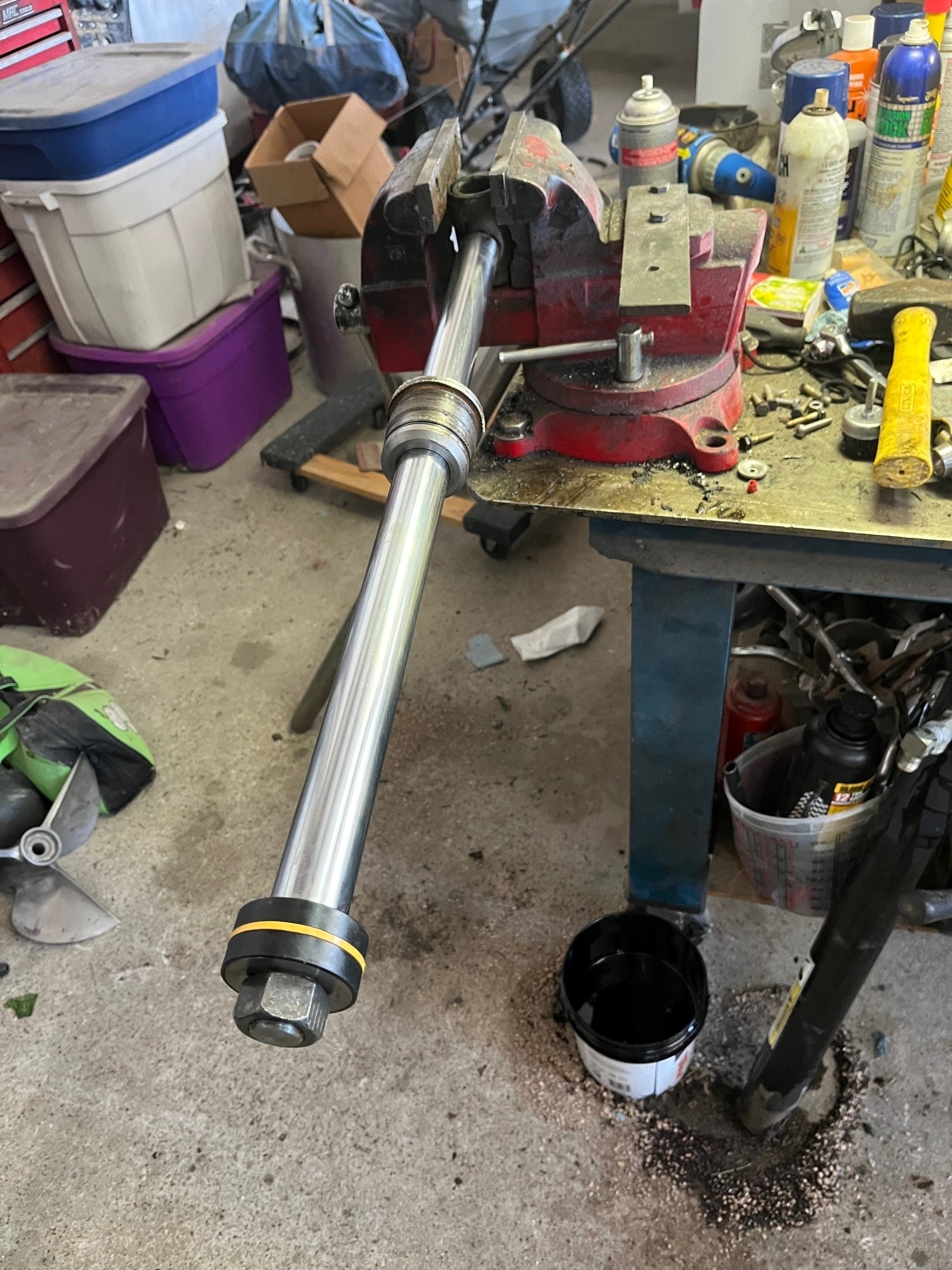

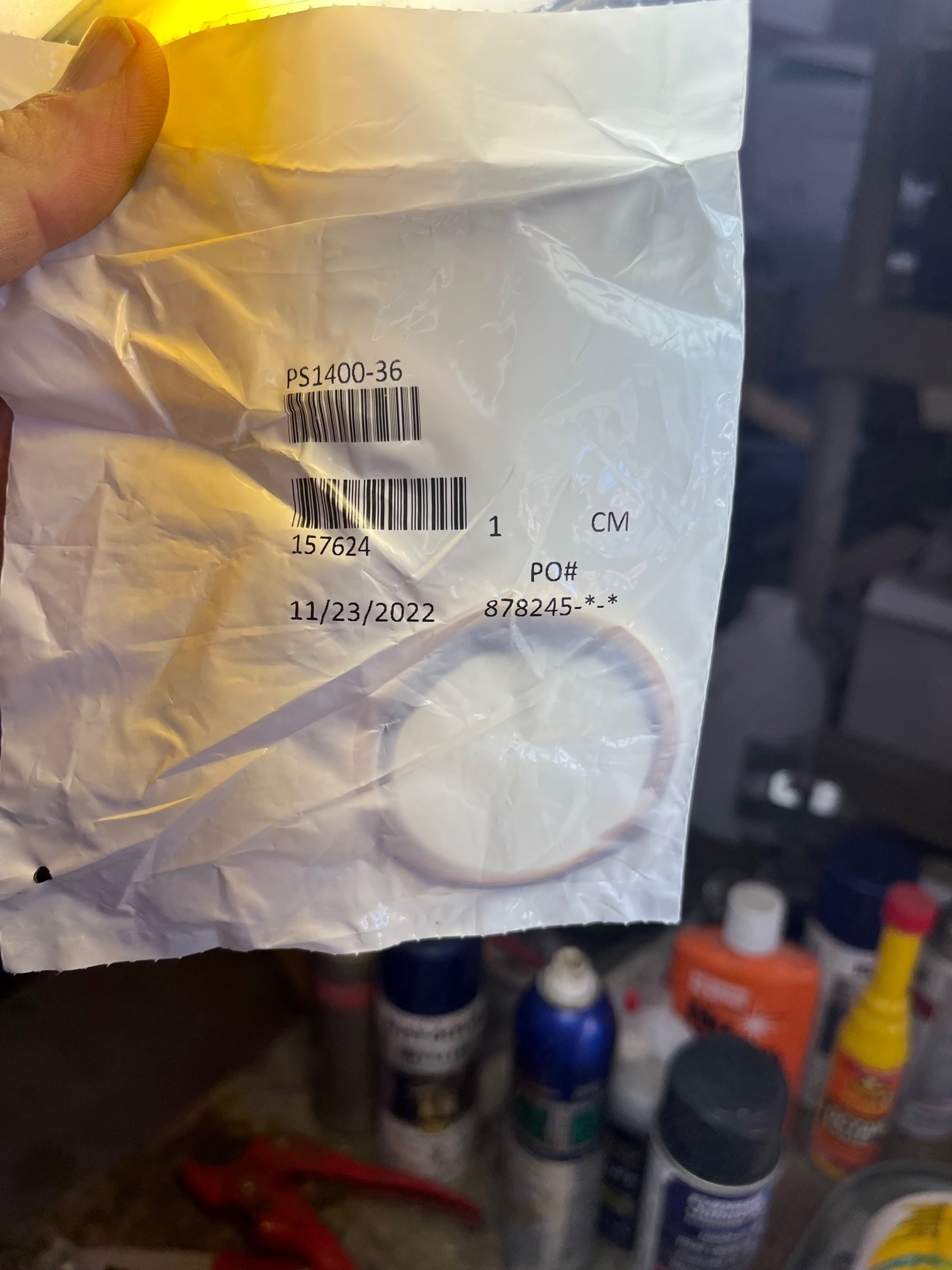

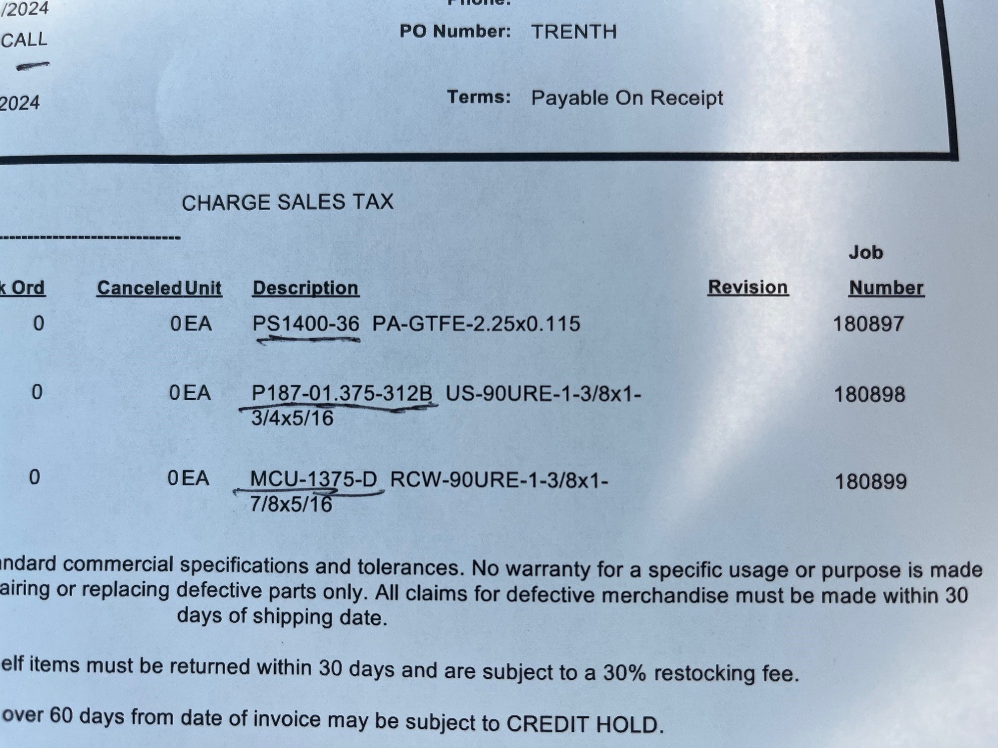

So, a quick update. I was able to find the piston seal and both gland seals. I replace the seals on both lift cylinders for $63 dollars and now my FEL is back in service. Part numbers are listed below. I hope this helps you out.
