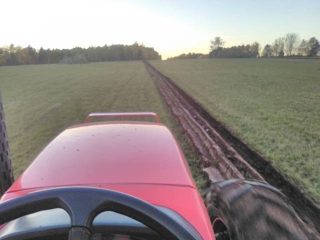

2nd gear is hardly moving at idle. Too slow will also cause poor plowing. Have to see how the plow was set and what the wear parts look like.
Plowing is an art and so it setting up a plow.
