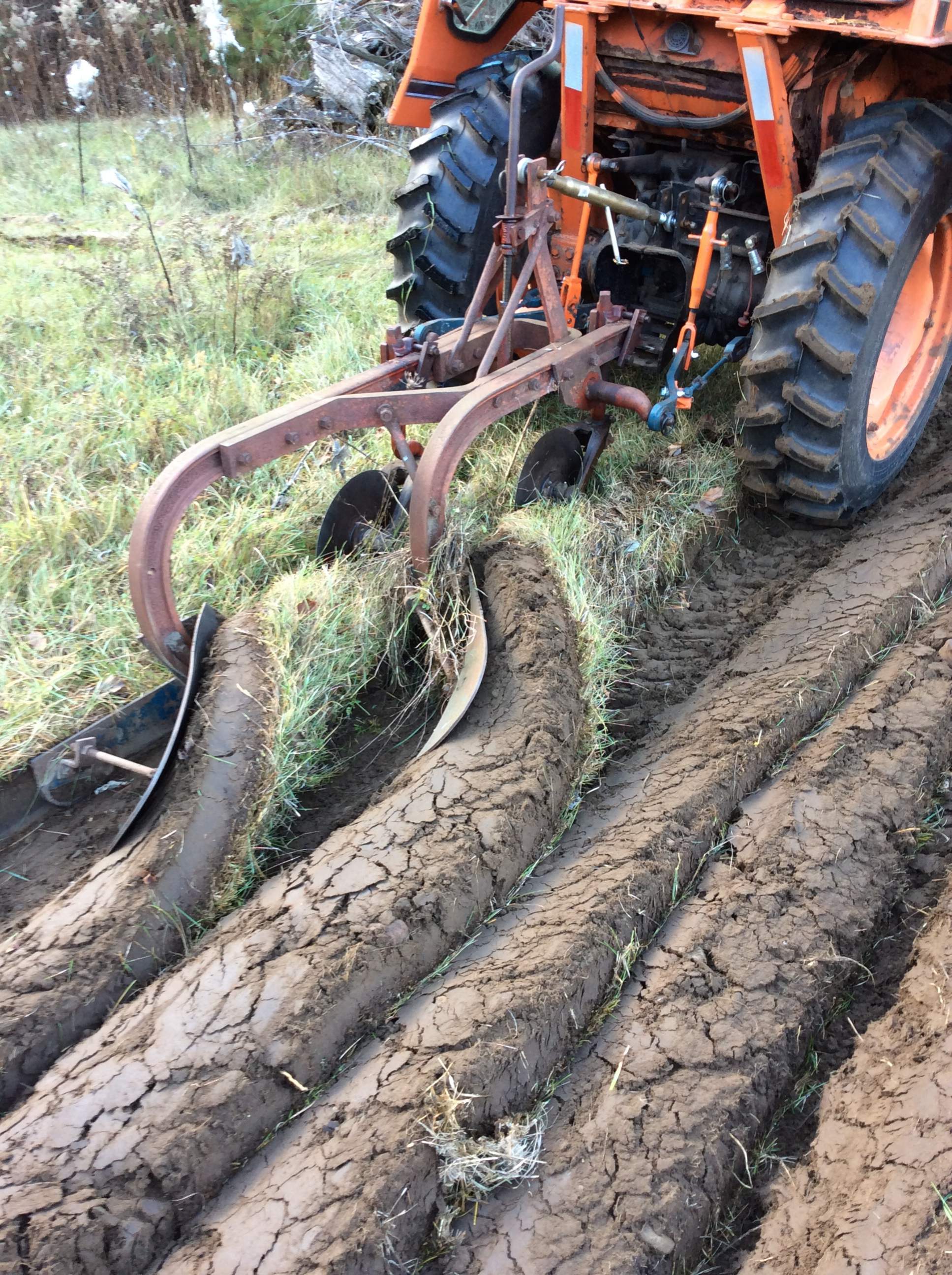

About 4 years ago I bought a used IH 14-2 plow for use on my Kubota L2550 (29 h.p.) with the intention of creating a couple of garden plots. The plow appeared to be in solid but rusty condition. The first year I tried using it I had a tough time getting the "sods" to actually roll over and lay in the previously plowed furrow. I tried this really late in the season and didn't have much time to fool around with anything. This year though, I did have more time and I spent a lot of time looking into various websites, YouTube videos and reading books. The conclusion I came to is that almost any plow (that isn't hopelessly knackered) will do what it's supposed to do when it's aligned properly both to the tractor and the ground that is to be worked. My plow has coulters on it but they were hopelessly out of alignment with various components of the plow. Once I got all of that sorted, my plow did exactly what it was designed to do and did it well. The coulters were an integral part of the equation in that the field I was plowing hadn't been worked for 30 years or so but with the coulters sharpened, greased and aligned the sod rolled over perfectly. I was glad I spent the time to understand my plow and "got to know it" a bit. I know that sounds a bit corny but I am a believer in old iron, it served our forefathers well and it will serve us well with the investment of time and elbow grease.
Cheers, Erik
P.S. Will post a photo shortly
/ moldboard plow questions #28
Cheers, Erik
Learning to use a plow is pretty basic geometry and taking the time to "get to know" your implement and its integral part of the plow/tractor equation always pays off with less frustration for the user and a pleasing outcome in the field. Ken Sweet

IMG_0347.jpgHere, I hope, is a photo of my furrows.
Cheers, Erik
/ moldboard plow questions #31
Nice job Erik. My Dad was a hard critic on anyone's plowing. He was a perfectionist when it came to fully turned soil!
Frank

Centering of plow to c/l of tractor will balance the pull on the tractor equaly to the driving wheels . On a 2 bottom plow at 12-14" furrows on a 35 Fergie size tractor the top link usually not run straight that is why wheel track settings front -rear inside measure need to be the same. [I prefere the front wheel 1-2" wider ] When both lower arms converge at the same angle [relative to c/l of tractor] you are not far off. Adjustments to disc culters draft bar position [l-r] rotation of bar alignment of last furrow landslide [bent] has a direct effect on plow alinement to tractor. Always consider the landslide to a rudder on a boat 1 degree off will turn boat [l-r] same with a plow; disc setting is critical on last furrow along with ware and side movement in spindle . cammax
/ moldboard plow questions #33
The JD book on plowing, suggests the tractor settings from center of the drawbar to the inside of your right rear tire be 23 1/2" for 12 inch plows, 25 for 14" and 27 inches for 16". Of course, some minor lateral adjustment can be made on the plow cross drawbar. Ken Sweet
