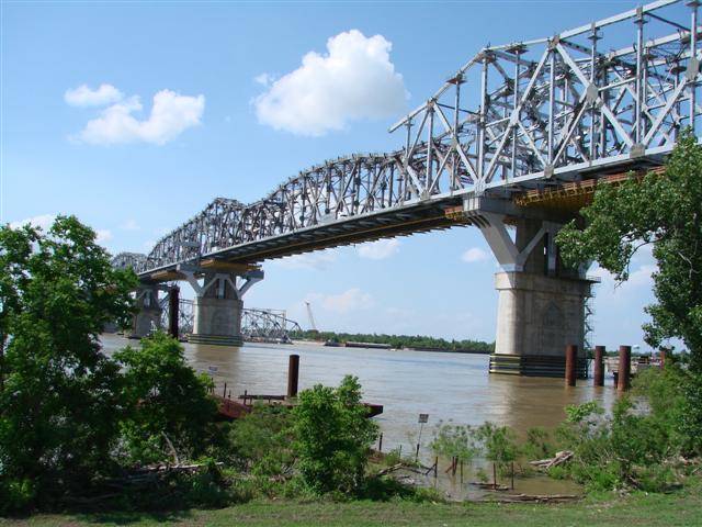

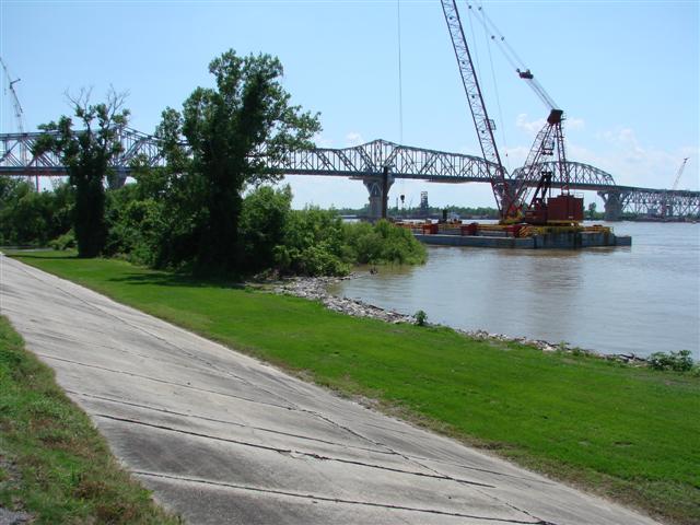

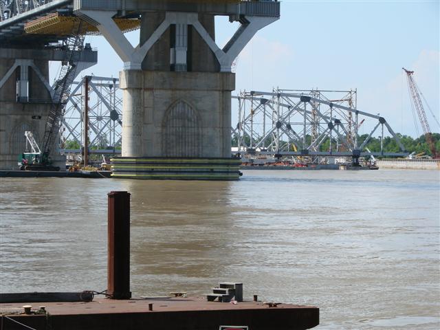

I am amazed by the engineering they are using to widen the 75 year old Huey P Long Bridge over the Mississippi River outside New Orleans. This is the longest train-auto cantilever bridge in the world but it was built with 2 very narrow car lanes on each side with no shoulders.
They are widening it to 3 wide lanes on each side with shoulders. This has been in the planning stage for years and many of us were worried that this bridge would be closed for months on end while work was being done. The engineers have figured out how to widen it without closing it off for more than a couple of days. :eek:
There are 3 giant spans that are being pre-assembled and barged in and they will be placed under the bridge and lifted up around it. These spans are the full 6 lanes wide with the centers cut out where they will wrap around the train bridge and the existing roadways.
The smallest span is scheduled to be lifted next month and it is 528 feet long and weighs 5,300,000 pounds. In the photos you can see the small span on barges in the river and you can see where the spans will be connected to the part of the bridge that has been built in place.
I believe the local TV stations will have cameras on it the whole time in case something goes wrong.
If you want more info on the project you can visit their web site. Louisiana TIMED Program Huey P. Long Bridge Widening
