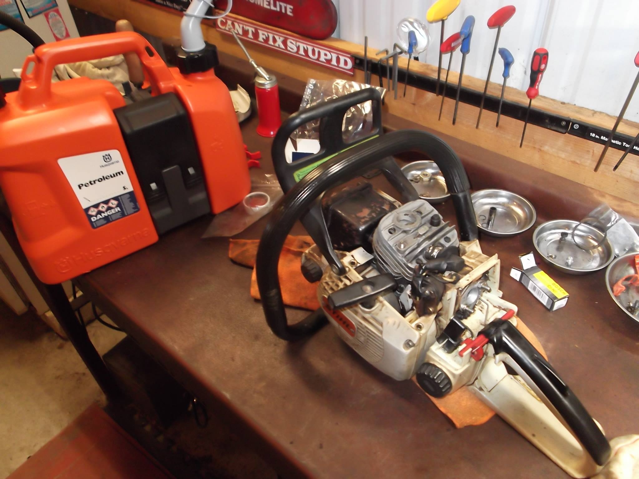

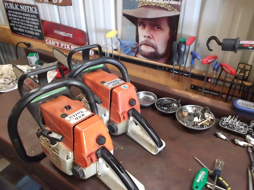

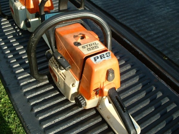

A friend of a friend just dropped off two. He tells me that the Dealer says he wont even look at them because he cant get parts. I was told they ran great and then didnt run next time he reached for them. Saw #1 had crack in the gas line ,at the carb. Trimmed it back while I replaced the Metering diaphragm in the carb. 1 hour and it runs great.
Saw #2 very hard metering diaphragm. Replaced it Walbro WT series carb parts. It runs great too. He was going to scrap them both. I just came back from sneaking back to his front porch. I would love them but in clear conscious I had to return.
Still have and use my 026 on a regular basis and every part except the hard nylon chain buffer that fits inside the outer cover is still available, though not at a Stihl dealer. I get all my replacement parts from Sawzilla actually. Just replaced the fuel, impulse and tank vent lines and a new sprocket as well. Bought the saw new in the mid 60's. Mine is the rare Arctic model with the heated handle. I run a 20" Carleton bar with a replaceable sprocket nose (greaseable) and 325 full comp chain. Bought it as well as an 090 G and an 075 and I still own both of them as well. The 90 and the 75 are shelf queens only.
The 026's have very little plastic on them. Only plastic is the top shroud, everything else is magnesium alloy.
The 026 is a great saw. It's an RPM saw and mine flat screams. I recommend them and with normal care they will last and last. No electronic anything, just a mag and points. Other than a couple spark plugs and replacement air filters (Sawzilla again), that's it for consumable parts. Original carb too. It's light and well balanced and IMO, the best mid range saw, Stihl ever produced. I found out much later on that the Artic model I own was only produced for 2 years.
I run syn gas in it as well as my other saws (the 2 Echo's). My Timber Bear has been modded a bit externally with a Red Beard velocity stack, oiled foam air cleaner, I pulled the limiter caps, cut of the plastic tang and reinstalled them so I could better tune it and I modified the muffler, opening it up, removing the top baffle and redirecting the top exhaust shroud so it didn't blow on the full wrap handle and melt the overcover. Echo has a habit of setting their saw too rich from the factory and without removing the limiter caps and cutting off the plastic tang, it's impossible to lean them out enough so I did that as well.
Got it set so it just 4 strokes at WOT a tad, free revving. At some point I may replace the ignition coil for the larger displacement saw for more rpm, but I may not as it runs just fine the way is is. I run a 20" echo bar (greaseable nose) with 325 again. I was considering going to 404 but it works fine with 325.

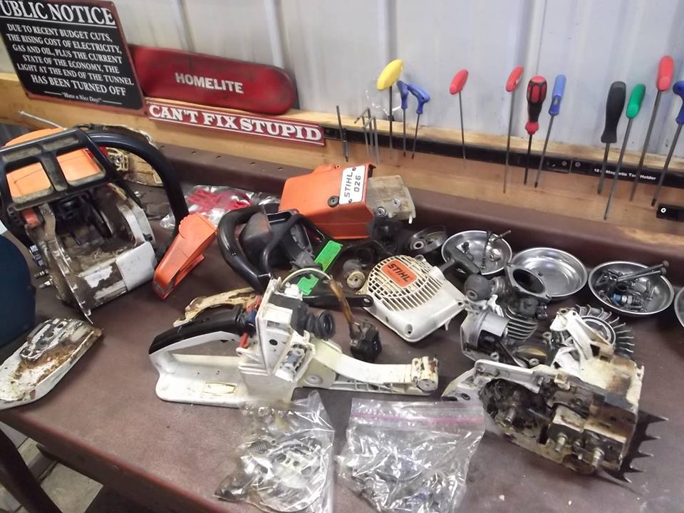

I have an old 026 as well. Good saws! I just completely overhauled mine and getting parts for it was easy.
