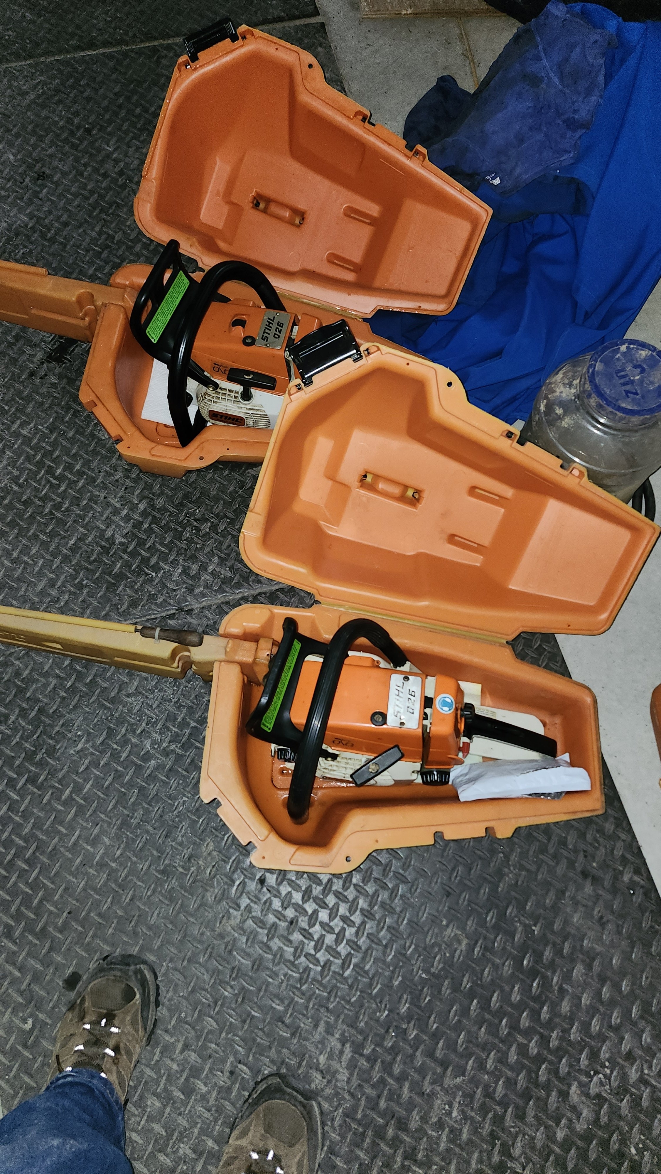

Old thread but i was searching 026.
Today, Stihl offers Homeowner..ranch and farm....and professional grades of saws. Was the 026 a Professional saw or a farm and ranch?
A friend of a friend just dropped off two. He tells me that the Dealer says he wont even look at them because he cant get parts. I was told they ran great and then didnt run next time he reached for them. Saw #1 had crack in the gas line ,at the carb. Trimmed it back while I replaced the Metering diaphragm in the carb. 1 hour and it runs great.
Saw #2 very hard metering diaphragm. Replaced it Walbro WT series carb parts. It runs great too. He was going to scrap them both. I just came back from sneaking back to his front porch. I would love them but in clear conscious I had to return.

Cases too!
