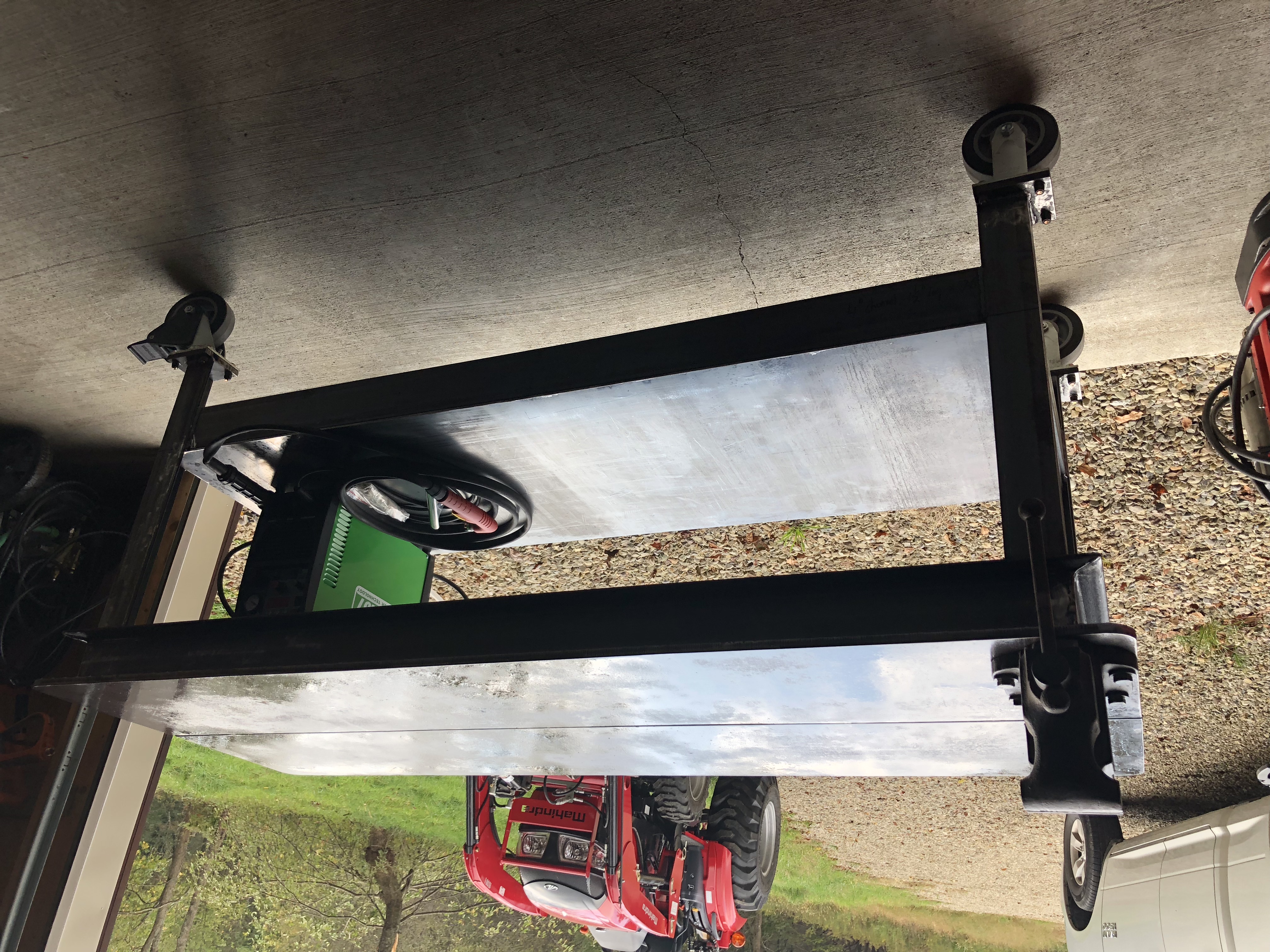

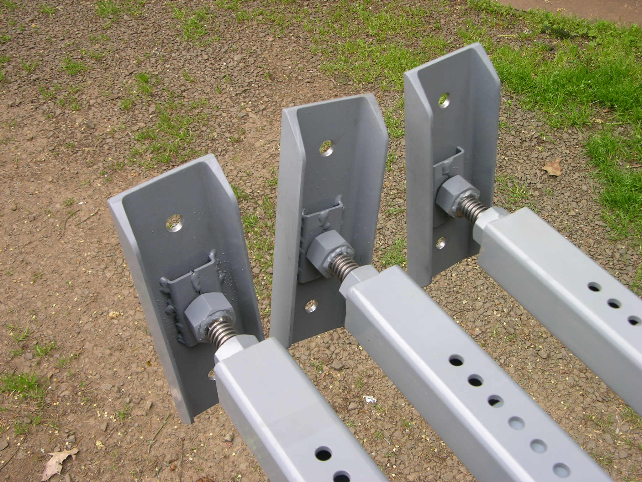

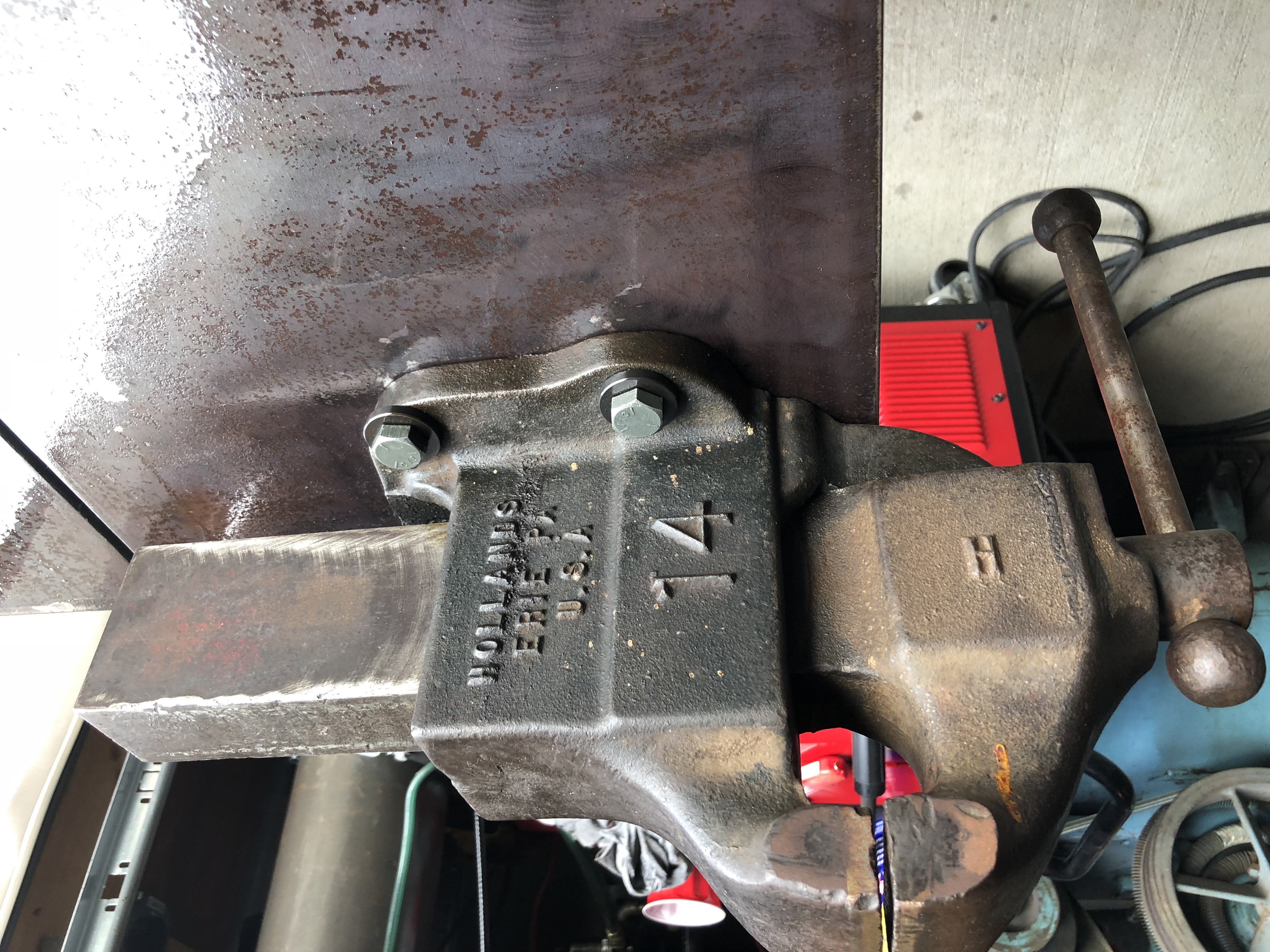

i have a vise vice...seems addicting to say the least. I have a 2x4 foot 1/2'' top table I built. Had dog holes in 5/8" diameter put in it to use dog clamps for jig work ( I do very little). It's on wheels so I can move it around as I need. It's probably the most used piece in my "garage." It's heavy but still mobile. I've built my front bumper and am building my rear bumper and tire carrier at the moment on it. No problems. I also put some 1" bolts in the bottom and welded plates on the bottom of the 2 1/2" square tubing and tapped them so I can level the table out wherever it is. helpful but not the easiest thing to do.
Great looking table. I hope you get as much use out of yours as the rest of us have out of ours.

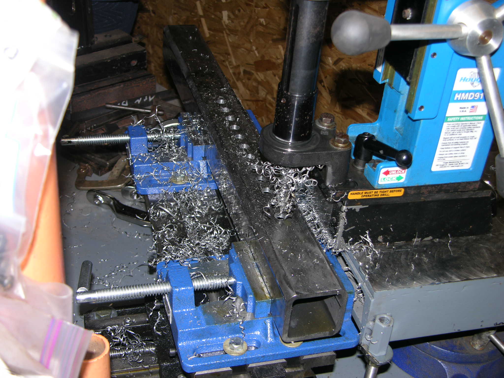

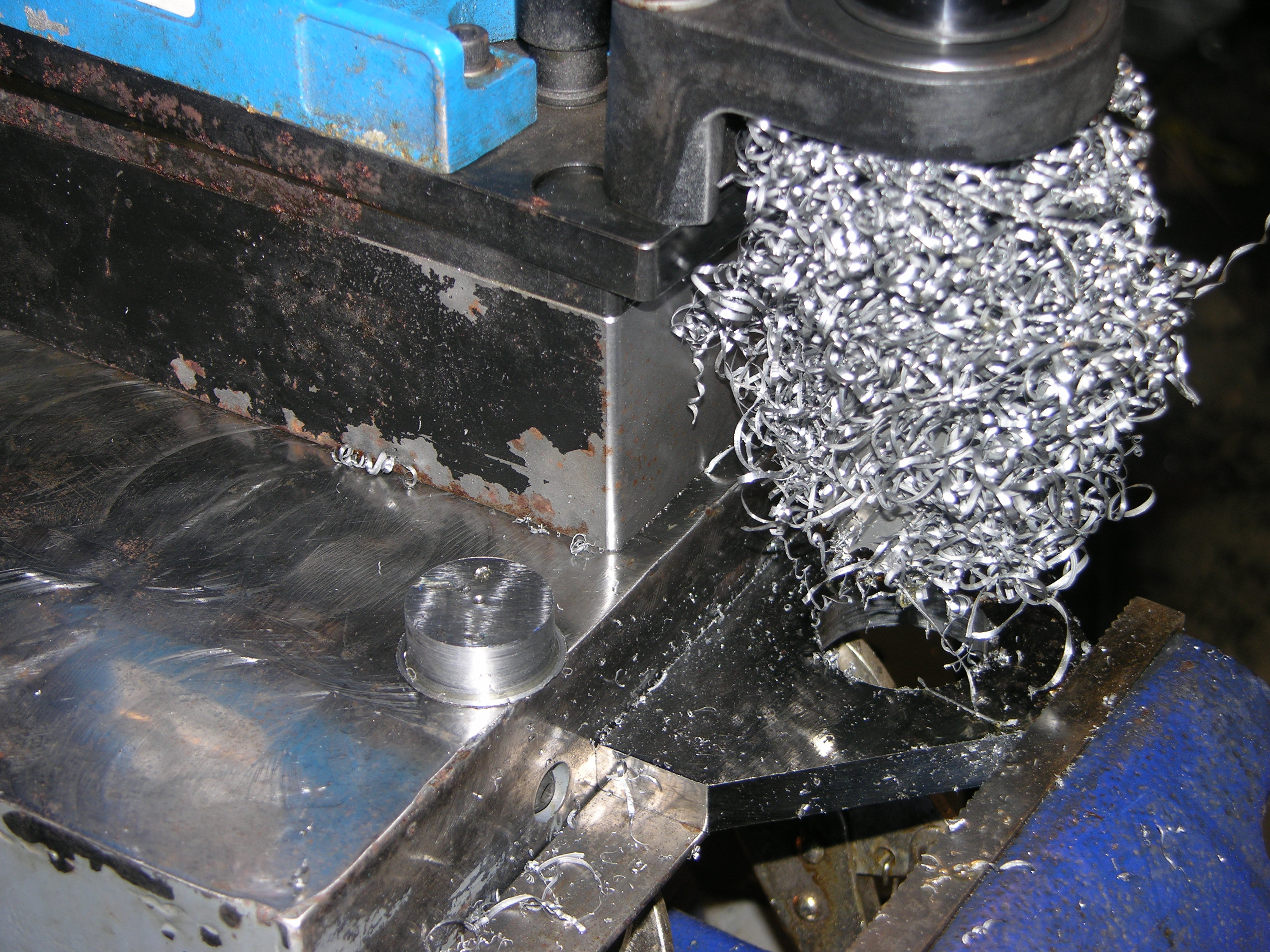

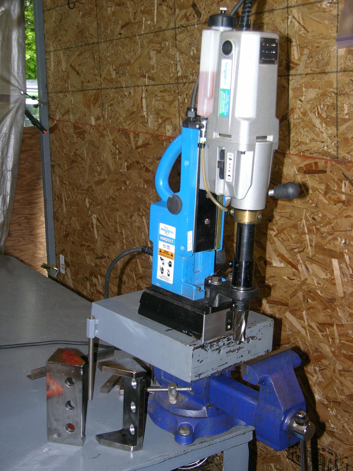

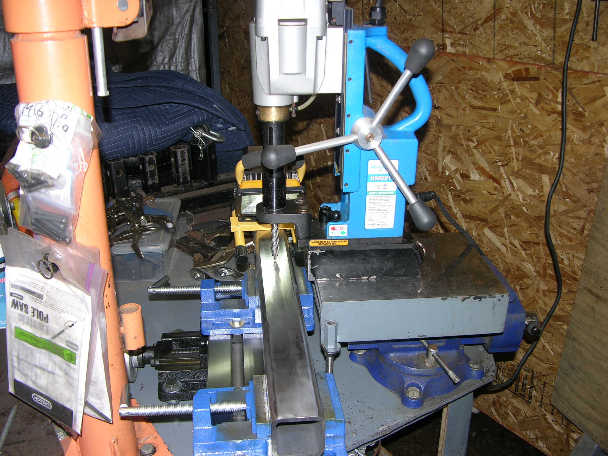

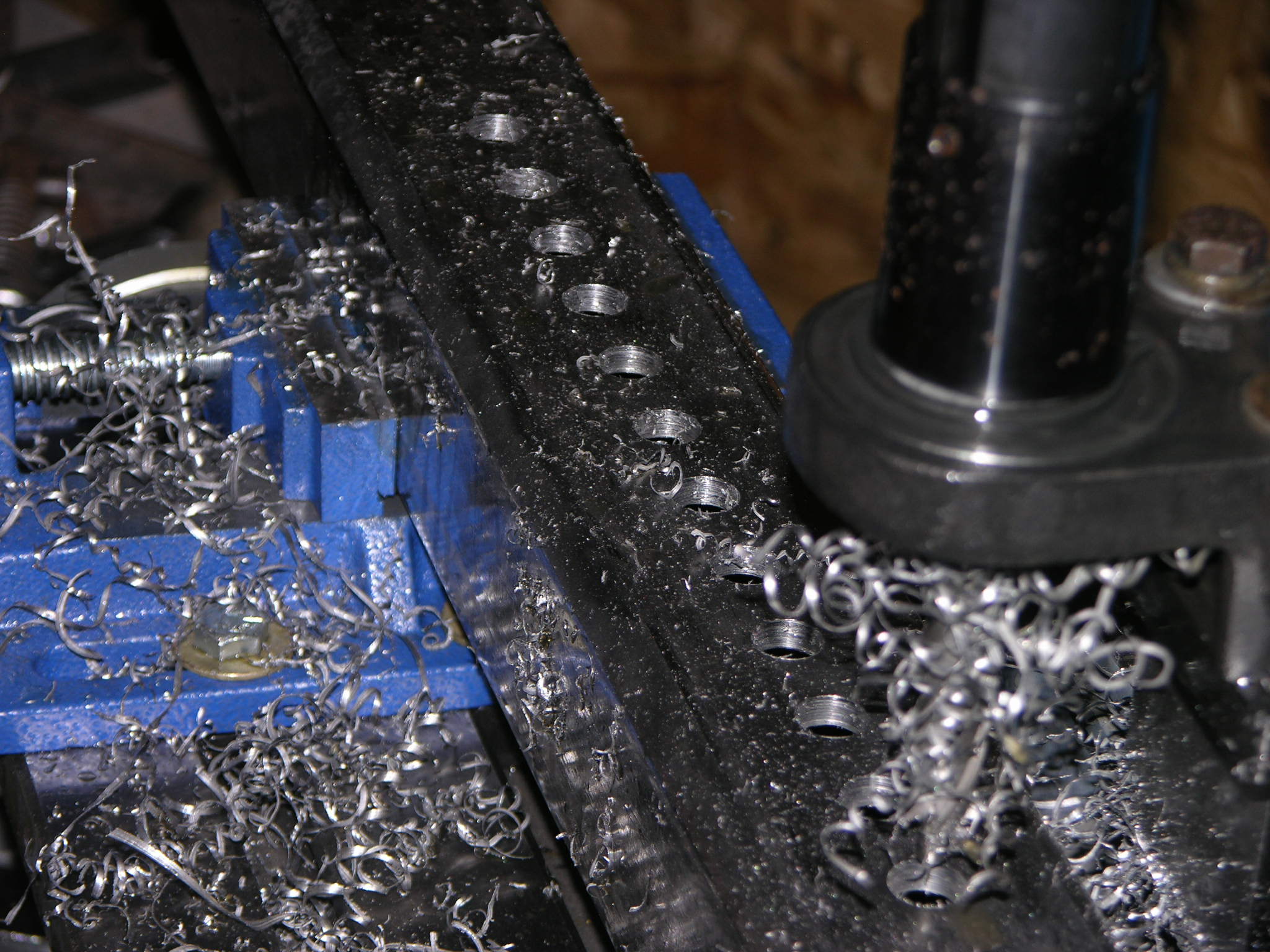

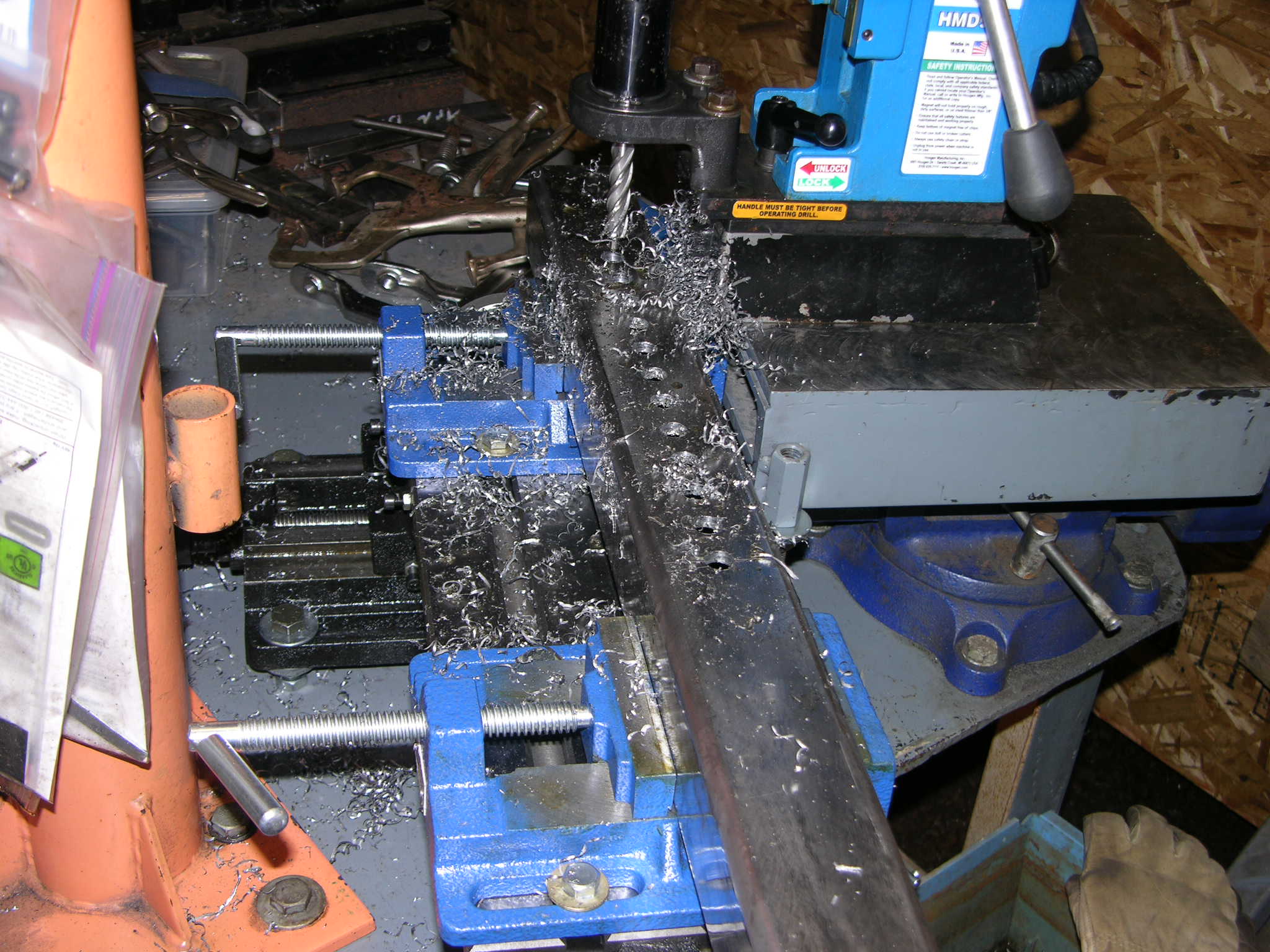

"Do the ones in your link fit a regular 3 jaw drill chuck?"
Nope, sorry; those and the majority of annular cutters use the (for mag drills, anyway) "standard" Weldon chuck, 3/4" diameter with two flats/set screws - it's a more rigid mount, and deep annular cutters do NOT like side-loading - they tend to shatter with too much wobble. This
G&J Hall Tools 18Y17 Powerbor Weldon Chuck Adaptor, 1/2"-2 UN Thread Fitting, 3/4" Arbor, For All Electromagnetic Drilling Systems: Drill Press Accessories: Amazon.com: Home Improvement
is what the cutter shanks look like, the female of that is the norm for most mag drills.
Your loaner drill sounds like it has the (normally extra cost) 3-jaw chuck on it, might wanna ask if the Weldon mount is available for it if you're interested - maybe if the owner has that he'd be interested in gaining a cutter for the use of it. If there's TOO much "monkey-motion" involved tho, it might not be worth it to either of you :confused:
Sorry if I seem to be pushing spendy stuff, I just got hooked after trying too long to drill too big holes with hand drills - so far, my mag drill has its own "drilling station" I built, capable of drilling a 1-1/2" hole in a 2" square block of steel if I needed to. It'll also drill evenly spaced holes (has its own x-y table) over 12" distance per setup, drill exactly centered holes in square tube up to 3", and probably a dozen other things I've yet to dream up for it (including eventually building a line bore setup to re-bush parts of my backhoe) - at this time I've picked up cutters from 1/2" up to 1-1/2", including a few metrics; all in 2" depth of cut.
View attachment 573138View attachment 573139View attachment 573140View attachment 573141View attachment 573142View attachment 573143View attachment 573144View attachment 573145

This is mainly for HJCtractor - Sorry I missed your question on the mag drill table - the following link should answer your question (earlier in this thread)
If not, let me know... Steve
