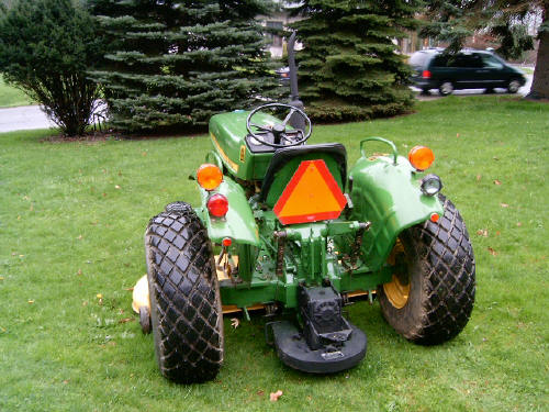

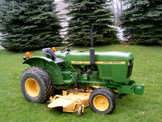

Not always Greg, maybe you better check the one out on my 1978 JD 850.
Its a rear PTO driven 272 JD MMM.

The mower is run by a gear box off the rear PTO with a large pully. A belt from the pully runs the mower.
The mower is lower/lifted by cables running from the 3 point lift arms.

Looks just like my YM240. It had what was labeled a YQM-60 MMM, but it would fit under just about any 2wd in the 18-40 hp range, as long as it had a Cat 1 TPH and a 1-3/8" PTO spline
Anyway, your follow-up post pretty much describes MOST rear PTO driven mid mound mowers. I'm bettin' your 272 JD MMM would fit my old Yanmar just fine. I'd even go so far as to consider yours as a "universal"

Yup. Does that model require the lower lift arms to be removed, or was that done for some other reason? Mine hooked straight to the TPH as-is like any other implement. Removal was a breeze; drop the hydraulics, disconnect TPH/PTO shaft/chains, remove gauge wheels, then drive the tractor off - right over the top of the mower deck (that's why the gauge wheels had to be removed). Without a helper, it was about a 10 minute job to remove, 20 minutes to put back on.

The top link and lower lift arms need to be removed. The gear box bolted on, cable pulleys bolt under the rear axle (where the lower lift arms bolted on).
Removal/install can each be a 1 hour job so I rarely take it off.
