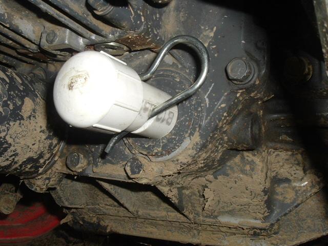

Could someone tell me where to get a cover for the midmount pto shaft on a BX2200? I'd like to keep it clean when I don't have the mm mower installed and the dealer doesn't have a listing for one. Thanks and <font color="red"> Happy <font color="green"> Holidays !

I couldn't find one either so made one out of PVC and a large pin. Will try to find the link with specs.

Here's a link to a thread about a MMM PTO cover and there are measurements and pics of the one I use, hope it's helpful. Link The first Pic is of the skid plate, the PTO cover is further down in the thread.
/ MM PTO shaft cover
Thanks a lot Milkman! I'm off to the hardware store first thing tomorrow. /forums/images/graemlins/smile.gif
