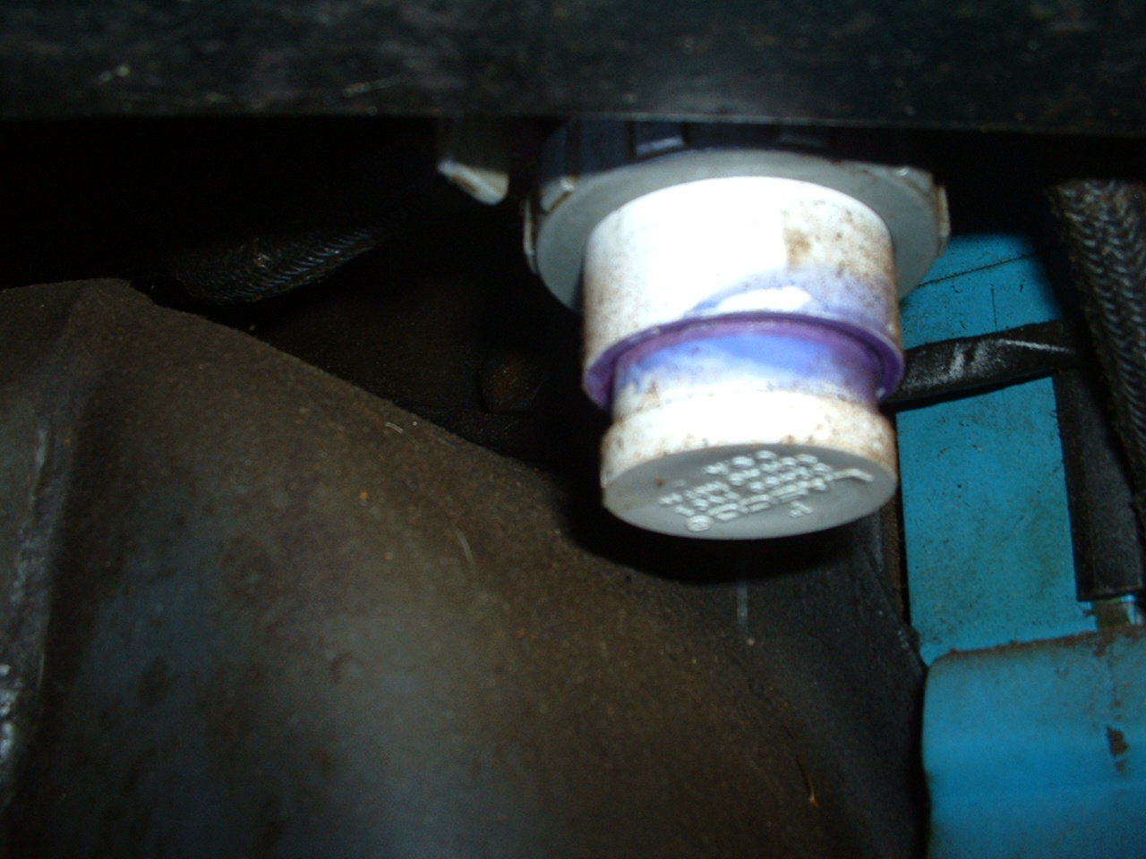

/ Mitsubishi MT180D w/loader #7
Great tractor indeed. I assume you are looking for the filter that goes in the fuel bowl. Not sure why that particular filter seems hard to find but apparently it is unusually sized and wasn't used in many Mitsubishi models....doesn't appear to be available from Case IH either ( would think a filter from a 245 would probably match) . I am sure they are out there but can't tell you who has it. You can just use an inline filter available at any auto or farm supply store.
/ Mitsubishi MT180D w/loader #8
I have found a replacement by purolator also NAPA however for an odd reason my plastic bowl shrunk and they no longer fit in.
My solution is to keep the bowl as a simple separator and I simply use an inline filter between the bowl and the injector pump.
Works fine that way.
My intention is to drill a hole in the bottom and add a petcock to drain away any crap and water that might show up.
I did try to locate a new bowl but only found a longer version that will not clear the bell housing
/ Mitsubishi MT180D w/loader #9
I made a short bowl using pvc fittings from Lowes. Then I put in an in line filter. Can't remember which fittings I used. I know I had to trim one down to make a flange DSCF0022.JPG
It's worked for me for a couple of years now.
BenQ
/ Mitsubishi MT180D w/loader #10
I made a short bowl using pvc fittings from Lowes. Then I put in an in line filter. Can't remember which fittings I used. I know I had to trim one down to make a flangeView attachment 341999
BenQ
Good solution, thanks.
In my case I still have the shrunken bowl, it just will not accept filters.
Inline filters serves me well.

Yep mine was also a bad seal but a fatter O-ring fixed that issue.
Our posts re bowls got me into action.
I cut the longer new bowl that I had obtained from a Kubota dealer, machined an insert to adjust to length and tapped 1/4" pipe thread to allow me to fit a ball valve to drain off water and crud that I would see in the bowl. This way my inline filter only needs to handle minute particles.
Over time I always find some water in the bowl that I guess is from condensation as I always double filter my fuel when filling up.
Tomorrow I change over to the new drain bowl, install new inline filter and oil change for the upcoming snow season.
