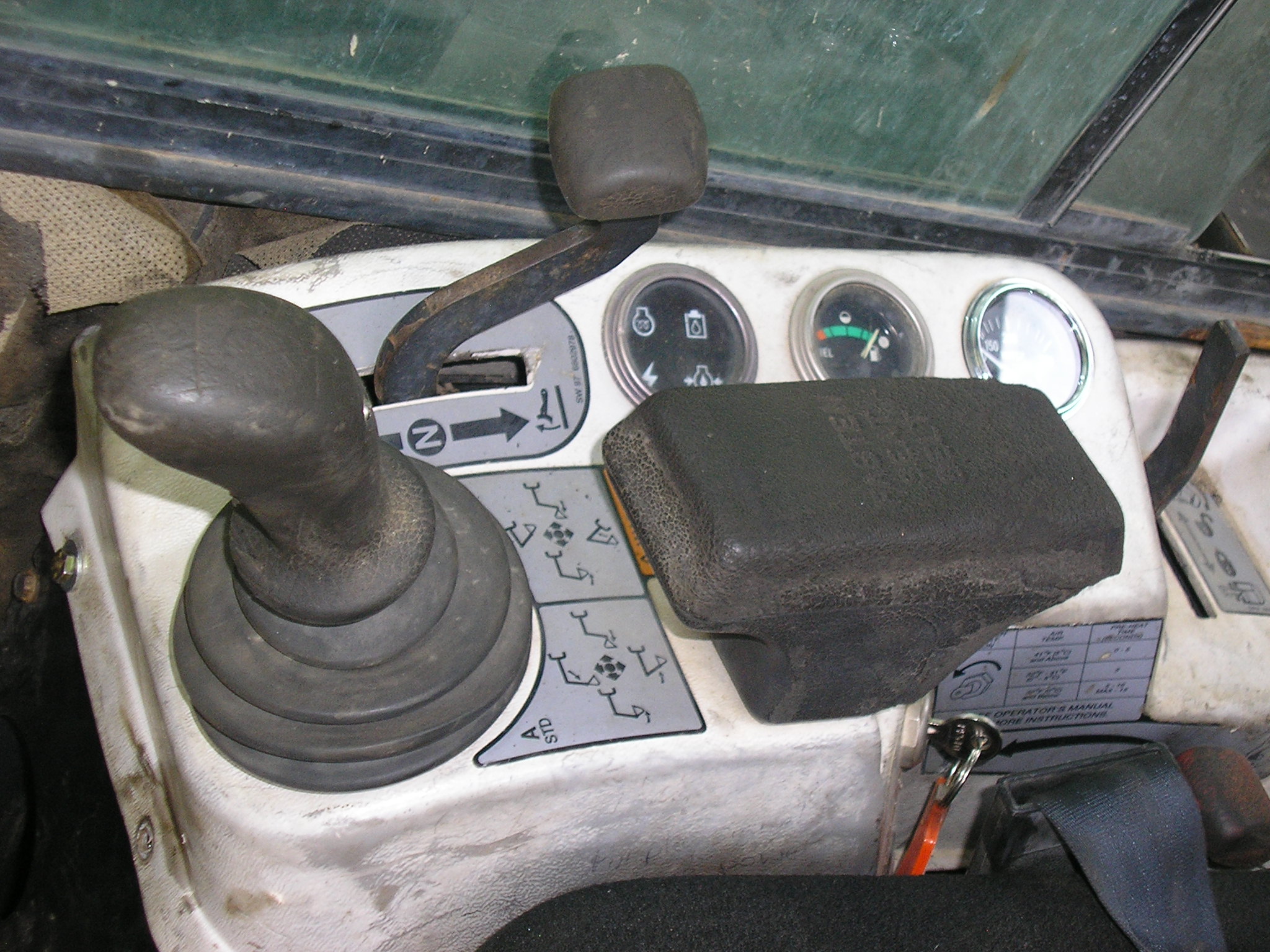

It is possible they changed the panel a few machines prior to adding the valve. Also possible the valve developed internal leakage (some history of that) and owner just removed and connected the pilot pressure hoses together for the control pattern desired. Does it look like there may have been bolts in those 2 holes adjacent to the slot? if so the valve was removed. You could also take a look behind the panel and see if the hoses to right and joystick are one piece from handle to control valve or if there are JIC connections in that area. If one no extra hose connections and/or signs of bolt on the paint then it is prior to selector valve.
I'd hate to say for certain, but I did not see any obvious signs of bolts having been in those holes. Like damaged paint, where the head, or a washer, had been. It's been a while since I had the joysticks out, where I could see the connections, but I think they are one line from stick to blocks, below the floor. So, it looks like mine is earlier than -7113.
Which leads to another question. Maybe I should start another thread for this one, but I suspect it's been mentioned, before. Does that selector valve do anything other than change the controls? I tried changing the hoses, under the floor, which put the controls the way I want them, but it caused other problems. One was, the dipper would barely move inward, unless the boom stick was also opened, slightly. I put the hoses back, and the problems went away. So, I'm thinking that valve must do more, than just switching the controls.

No, that valve simply changes flow from both joysticks to the dipper and boom depending on control selection. 4 hoses feed into it from joysticks and 4 hoses out to the 2 control valve spools.

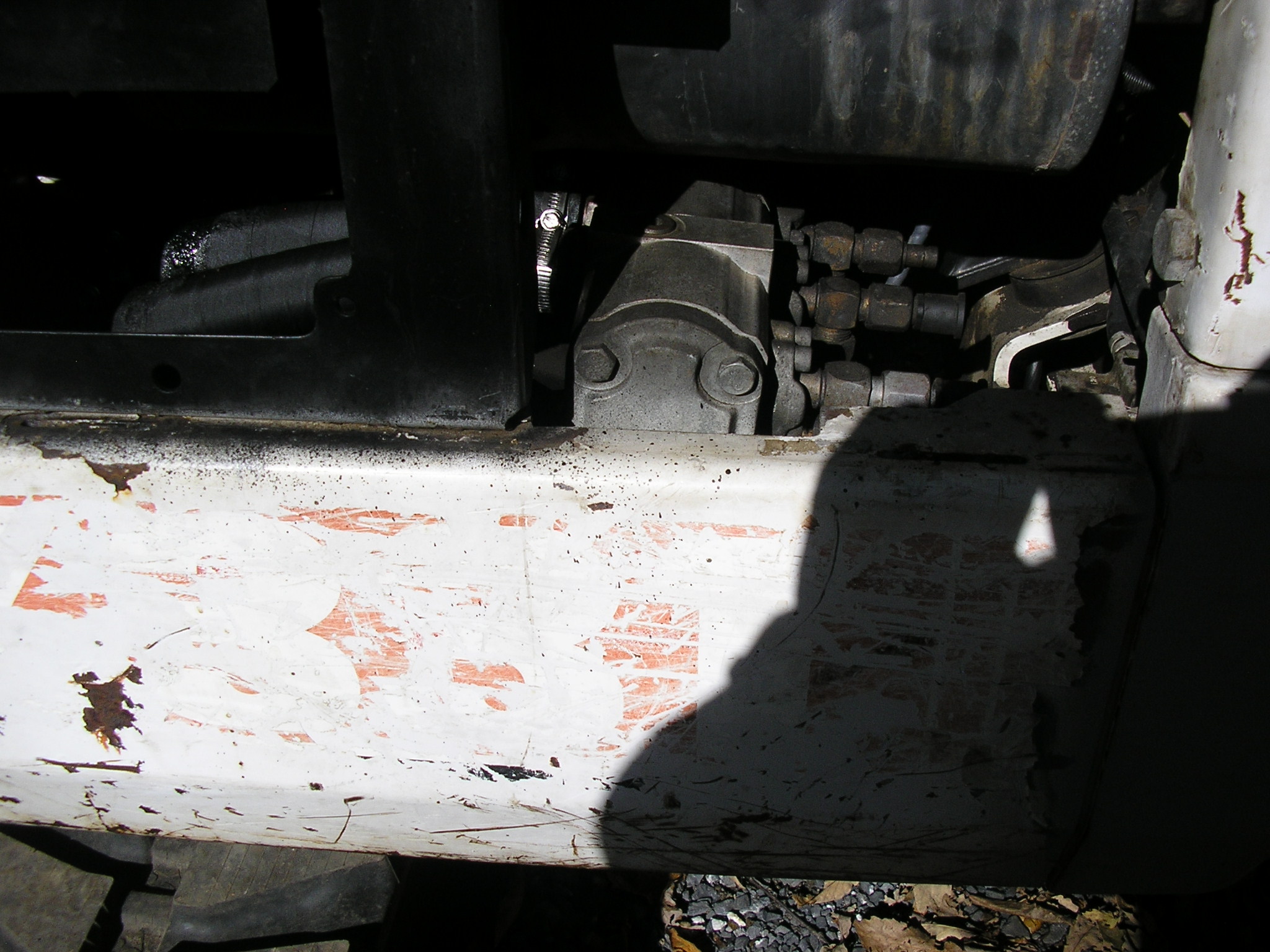

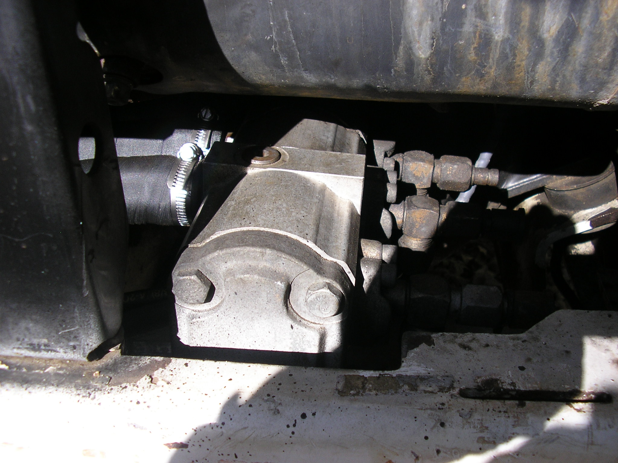

I have been in touch with Bobcat and was told they could figure it out, if I could give them numbers off either drive motor, the right pump, or the main valve. I gave her numbers off both motors and the only number I could find on a pump. She was unable to tell me anything from them. The left motor was a replacement, so that didn't surprise me, but I'm pretty sure the right one is original. My last hope is the main valve. I have no idea what that is. Or, where to find it. Do you?
/ Missing Serial Number #27
Surprised she didn't ask for engine s/n because the machine and engine serial number are the 2 numbers recorded on the original delivery report. The other numbers are listed in the production build sheet but required more data searching than just Delivery report by engine serial number.

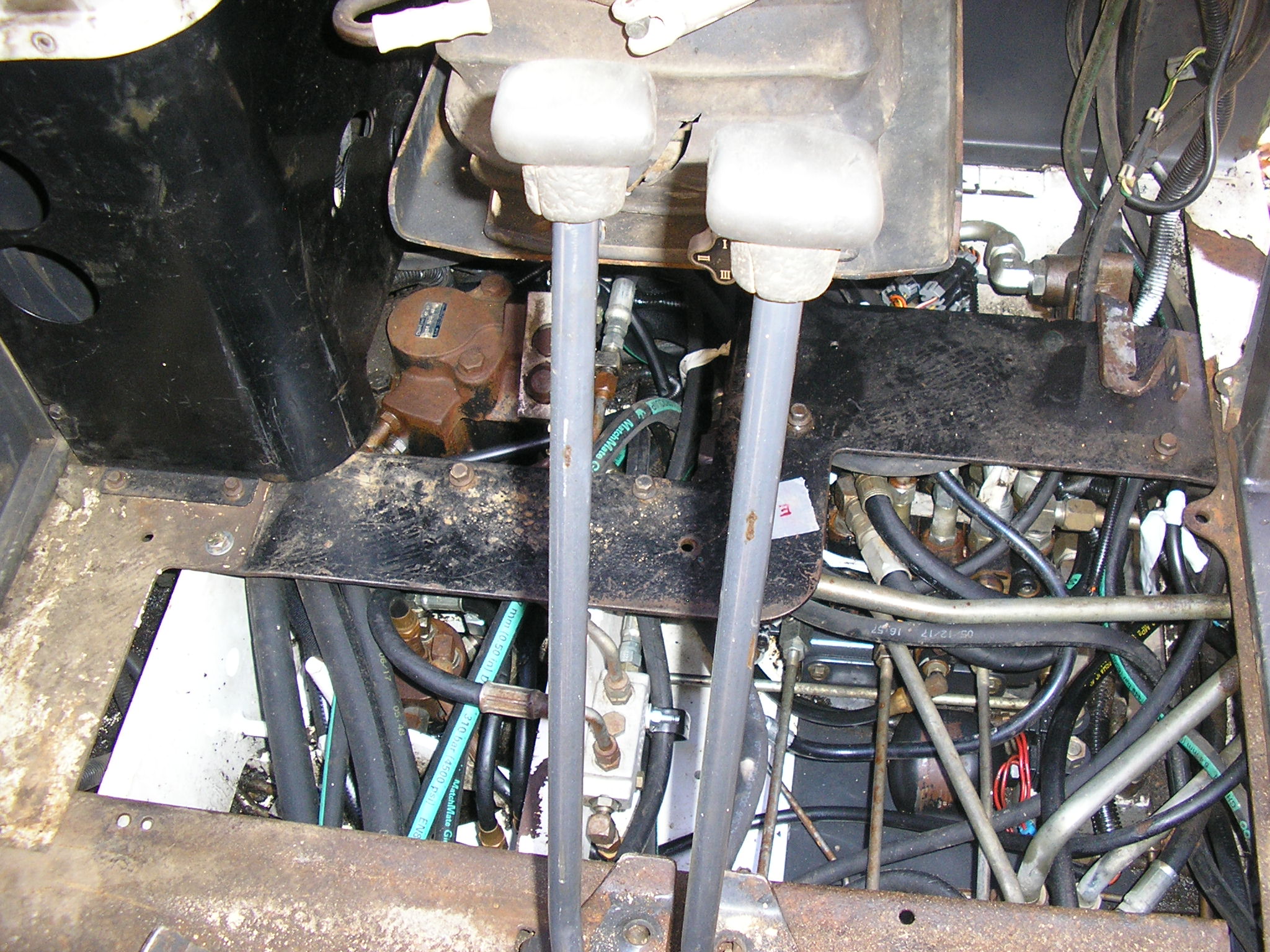

SSdoxie, I may have stumbled onto the answer to one of my previous questions. I found one of your messages from several years ago, where you explained how to switch the controls. What you described, is not the hoses I switched. I believe I got the ones next to the right drive (boom, I think), but when I traced the dipper hoses, they went to another block, under my left foot. In the photo, it's the one with white tape around it. It might be easier to spot the green markings on it. Could that be what caused the other issues I mentioned in a previous post, even though it did switch the controls, as I wanted? Now, if I can remember how to post a photo. Top of photo is toward front of machine.

Sorry I haven't been here for awhile. It has been too many years and far too many design changes for me to remember which functions were in which control valves. Olst access to all online schematics when retired.
