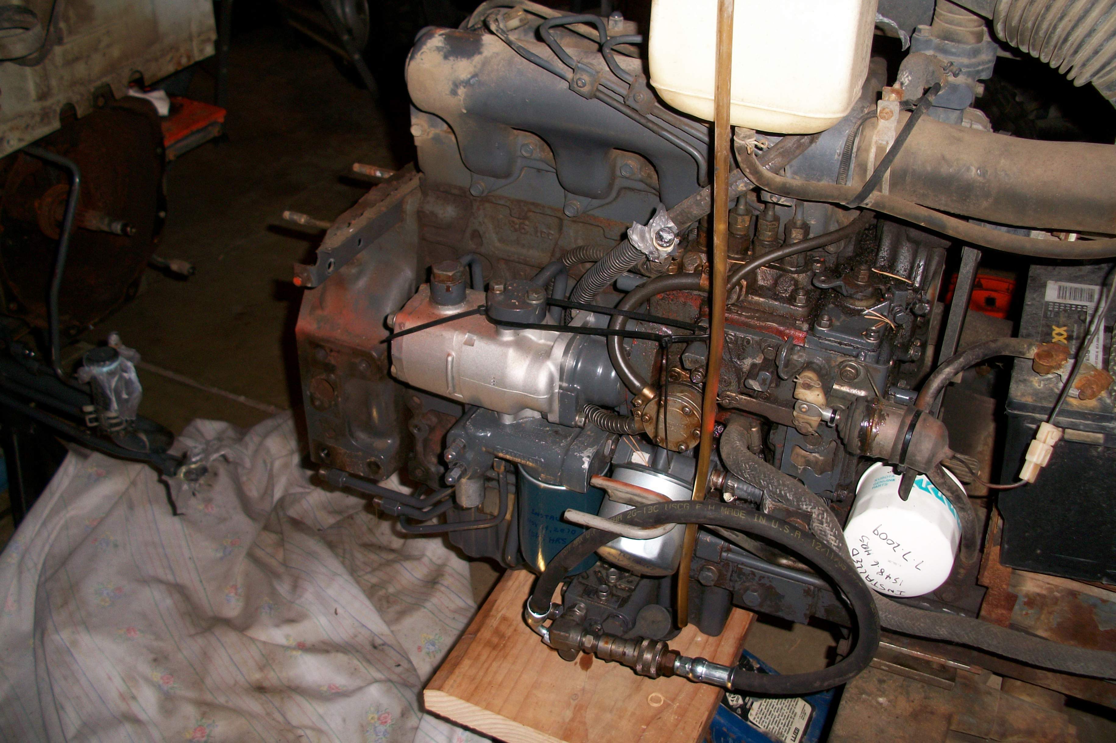

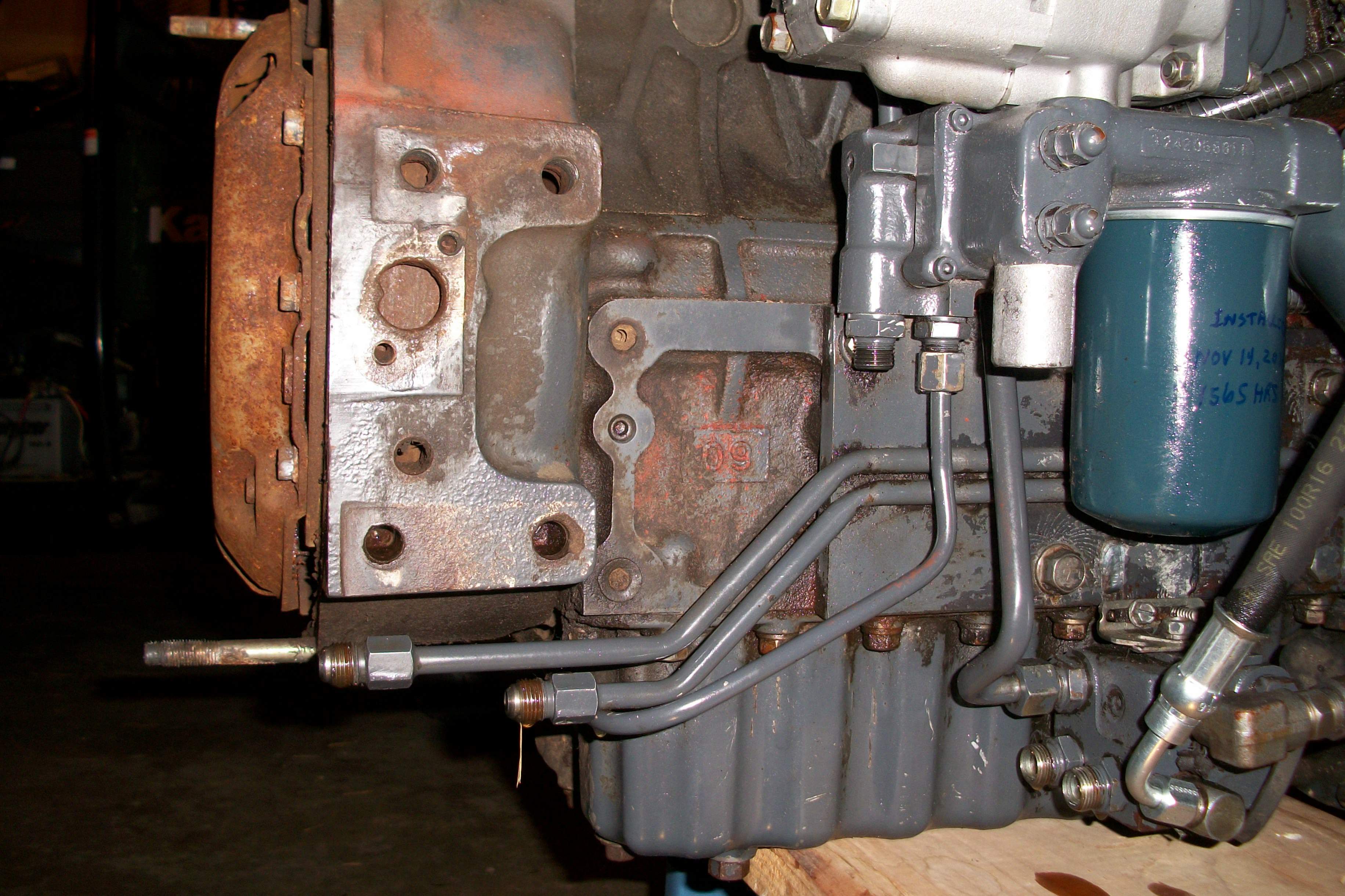

Thought I would share some pics of splitting my tractor for clutch replacement. Hope they help someone else doing similar job.
These were taken as I was removing old clutch.

From the looks of the rust, I'd say you have a tractor with special needs! Left out in the weather, submerged or just not used? Good luck, though it appears you are on top of it.

Here are a few more pics. This is second tractor split I have done. The other was a JD1050.
Not a hard job.
1. Shop Manual
2. Two large floor hydraulic jacks (one could be replaced with cherry picker)
3. Three stationary floor jacks
4. Smooth concrete surface to move tractor apart while on large floor jack or cherry picker
5. Clutch plate alignment tool (Harbor Freight $10)
6. Patience.
I kept the rear portion of tractor stationary and rolled the front away while it was on the hydraulic floor jack. Two stationary jacks were placed (on each side) under the wooden board as I inched the front away. The stationary jack heights were set so the board had about 1/4" clearance. I did this as a precaution in case the hydraulic floor jack had issues.

Looks like you have a new hyd. pump? What horsepower is this? I see 4 cylinders..Looks like over 1600 hours on the clutch? It appears to be single stage too?Jy

Was that a guess on the hours or did you read it off my filter? Actual hours on tractor is 1568. I think this is probably first time clutch has been replaced.
Not sure if the hydraulic pump is new. It is made out of aluminum so probably why it looks newer. Is the pump normally painted with the engine? The starter is the same (looks new) as this pump.

Actually you take clear photos...I guess you just bought yours too? That pump appears to be new> I did not know your model, I just bought an 2003 L3000dt a couple months ago, it is 32 hp 3# cyl. I have 750 hrs and was concerned about the clutch too on it.It is supposed to be 2 stage type on it. I cannot adjust or check the clutch until I disconnect the side loader support? Not going for that soon though.Jy.

The clutch rusted together after not being in use for over 3 months. Guess that's not a surprise. What is surprising to me is that with all the rust and crud in and around the clutch, it didn't make any unusual noises. Even the throw out bearing spun good and didn't make noise.
I replaced everything but surprised at how quiet it ran before it froze up.

I tired to break it loose but no luck. By the time I took it apart and really examined the clutch and clutch plate, it was clear it wasn't ever going to break loose.
In my case the clutch plate was stuck to the clutch pressure plate. The clutch plate was completely free from flywheel. You can see in one of the pictures the clutch plate is still stuck to the clutch pressure plate.
When I forced them apart, the clutch plate pretty much disintegrated on side stuck to pressure plate. It was nasty.
If somehow the clutch plate had been able to break loose, I'm positive the clutch plate would have just fallen apart.
