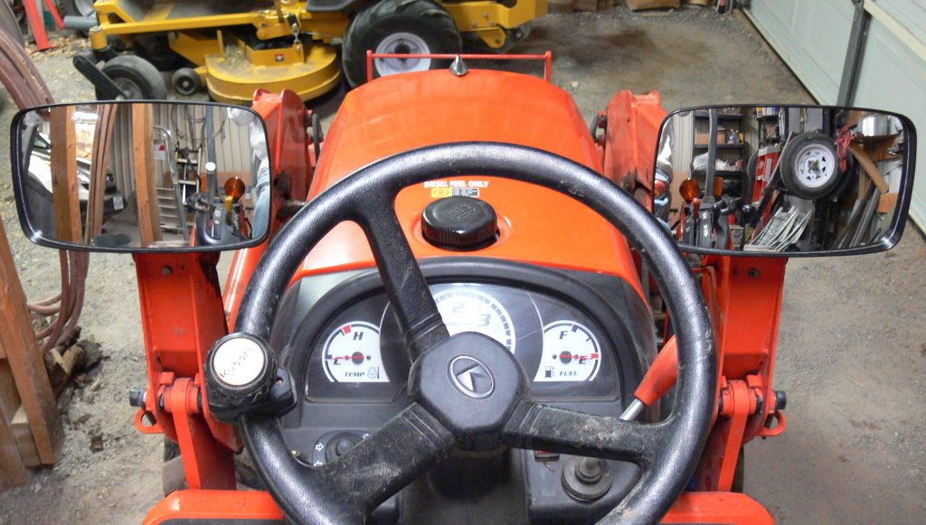

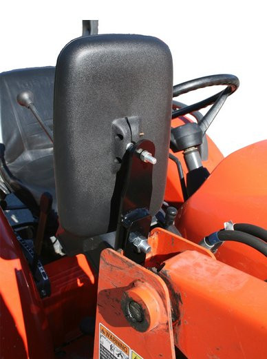

As I get older, my neck doesn't appreciate being turned a bunch to see behind me. I ordered these yesterday because of the way they mount & the size of the mirrors that don't add significantly to the width of the tractor.
Loader Mirror Kit (Right Side)

Thanks for the link. Those would be helpful with rear snowblower.

Those look nice, I like the size! I put 5" round ones on my loader masts and find they are a tad to small, will upgrade to something like you are getting after I break them off.

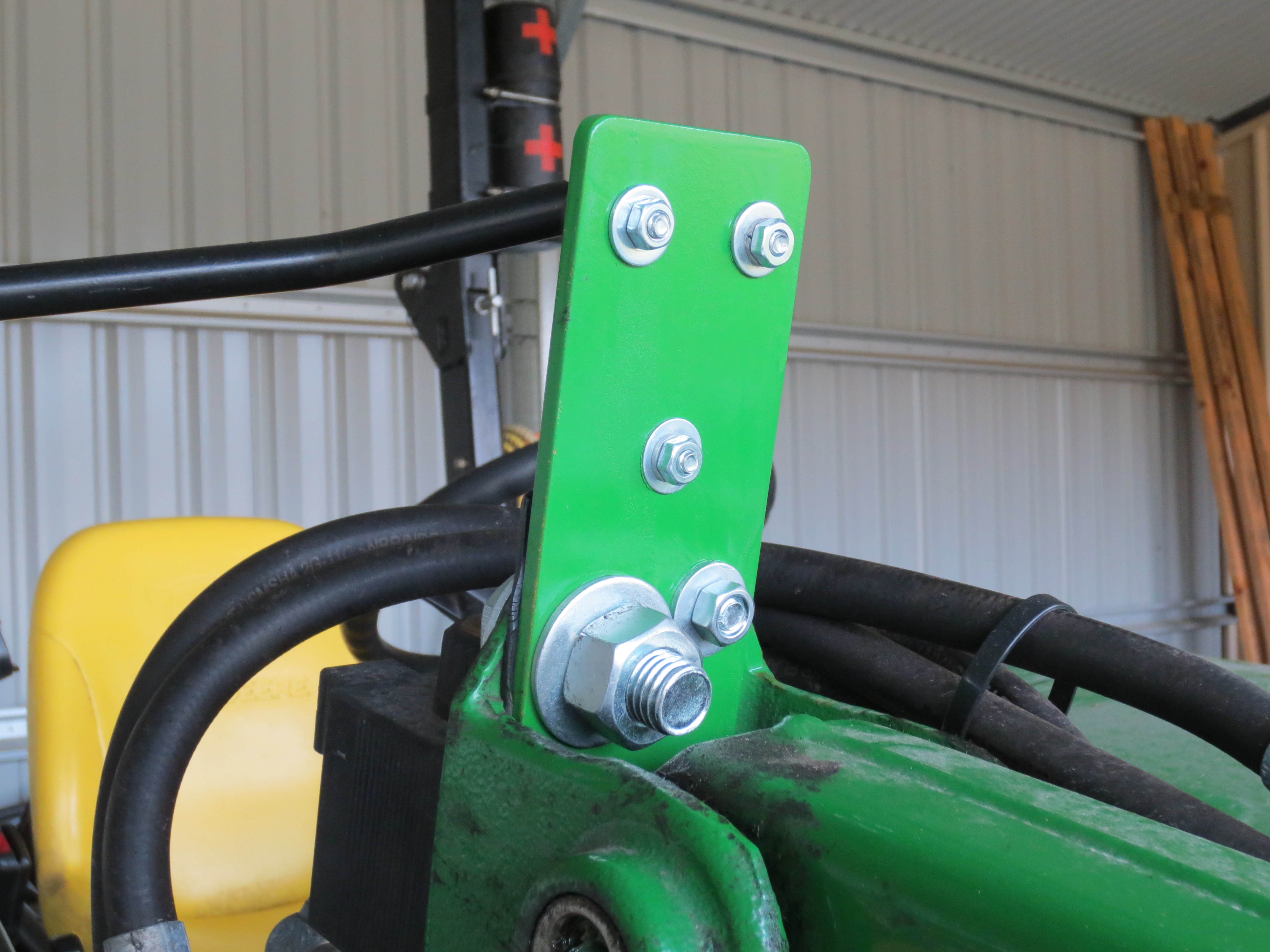

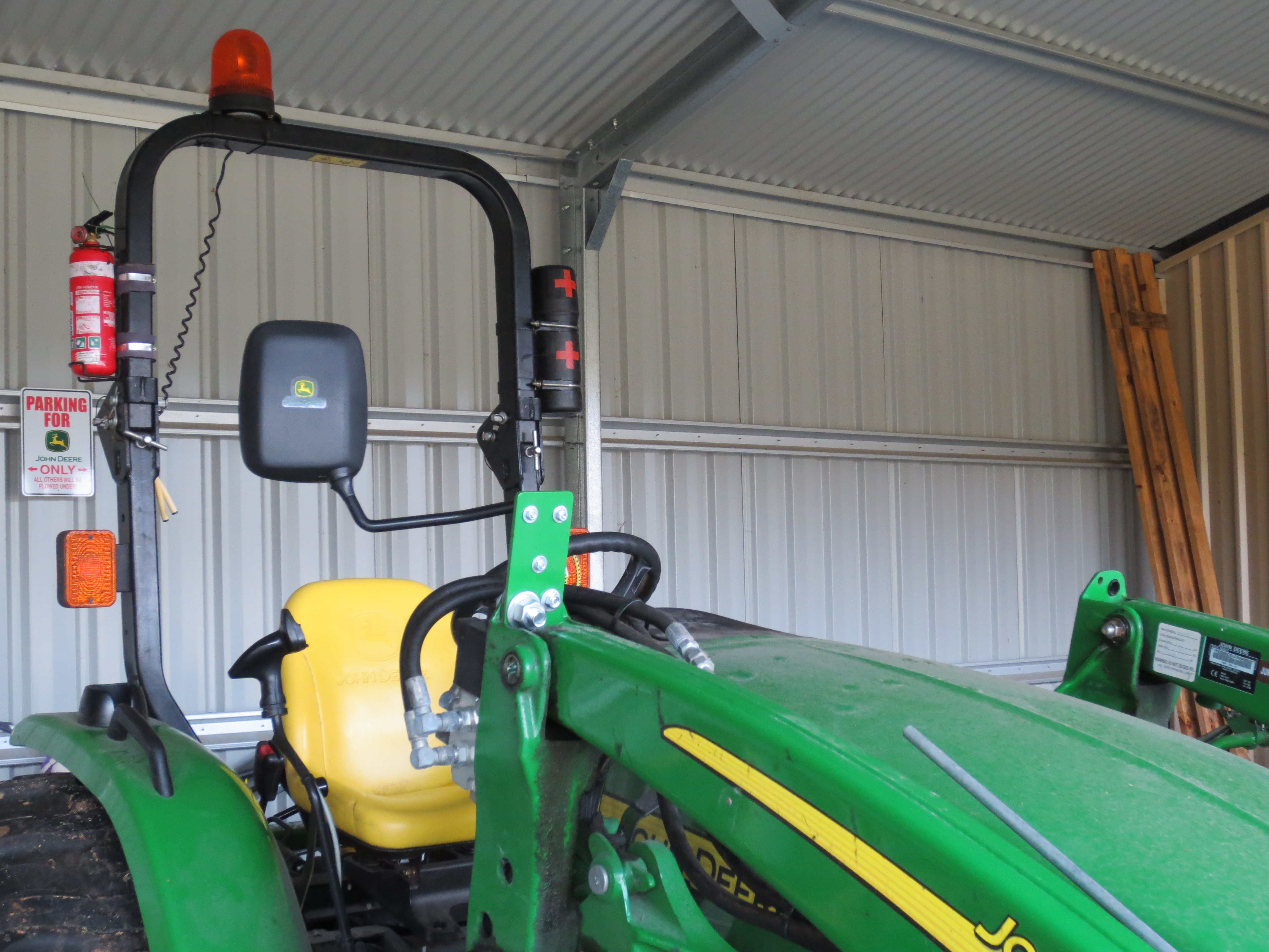

Nice find Locoweed. When I was looking for a side mirror I guess that I couldn't come up with the right combination of words to search & come up with that result.
I eventually found a mirror (at my local auto parts shop) that I thought would fit the bill. I had to get a local fabrication shop to make the bracket... yours is all-in-one! :thumbsup:

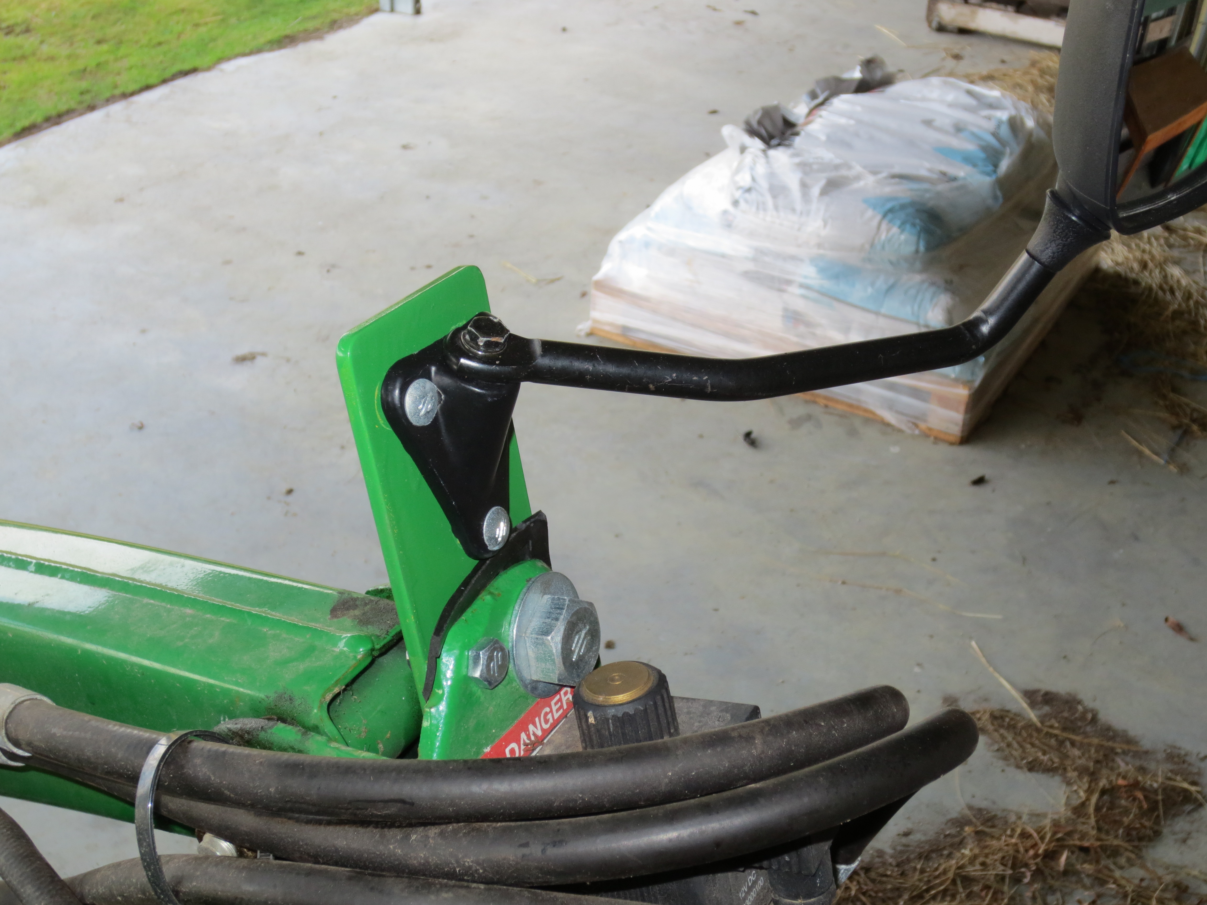

Here is what it looks like. I had to change the mount. Since I have a small tractor, there wasn't enough room to get access to the grease zerk with the stock mount. So I cut off the pinch part & drilled a couple of holes & tapped it for 1/4x20.

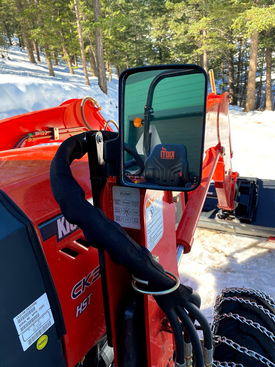

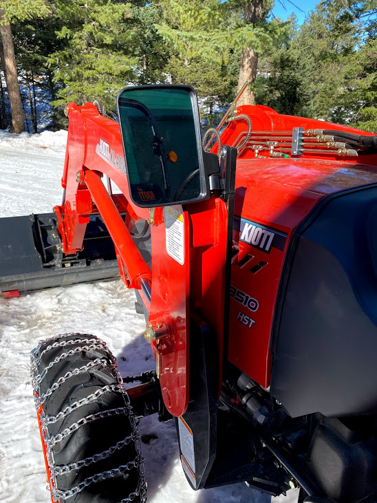

I found a really cheap pair of 5"x7" golf cart mirrors on eBay that turned out be not totally crappy. For $15/pair, you won't have to cry too long if you knock one off and drive over it. HERE is the eBay link.
I attached the mirrors to the FEL frame on my Kioti CK3510H using H-F tool holder magnetic strips. They seem to hold on well and don't vibrate much. It is nice to sidestep the issue of making holes in your tractor for an accessory. I used one bolt and a zip tie to attach the mirror to the magnet strip. As can be expected, the hardware that came with the mirrors is complete garbage. Do yourself a favor and just throw it out.
These mirrors are smaller than most sold by tractor makers but they are big enough to be useful and maybe less likely to get caught on this-n-that while you're working.

That setup looks good, I will check these mirrors out.
