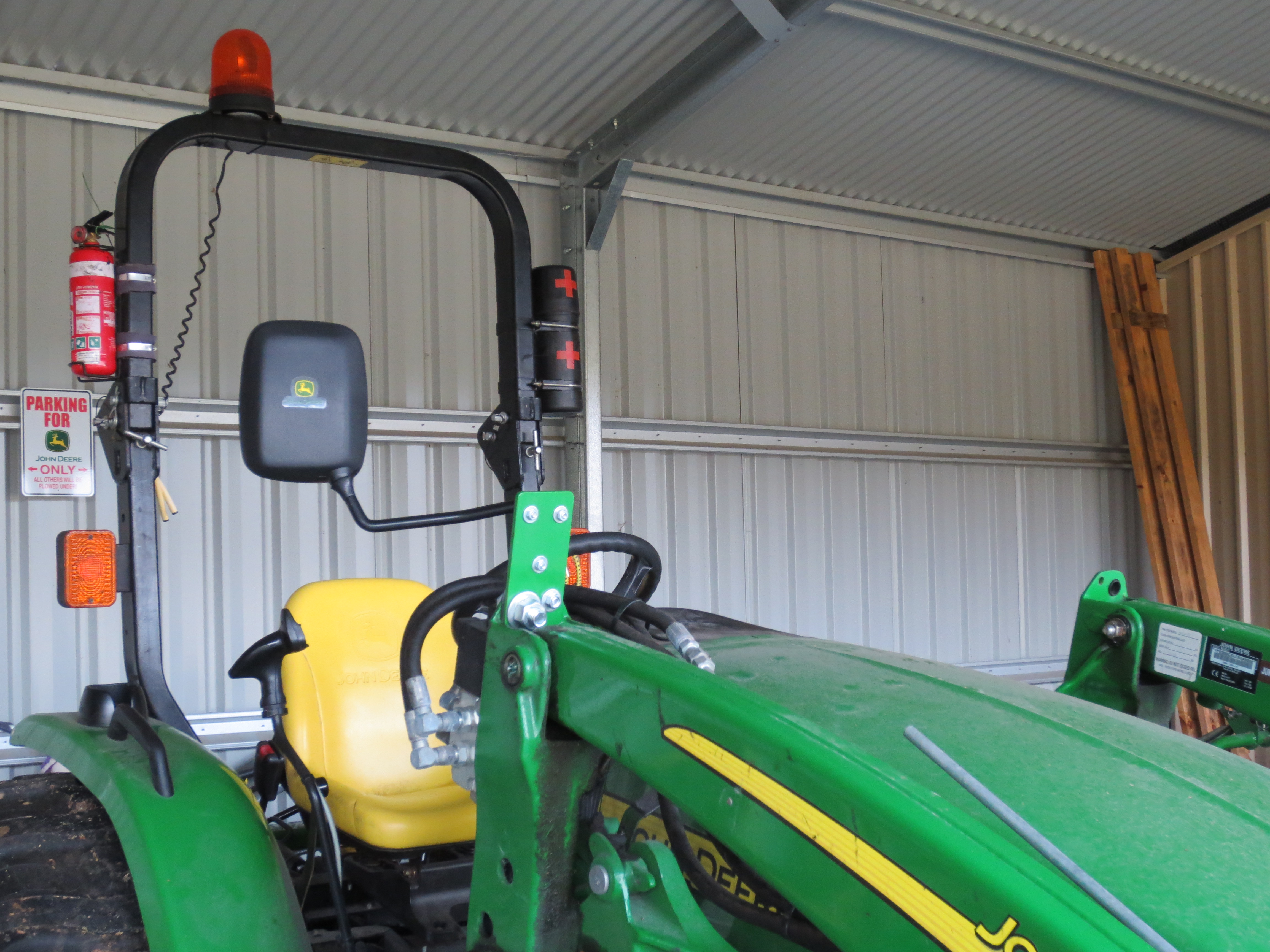

I have 2 M9000's , one with a cab and an open station. The cab tractor has mirrors (obviously), the open station don't I had to back my NH BR round baler into the barn this afternoon and park it in it's parking place. Not thinking about it much, I hooked the baler up to the open station M9 instead of the cab M9. All was good until I went to back in the barn and realized I cannot see to back up. Not good. Additionally, when roading (my fields are in remote from the farm locations), it's impossible to see if I have any vehicles behind me without turning around physically.
My question is, does anyone make a mirror kit for an open station tractor, don't care what the make is, I can adapt about anything.

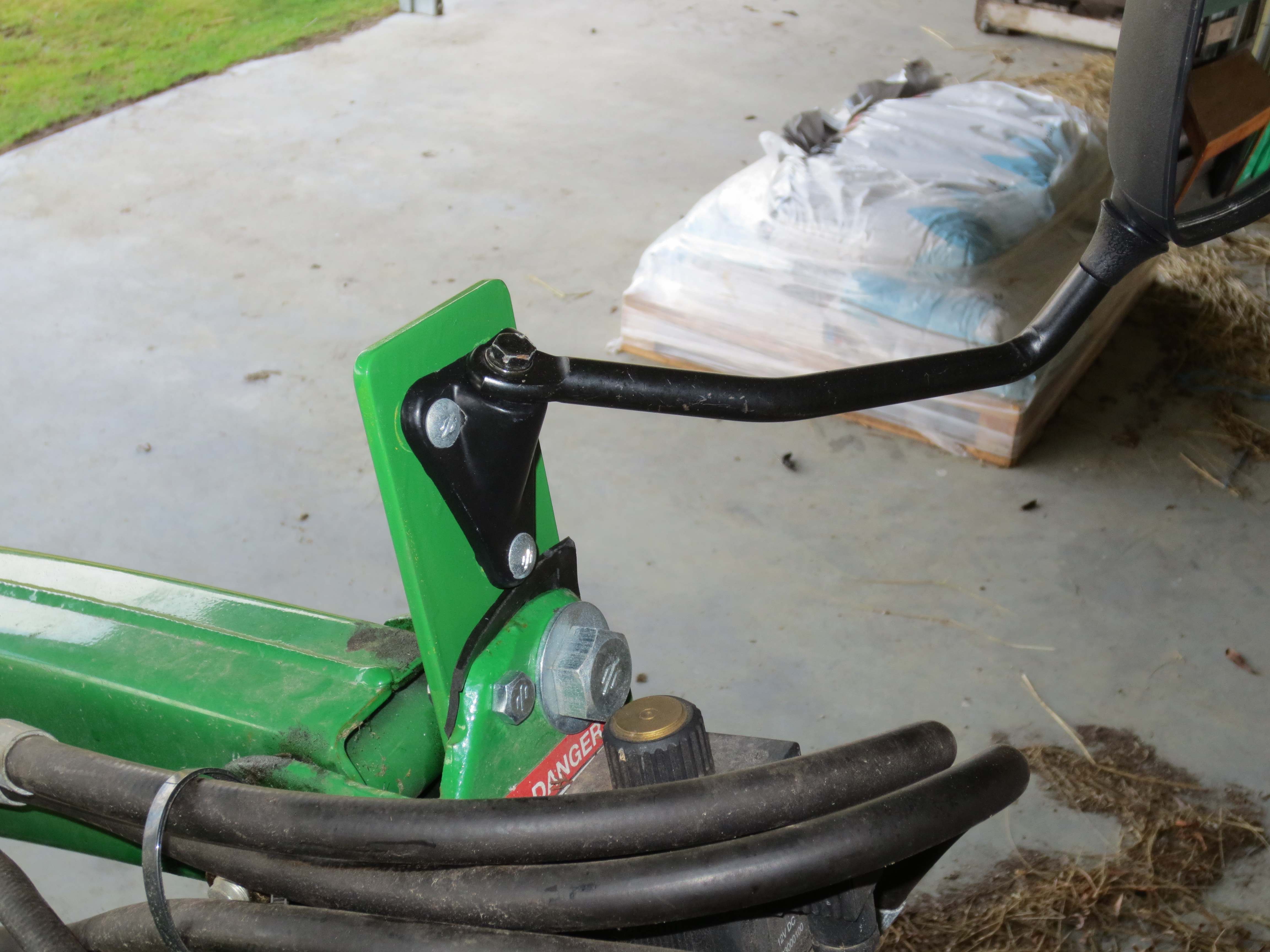

For an open station tractor, OEM ROPS fitted mirrors are an expensive option.
My observation of TBN threads, and what I did myself, is to mount a rear-view mirror off of the top of the FEL 'post'. A mirror (or 2) can be found easily at an auto-parts shop and I found that the one for a van worked best. Depending on the FEL post, you can have a mounting bracket knocked up at a metal fabrication shop after supplying them with a template... that's what I did and, after priming & painting (plus a wee decal that I had in my shop), it looks OEM.
My single mirror is mounted on the right FEL post because I drive on the left side of the road when 'off property'.

Not a bad alternative. I have about the same post setup as you do, just bigger and higher up. Only need a right hand mirror anyway. In as much as I own a fab shop, I can have an employee 'knock one up' no issue. I was thinking there was something along the factory lines that might work. Most owners don't need a mirror but in my case, I do.

I forgot to mention that I also cut up a rubber mat to make anti-vibration gaskets for where the mounting bracket meets the FEL and where the mirror arm meets the bracket.
Absolutely no vibration = clear image.

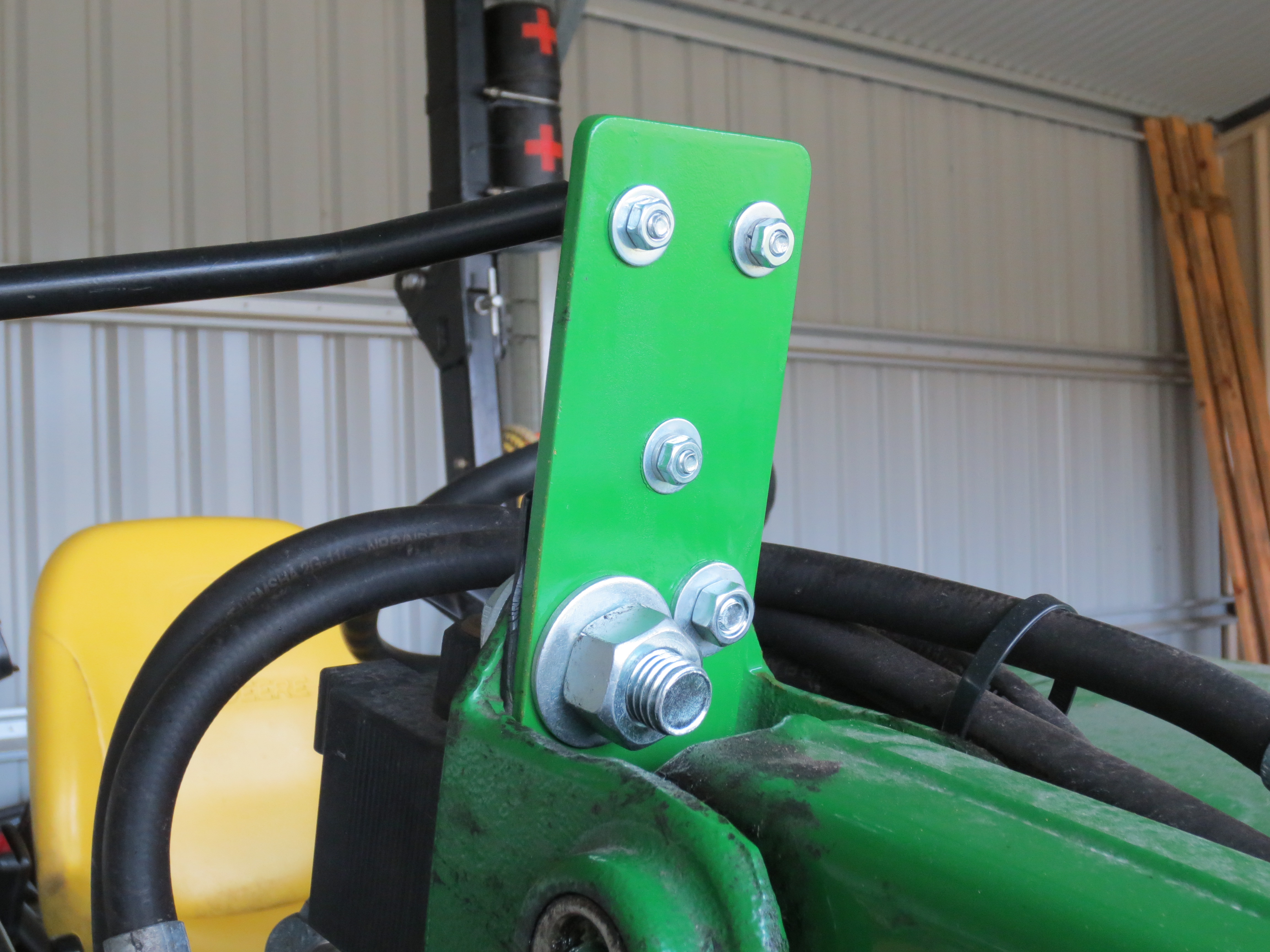

Beautiful setup, mirrors, lights, first aid, fire extinguisher and all; (even if the tractor is green). Just curious though, why the two different size attachment bolts (one large and one smaller one)?

There are pre-existing holes at the top of the FEL posts and those were the sizes... if you look at the last photo you can see the left-hand post with the two holes. One of them is 'black' as there is a plastic insert (for some reason). I believe that the existing holes are there for craning/hoisting the FEL around during OEM manufacturing/assembling. :)
