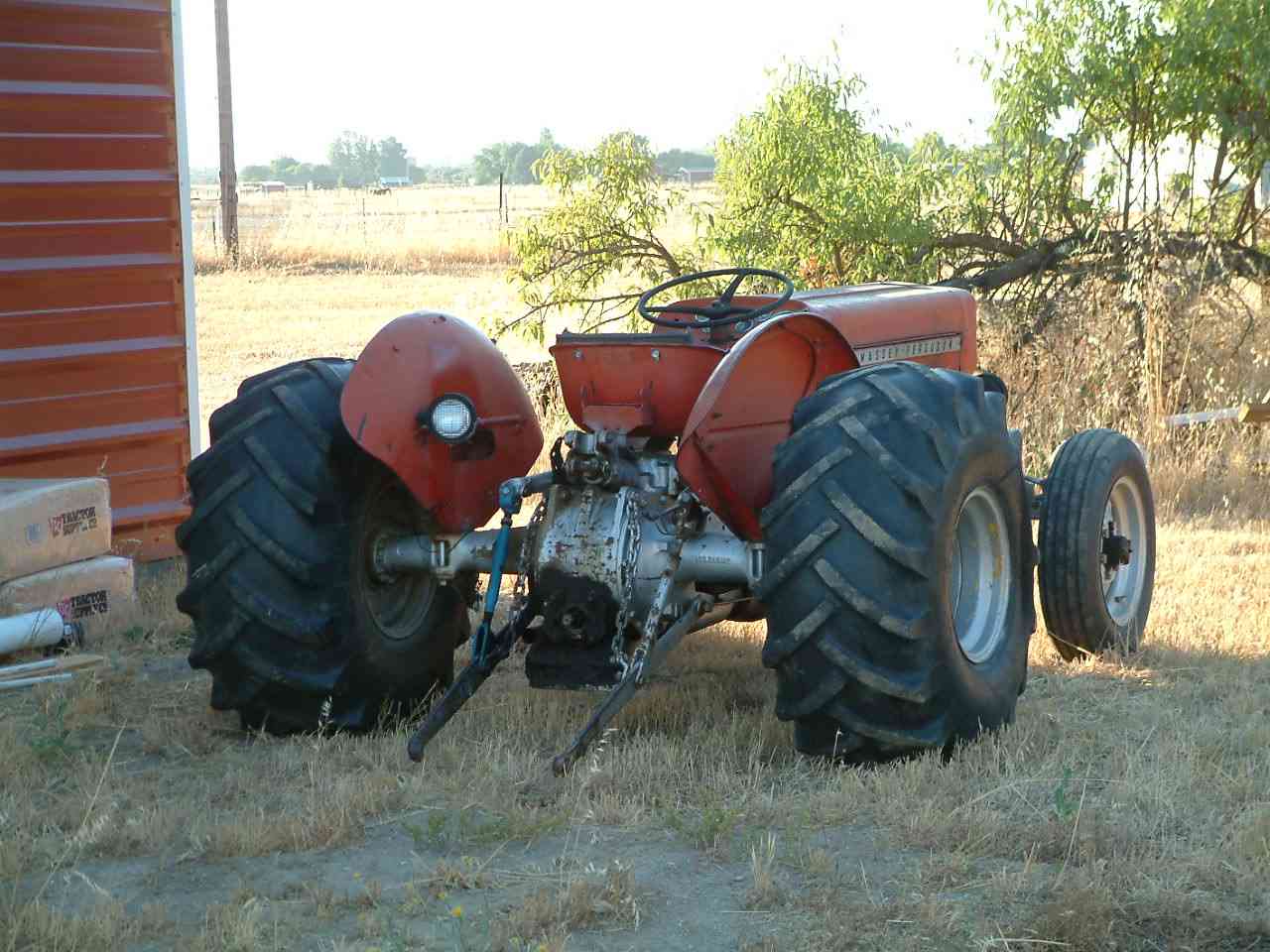

My old 1964 MF-135 diesel (45 hp engine, 37 hp pto) weighs about 3500 lb and the 3pt hitch can lift 2850 lb. I paid $3600 for it in Jul06.
There are numerous used tractors this size (JD, Farmall, Ford, etc) that would fit your budget. Check eBay, craigslist and local ads. You'll soon find something that will work for you.
